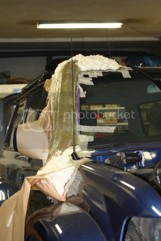

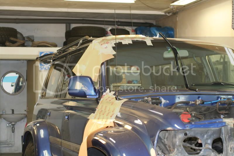

Today (after finishing everything I can do on my engine rebuild instead of sitting down to wait for the head back from the machine shop) I started the snorkel building ;)
First I waxed the top and the fender, and then without wiping the wax off I taped it off with painters tape and then some regular plastic tape.
Then I laid the first layer of fiberglass over the tape. When dried out I covered the a-pillar with tape and some foam from a old isolating camping mattress to lift the fiberglass from the pillar to allow water to escape the windshield. Then I laid a fiberglass layer between the glass on the fender and the top.
In the back I´m rising the fiberglass (about an inch) from the roof to avoid filling the snorkel with water from the roof when braking. I´m going to turn the air intake backwards to avoid catching rain and splashing water from the tires.
When I stopped this evening I had two layers covering the area from the top to the fender. My plan is that this will be the base for me to build the rest on.
I probably cant get back to work on my engine until Thursday or Wednesday so I might keep on fiberglassing tomorrow evening. I might start a new thread about this build If it goes as well as I plan ;)
Probably just me not looking right, but will your door still open with that fiber over it.....??

Right now I cant open the door, you are right about that. But as I mentioned this is just a base to build on so it is a bit to large.
Ofcourse I´m not welding the passenger door shut to fit a snorkel ;)

I did some more work on this this evening.
I went to a hardware store and found these foam tubes. These were perfect for forming the tube up the pillar. I taped them together and to the car and glassed one layer over most of them.
Then I added a small strips of glass to secure them to the base. Now I could remove most of the tape and glass the area where the tape was. Then I sprayed expansion foam onto the fender and the top. I will have to add some more foam, today I should have bought two cans instead of one ;) I will take care of that in the lunch brake so It will be cured after work.
Tomorrow when the foam is cured I can shape it like I want the snorkel to look with a knife and a file and then glass over it.
