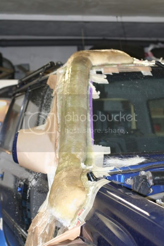

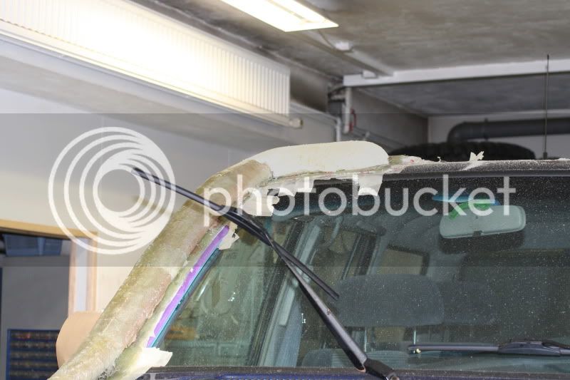

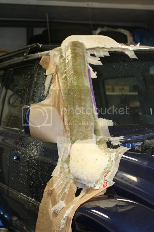

I started by forming the foam with a saw, knife, file and 40 grid sandpaper.
I had to add some foam so I had to take a long dinner time and wait for it to dry. Then I came back and finished forming it to a shape I like.
Then laid a glass layer over the foam, and went outside to play with my dog while it dried.

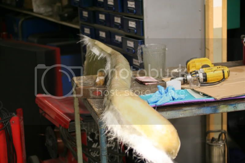

After that I broke that thing loose from the car, cleaned up some of the edges and laid glass to the downside that was impossible to do while on the car. So right now it is sitting on a table drying.
As you can see the surface of the fiberglass is quite rough so it will take lot of time grinding and body filling to make it smooth.
