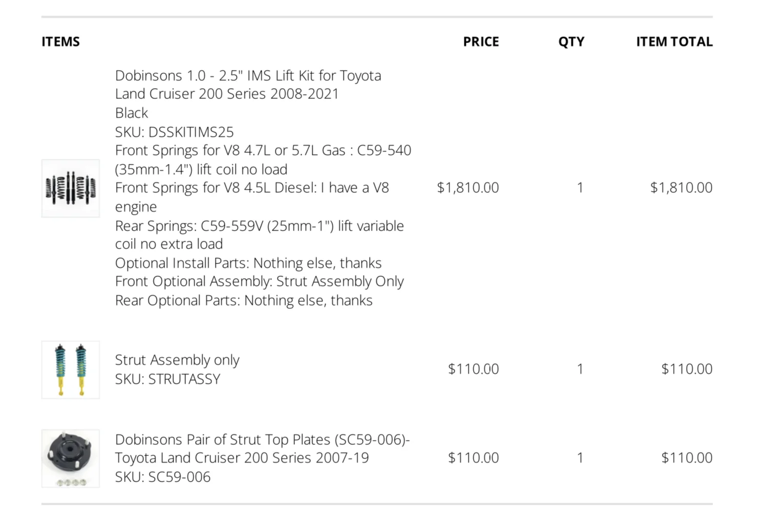

@BVE for your IMS setup - which springs did you end up with on the front / rear?
Here is my order sheet
