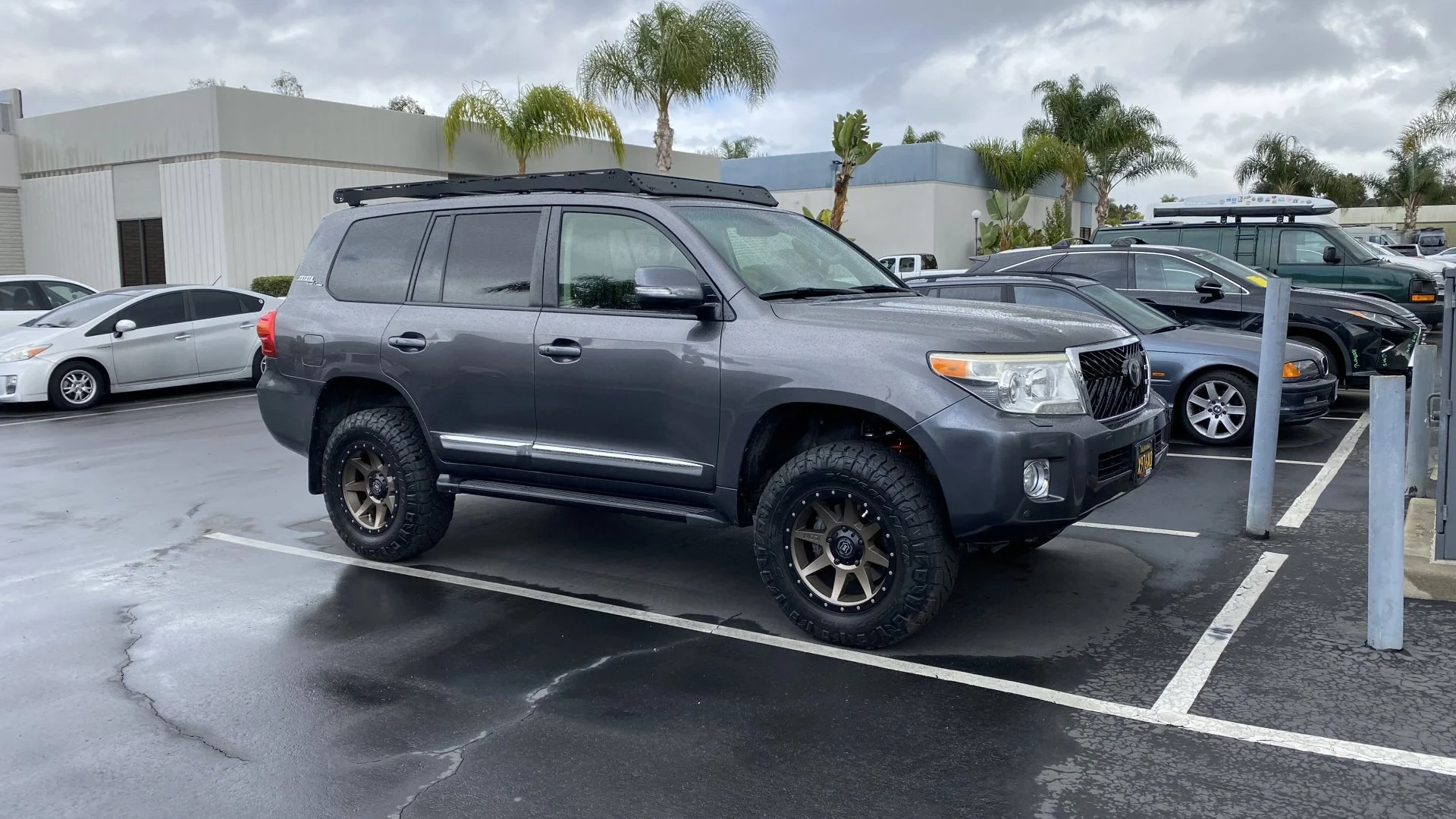

I feel like I got everything I wanted and have been pleasantly surprised so far, no regrets. I did put OME UCAs on with mine because you always get more than advertised and sure enough I did as well. I added a pic above that shows I basically have that factory rake, just a little higher.

Measuring center of hub to wheel well I’m at 21” front and 23” rear. So despite the 1” lift in front I think it’s still factory rake unless Dobinsons shipped the front shock with rear springs installed lol.
