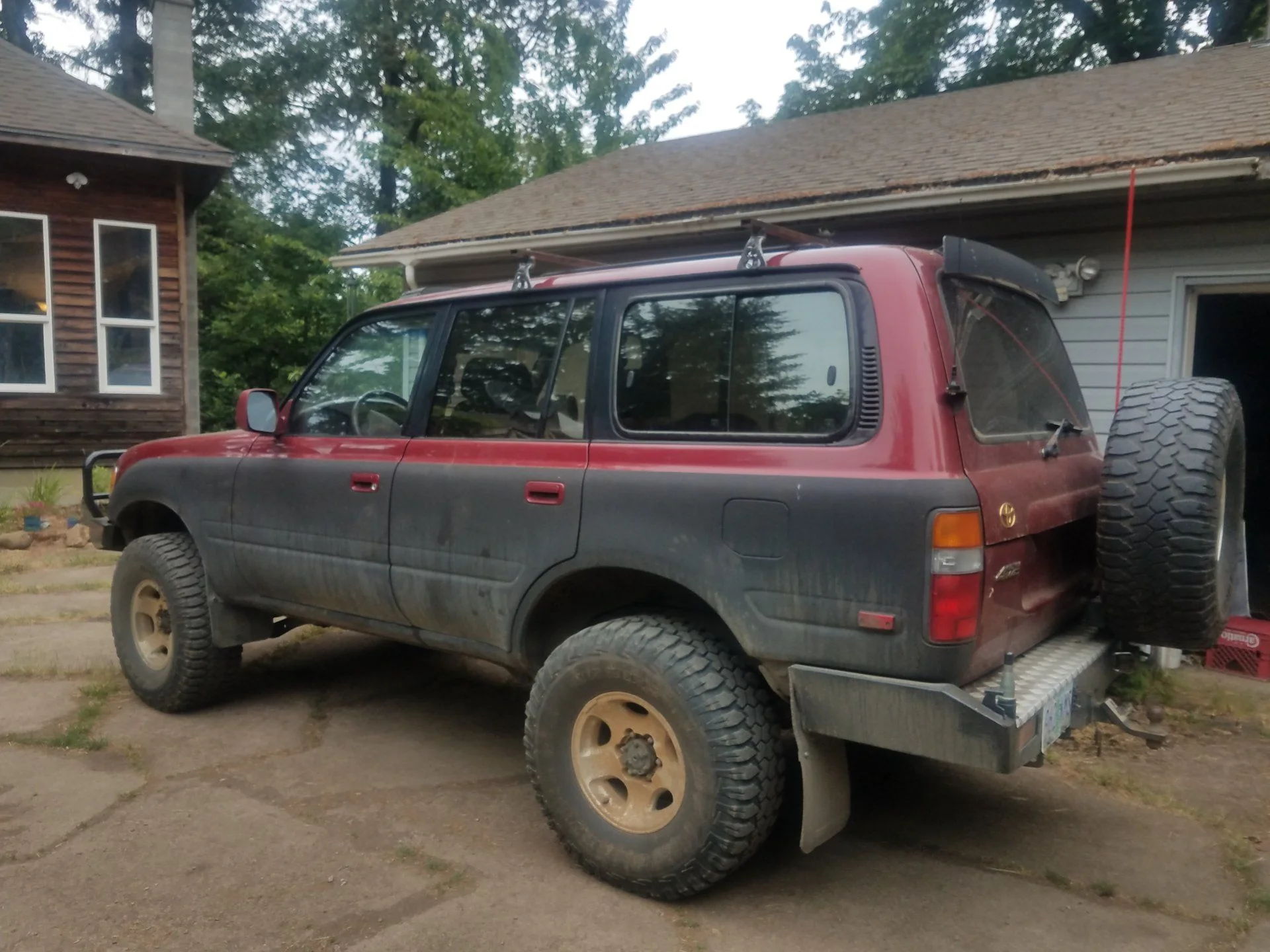

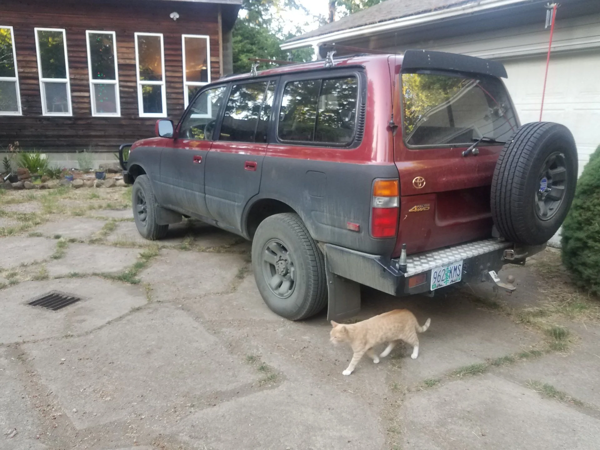

So here are some before and after pictures. Before is on 235/85-16s and an OME lift (not sure which, came with rig). After pictures are on new Dobinsons with 315/75-16s.

Definitely over 3” right now but that’s a good thing.
It went up more than 3" over the OME lift that was on it. And that's from the center of the hub to the bottom of the wheel well! Add the new tires, and it sits up much higher than it did before. Hopping out the first time surprised me. Wasn't use to it being so far up.
