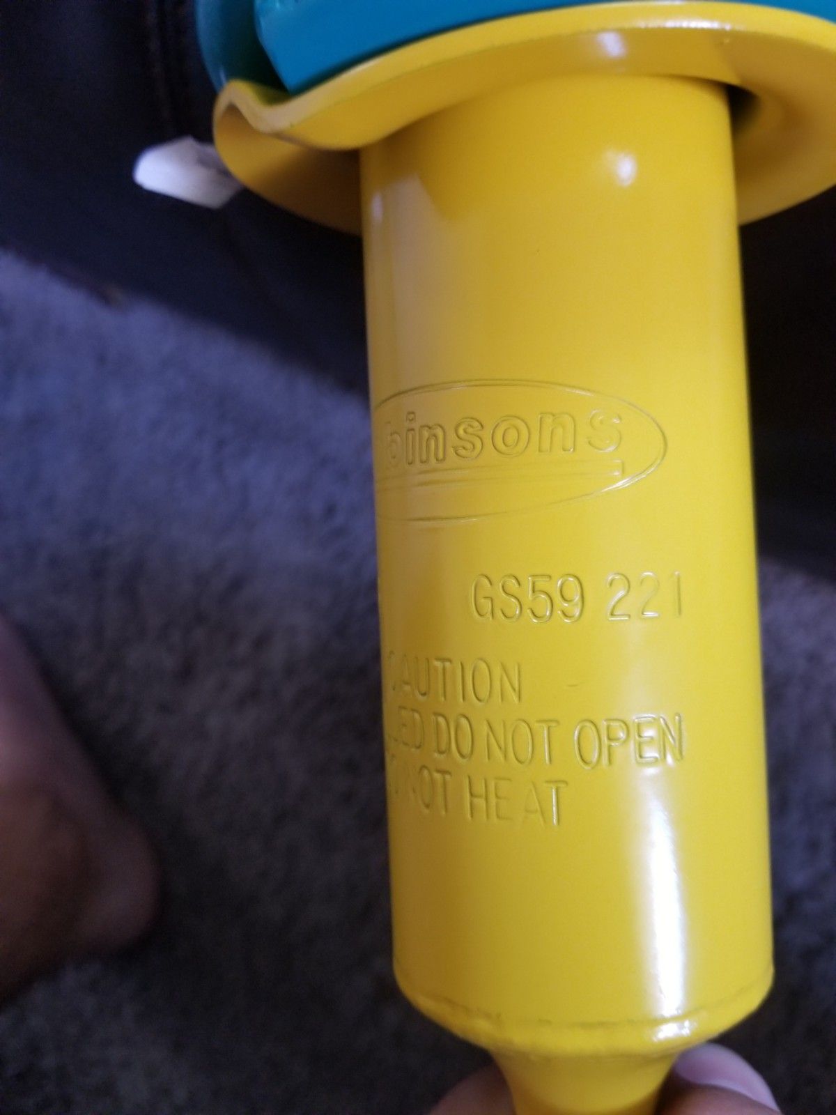

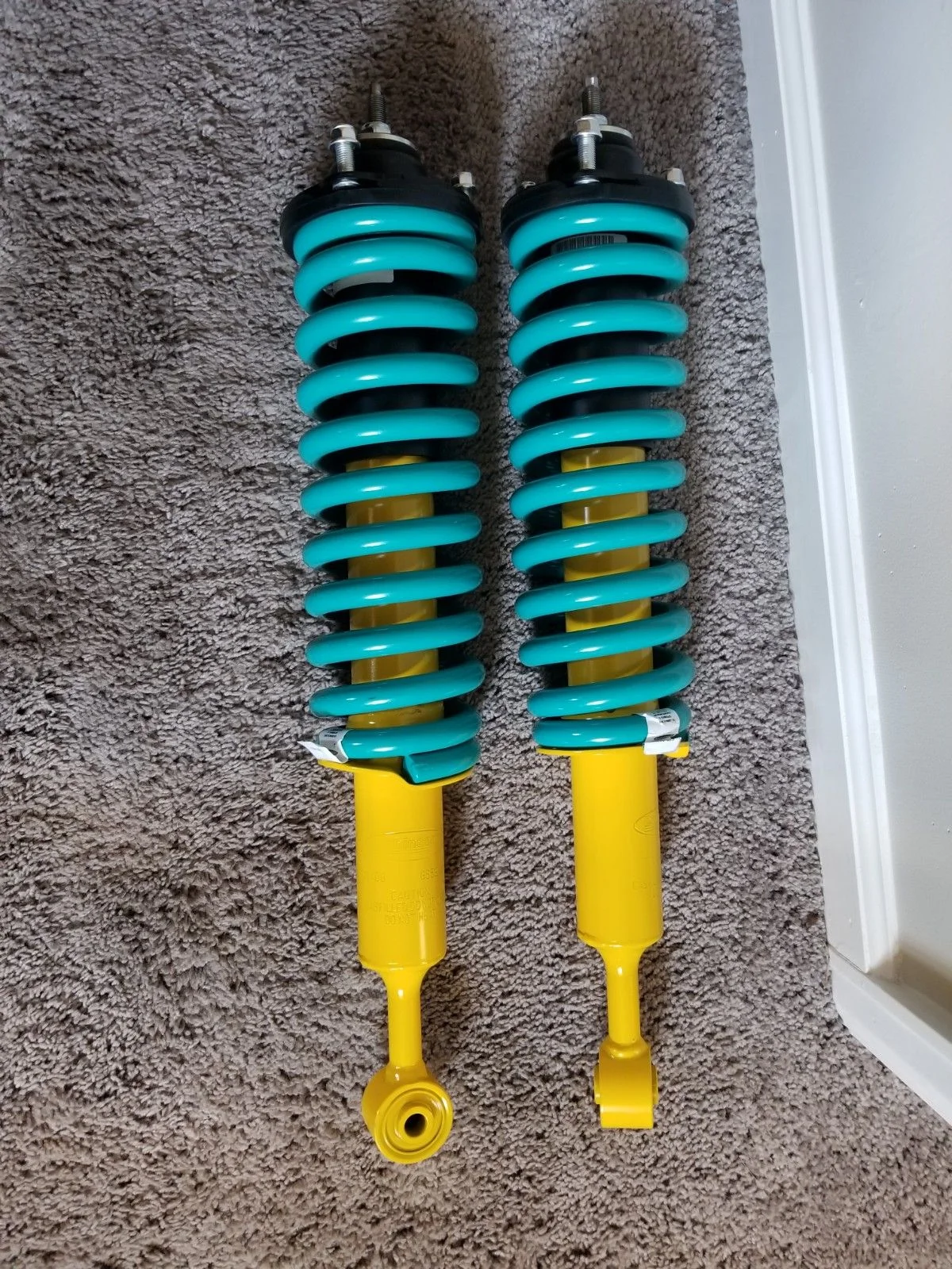

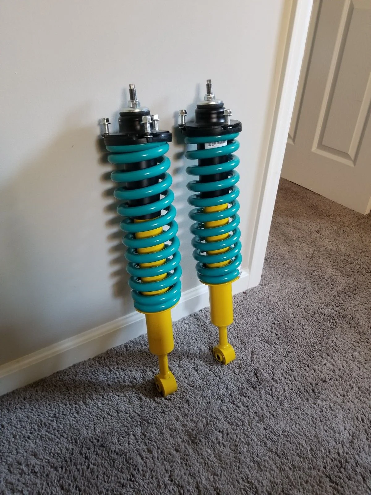

Dobinsons coilovers arrived. I went ahead and ordered the rear spings and shocks too. Check these things out- they are beefy. Thanks for all the info!

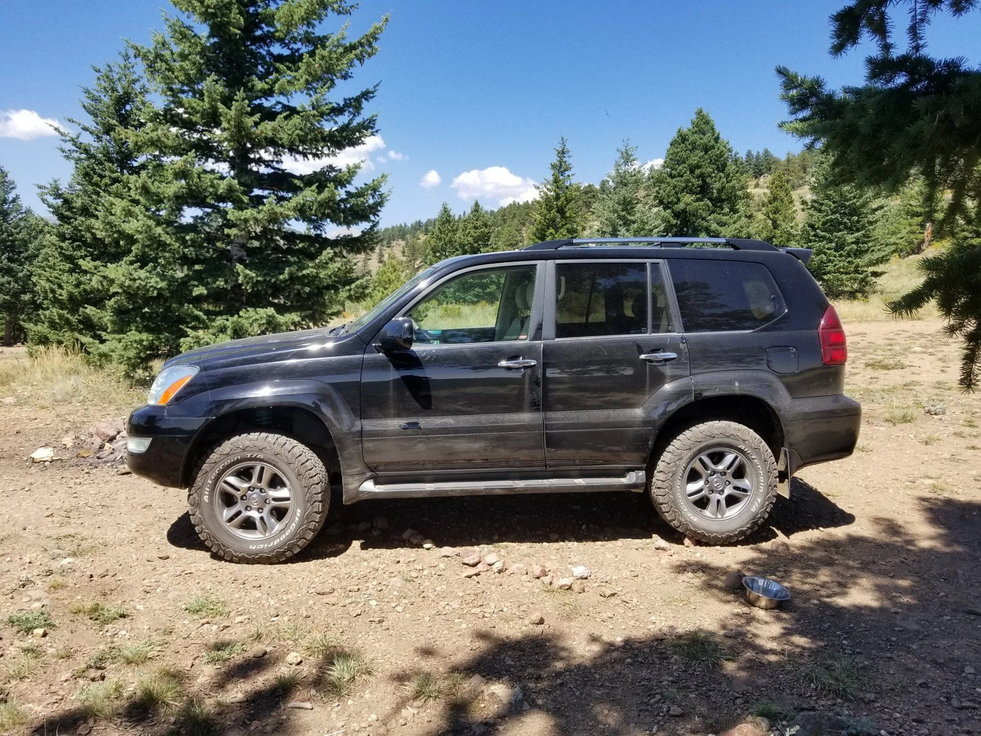

Here is mine with the Dobinsons 302 up front with their gas shocks. Love em.
she looks great!

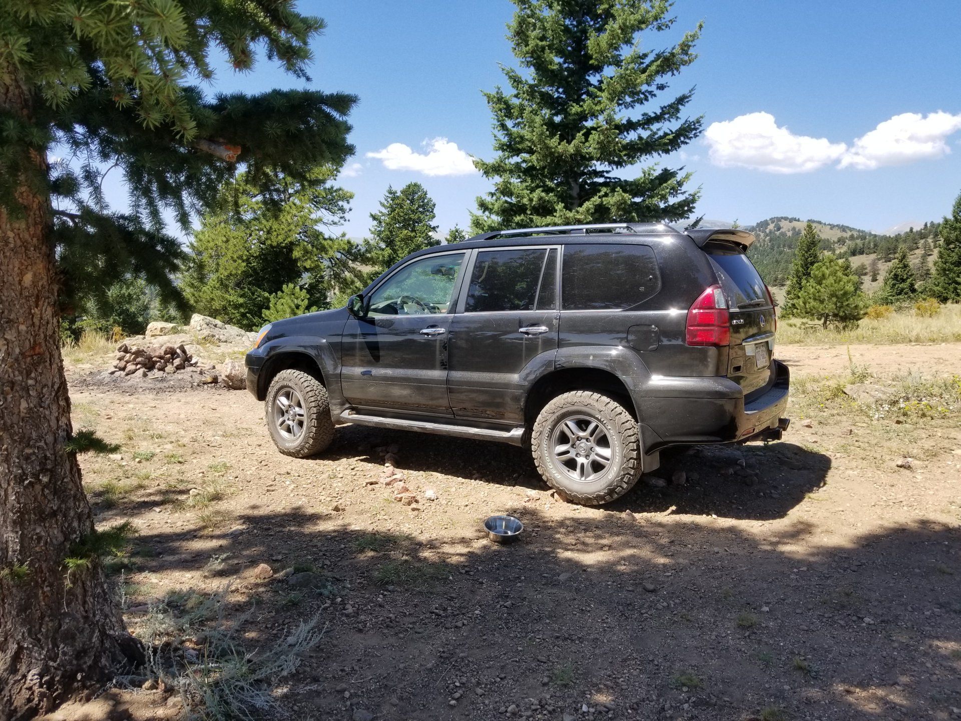

Nice riding suspension by the way. Here is what it looks like 1.75 up front 1.5 rear . It actually moved it up 2" inches and 1.95" rear .
