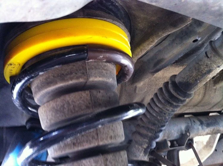

I’m looking to correct the drivers side lean after the coil conversion.

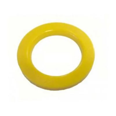

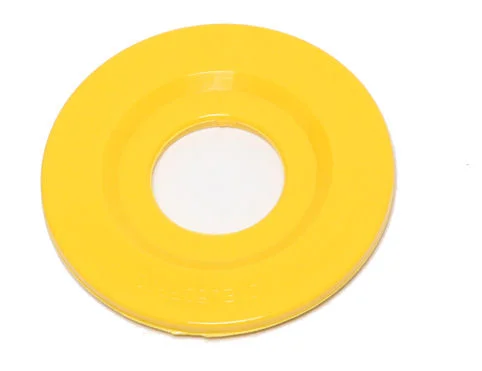

Im looking to add a 10mm trim packer to the rear. I’m seeing two types of trim packers:
(1) OME150PR10 that seems to fit on top of the isolator between the frame. Has smaller hole in center.
(2) OME80PR10 that seems to fit in between the top of the coil and under the isolator. Bigger hole in the middle.
Is one better then the other?
[Update 2020-01-13 -- I'll answer my own question. After watching YouTube videos, I realized that the placement of the trim packer can increase or decrease the distance of the isolator from the bottom of the spring where there's a puck holding the coil. So, I'm going to go with the OME150PR10 trim packer to add on top of the isolator between the frame. Someone had said his trim packers moved, but the OME150PR10 seems to have an indentation to keep it in place.]
