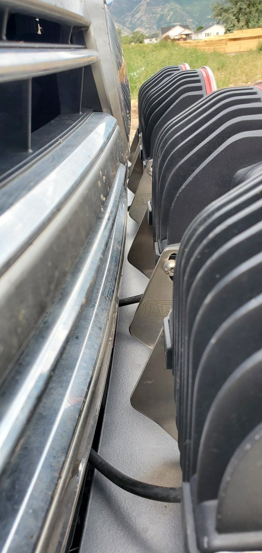

To answer your question. The mount with 2 holes is the Prinsu bracket. The bracket with the square slot (I had to invert it to reach the bolt) is the Heretic bracket.

I had wicked side-to-side vibration on the prinsu prior to installing the rubber trim. I still want to lower the wind deflector another .25-.5 inch.
I used the Prinsu brackes (upside down) for my adapt, but i may rig up another bracket to the front bar like you did. Thanks for the pics!

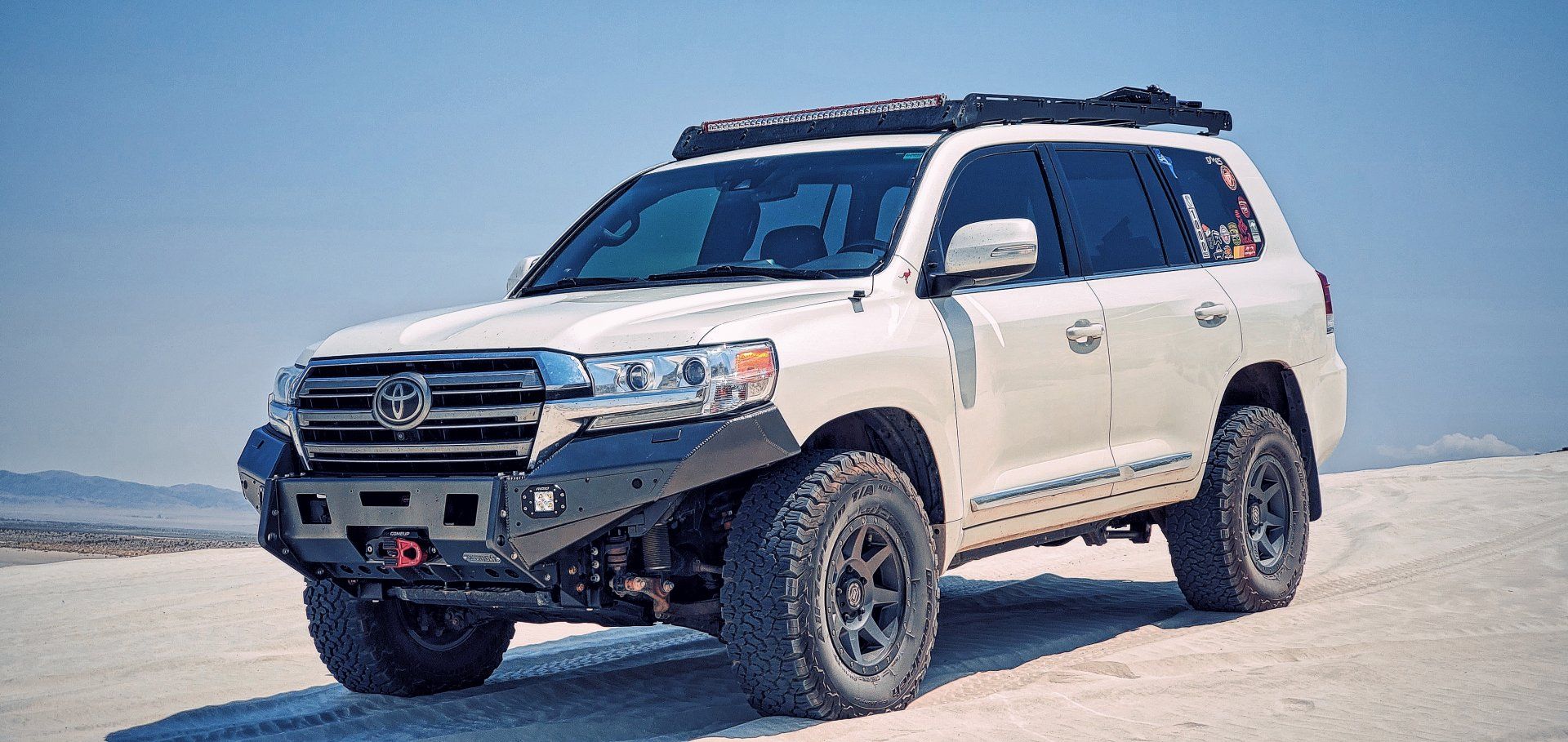

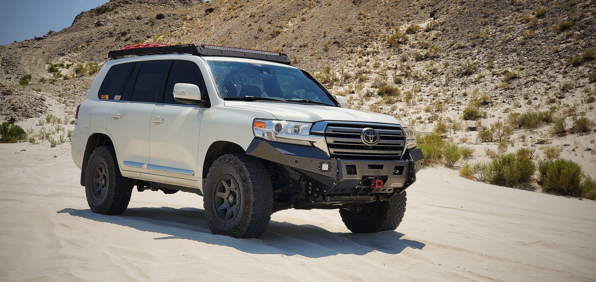

New truck turned 100k miles over the weekend on my way to California. Always good when a milestone occurs on dirt. I'd been talking to @benc about a bumper for about a month. I found myself on what was essentially an ATV trail a couple of weeks ago which accelerated my purchase plans. During the course of our discussion I'd mentioned to Ben I'd be driving through Colfax. He reached out early last week and mentioned he might be able to get a bumper finished if I could hang out Monday they'd install it. I decided to have him powdercoat the bumper gray in an attempt to match my wheels. Very happy with the way it turned out. Slightly darker than the wheel but glad I chose not to do black. I opted for the 3x3 flush mount lights and the Come Up 12.5rs. I wasn't quite ready to pull the trigger on the winch but doing it now was the right move. Super happy with the way it turned out and can't say enough good things about Ben and his crew at Dissent. I have four 6" ARB lights sitting in storage that I hope to put on this week. I might have to grind the mounts every so slightly to get them to fit or use the rear mounting hold on their brackets. I'll figure that part out when it comes time to install.

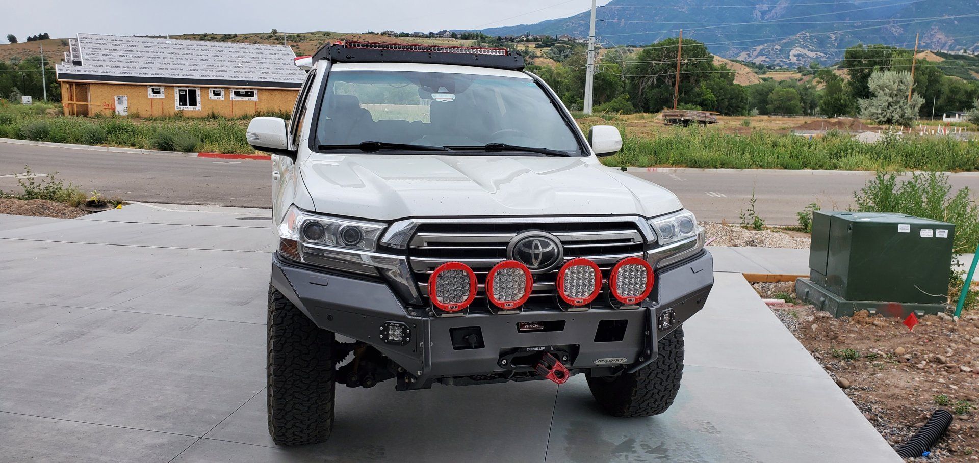

I dug my ARB Intensity LED (using the full name for searching purposes) lights out of storage and got them mounted up. I had to use the rear bolt hole on the bracket and it's very cozy but they clear with the Dissent bumper. I got some OEM style switches from On Board Air and hoping the new 'light blue' matches well with the factory switches. Plan to wire them up this weekend.
I'm only through one full tank with the new bumper in my normal driving routine and so far i'm about half a mile less per gallon. I pay way too much attention to those things so I'm aware of my range when out in the middle of nowhere. Next mod will probably be a long range tank but for now I'll track the bumper/lights effect on fuel economy.
Man, I think even I could see at night with that much light....you’re giving Monica a run for her money. Looks great 👍

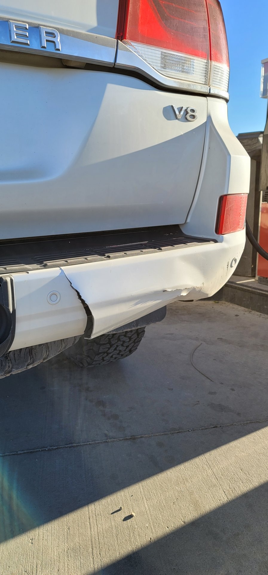

I chose the ARB Summit rear bumper. I've had swing outs on 2 of my 3 previous LCs and as much as I enjoy the clearance, I also don't like the inconvenience. I sleep in the back quite a bit and haul my golf clubs back there and always opening the swing out gets old. My hardcore wheeling days are behind me so I'm fine with my spare tire underneath. I can fit a 285/75/17 in the stock location. The bumper is there to provide some protection but also look good. I was delaying purchase for a while but my factory bumper cover got trashed last fall. I ordered the bumper in December but with global supply chain issues it didn't arrive until May.

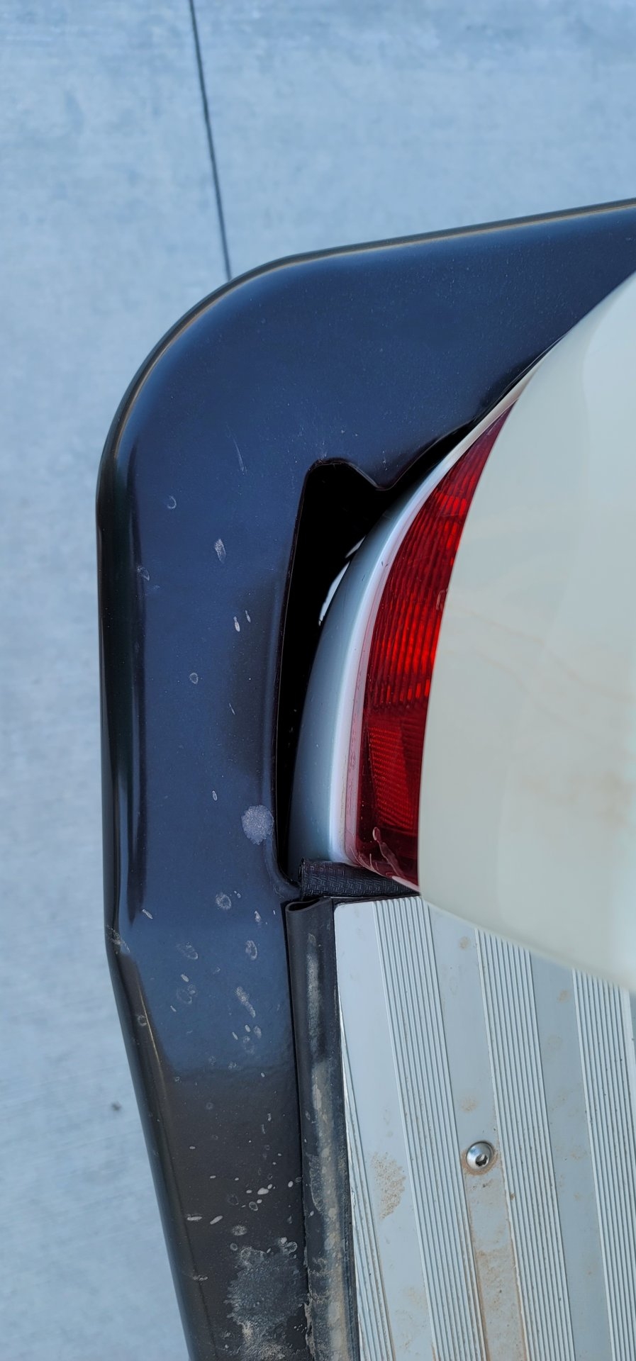

The Summit bumper is not made to fit 2016+ and there are a few obvious locations. Most importantly on fit, the bumper hits up against the spare tire brace. Oddly only on the passenger side. I'm not sure how the pre-16 tire carrier is different but I am hard up against it. Because of this the bumper will fit the bolt holes but also sits slightly rear of the ideal location. The tailgate BARELY clears when opening. I'm talking 1mm clearance. This is without bolting up the cosmetic piece that covers the bolt holes. My first trip I rallied pretty hard and the bumper slid back just a bit and the tailgate snagged upon opening. I have got it back and really snugged up the bolts and so far so good. Ultimately I'll pull the bumper and notch a gap in the bumper to get the bumper to slide farther onto the frame. It's crazy how much 3 or 4mm will make for fit. The profile of the rear quarter panel is obviously shaped to fit the earlier models and the gap if obvious. I'm really happy with how it looks and I've drug it once or twice so far and it's done exactly what I want it to do. I have a bit of a crazy plan for mud flaps but for now I installed the factory back onto the body and using a zip tie to attach them to the bumper.
