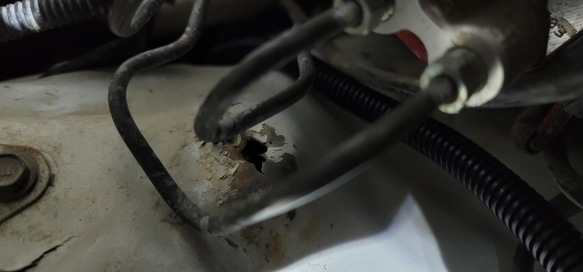

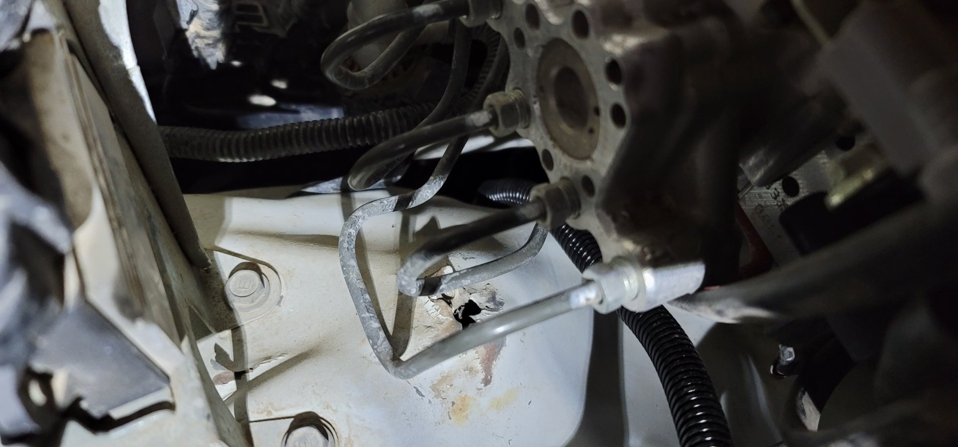

Not the best photos but they'll illustrate the point. I have SPC UCAs and suspension description is in the first post of this thread. I am currently waiting on backordered BP51s but this something I'm going to have to address with bump stops, some sort of plated reinforcement, or maturity. Not sure that last one will happen. My UCAs, at full compression, are impacting the inner fender and punched holes through both sides. This is the driver's side below the brake lines. I did a quick forum search between conference calls a few months ago and didn't find many results for this same issue but perhaps others have had similar issues.

Dammit. After seeing this, I feel like I need to take the springs off my coilovers and cycle the suspension to see if this might happen with my setup. With how I drive, this could certainly be a concern for me.

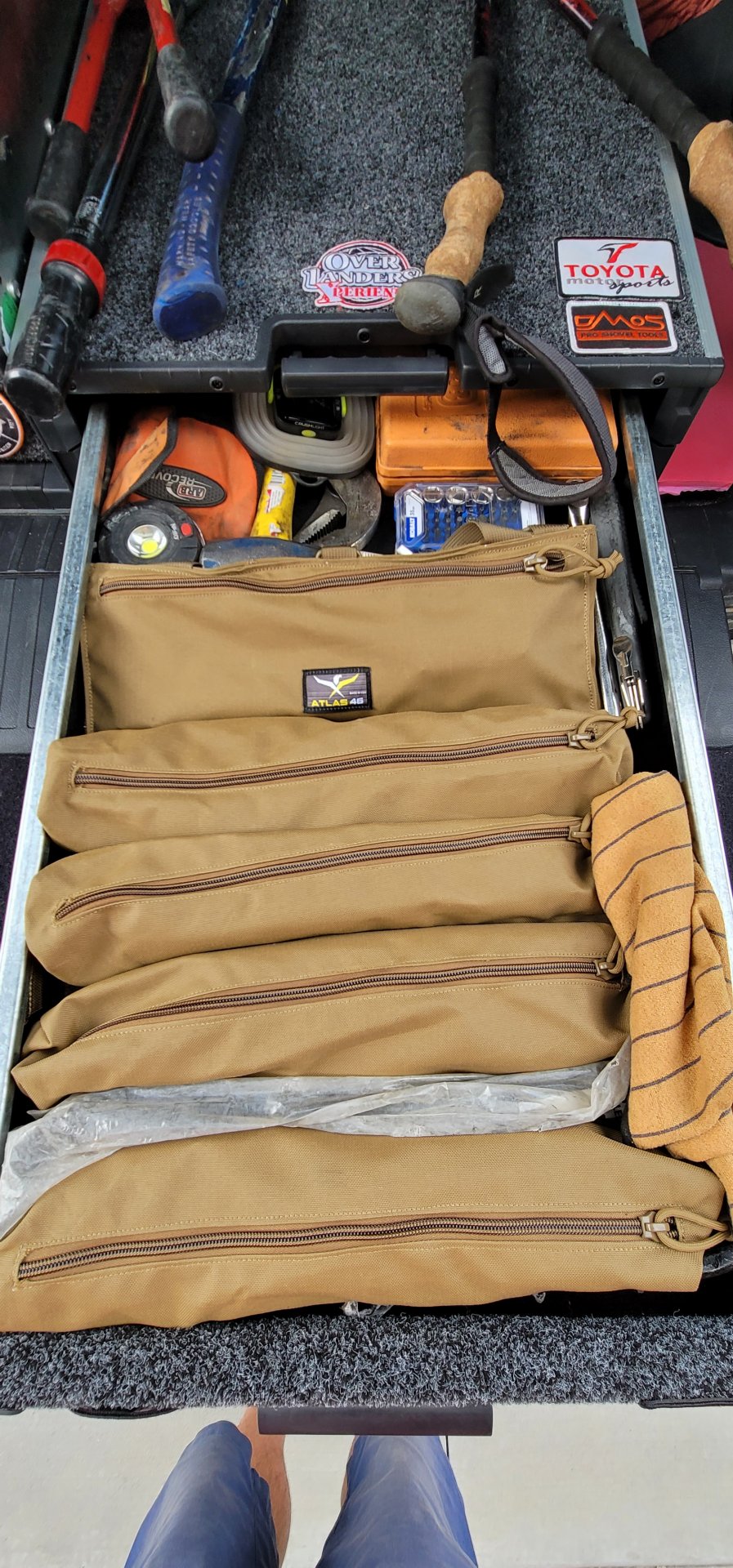

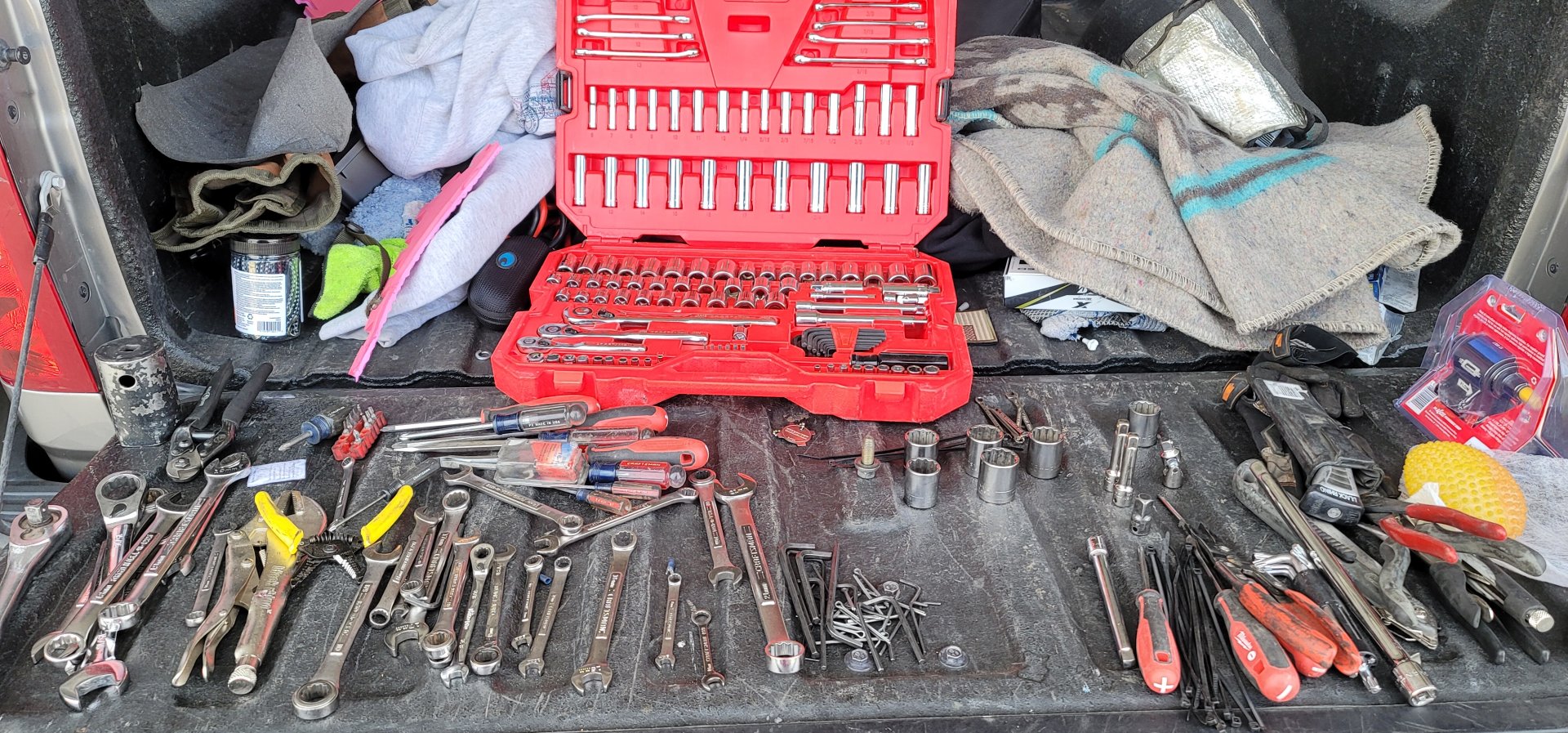

Lastly I made a change to my drawer set up to match what I had in my 2013 200. I'm getting too old to have to climb up on the tailgate to access my fridge. So I pulled out a full height ARB drawer and went to a roll top. Also moving from an ARB to National Luna dual zone fridge. I've been using an ARB since 2006 so it's a big change but looking forward to a dual zone set up. The real thing I'm sharing is I bought an Atlas 46 tool roll to fit in the drawer. I started with a cheap version from amazon and the idea work but wanted to go with quality. I'm not going to lie. The price tag on the Atlas 46 was a bit of shock but I'm stoked with the product and the application. Almst all of the crap in the first pic is now in the tool roll.

I’ve been drooling over those bags for a while but have waited on buying until I get drawers. Seeing how nicely that fits might have pushed me over the edge. Which bag is it, they have a few of various widths.
I got the Yorktown. 16x19x3. it's ever so slightly snug height-wise but I have it on top of a breaker bar, bolt cutters and large set of channel locks to keep down the vibration. Without those underneath it's the perfect fit.

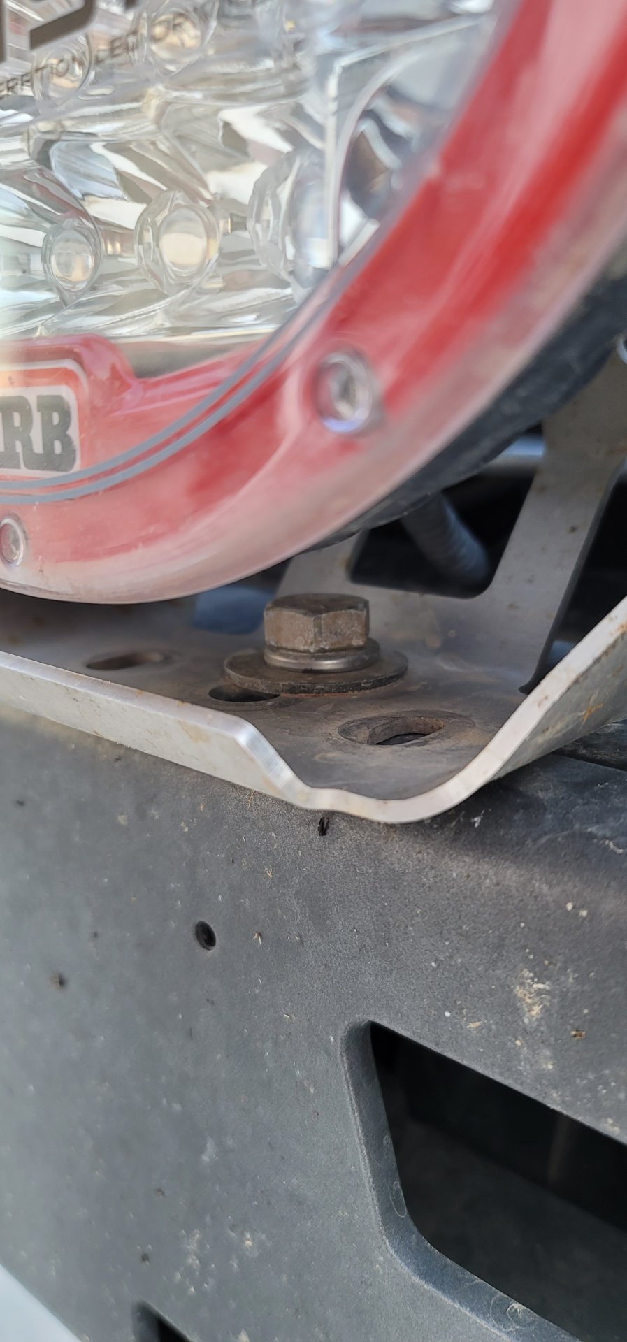

Do you have a side profile shot on the ARB Intensities and the front grille? And did you drill a new hole to mount them? I am curious to see once I receive my dissent if I can put in the same lights.
Did not have to drill any holes. They fit but just barely
^^Appreciate you sharing those photos. Gives me a better idea how it will sit on the bumper.
