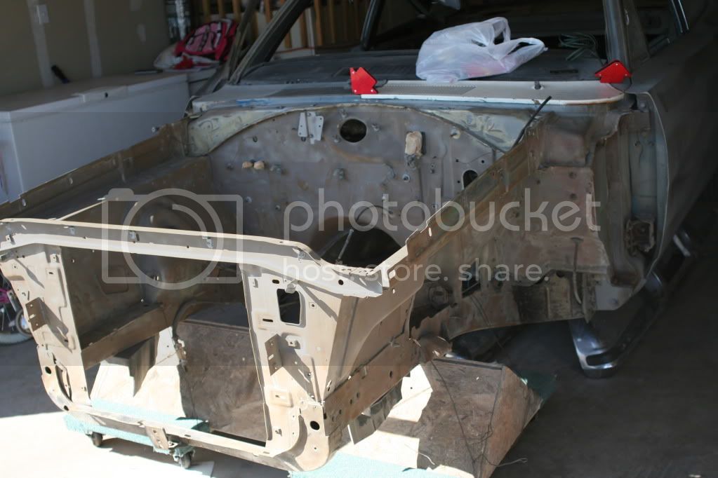

It was rusty - luckily not the fenders, but it was rusty - wrecked (slid into a guard rail), and torn to pieces.

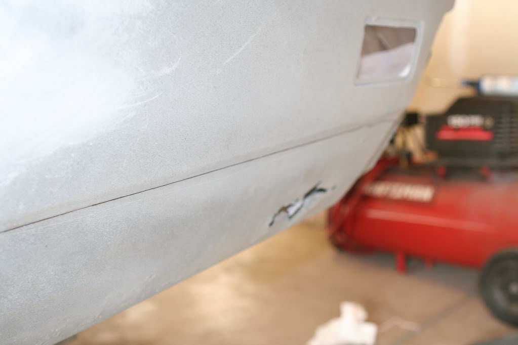

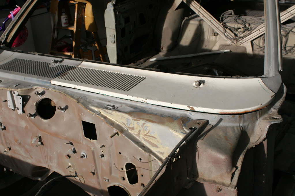

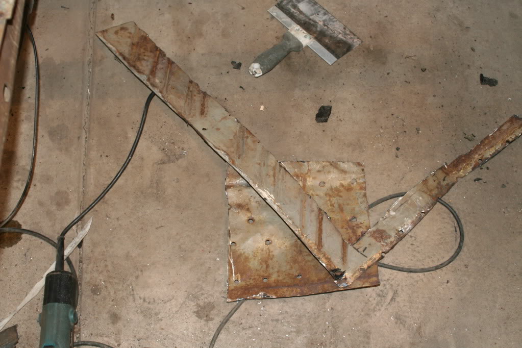

I started by cutting the cowling out of a donor car (along with the driver floor) and solving those problems:
Previous owner also hacked out a strange diamond-like shape hole here:

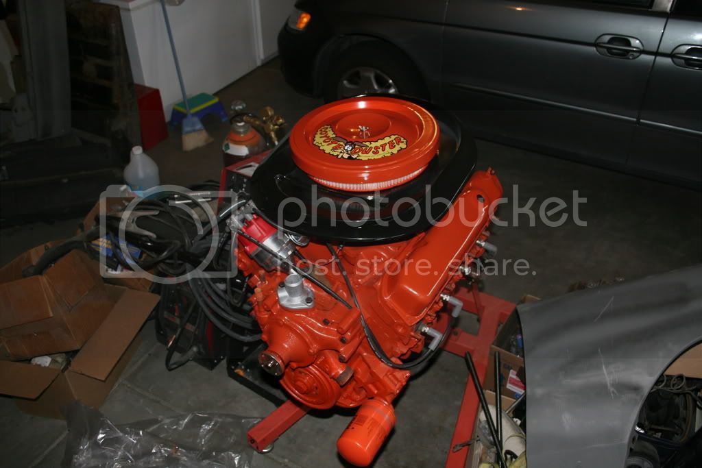

Then I had to get busy with the engine. I paid off the engine builder and had him complete it. Keith Black pistons, slightly aggressive cam, MSD ignition, and a few other hidden goodies. I also had him dyno it and run it in for an additional fee.
After it was completed, it was ready too install, timing set, 405 hp, 410 ft. lbs of torque:

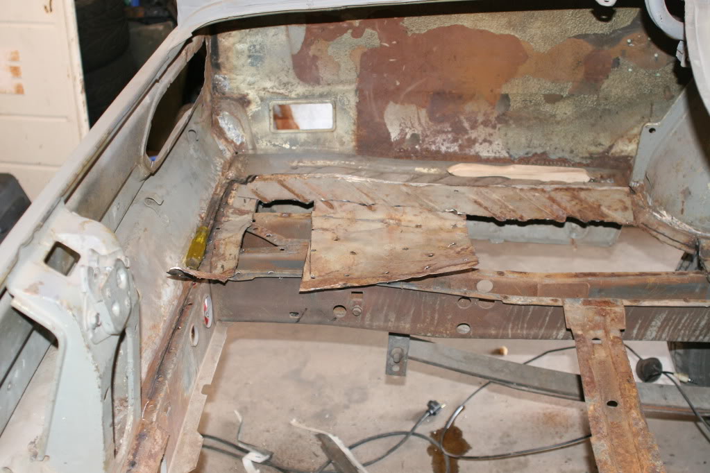

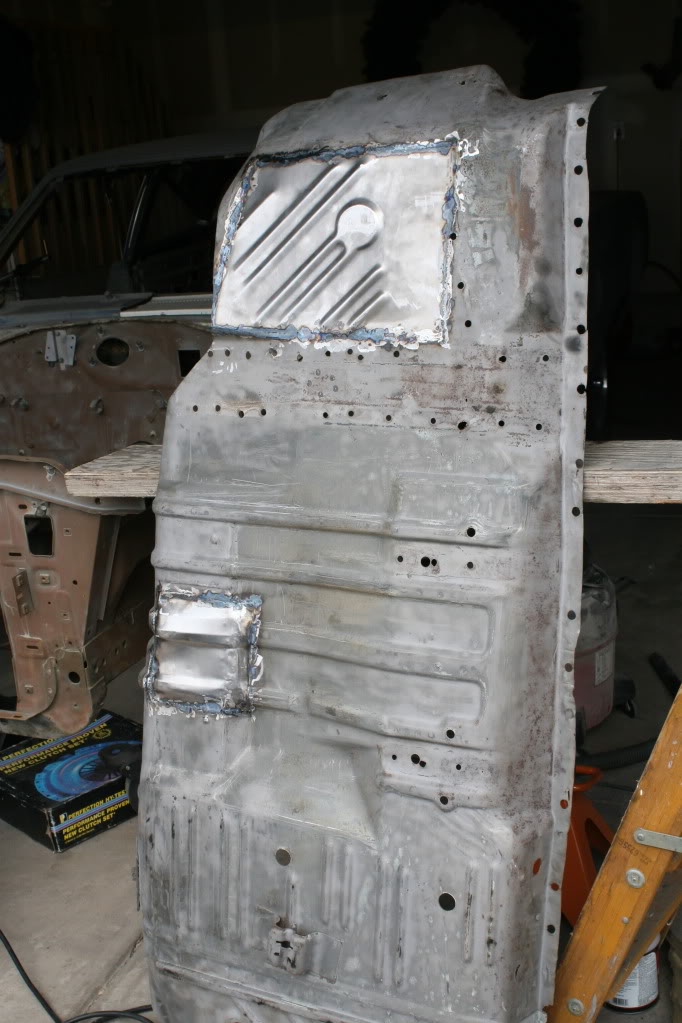

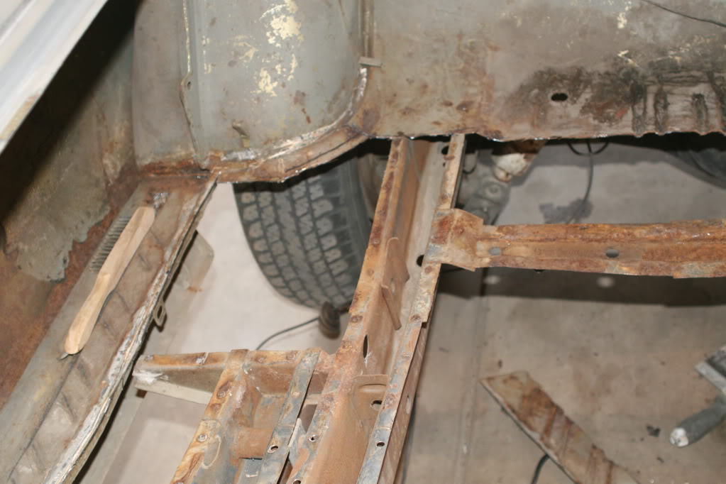

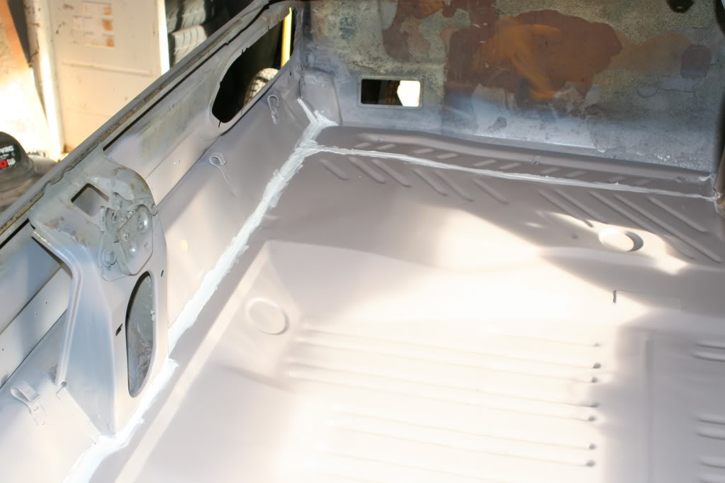

After that 5,000 bill - I moved back onto the body, welding in a new trunk and finishing the floors. What can't an angle grinder and a wire feed welder fix in the auto body world?
Breakfast in......the trunk.

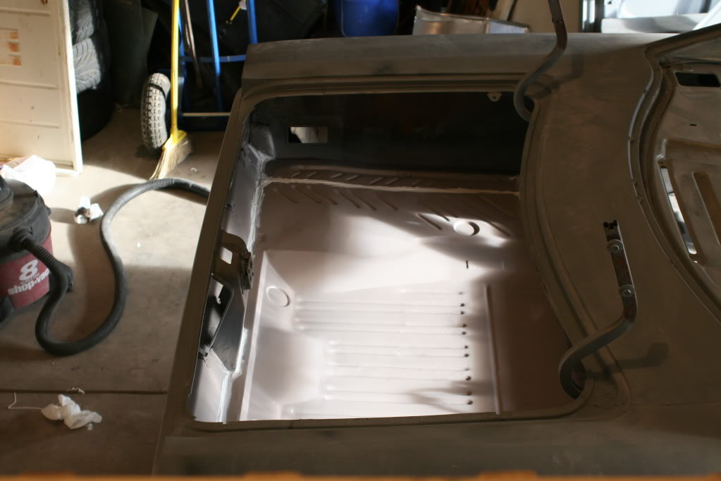

Ready for the new trunk floor:
After steel was in, I used:

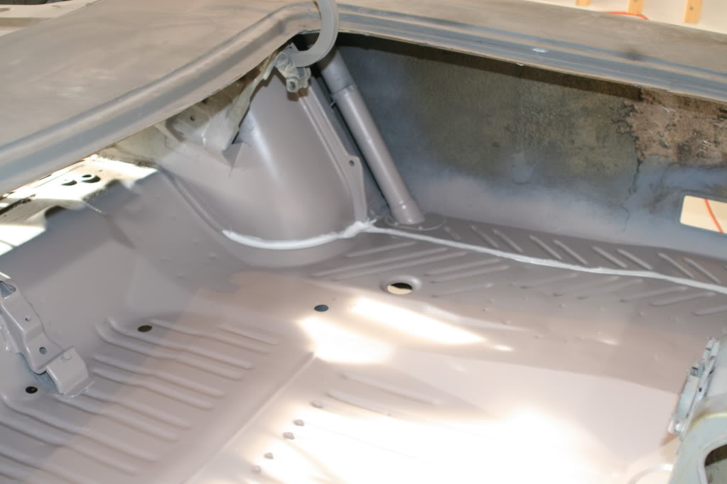

New trunk primered and sealed:

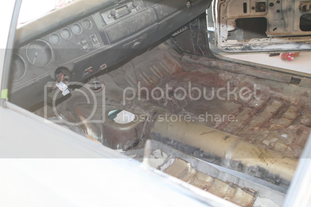

More floor work:

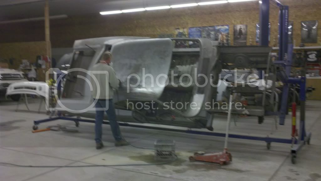

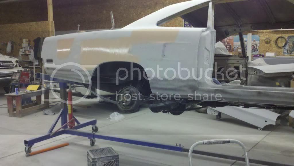

Now - to take the entire body down to steel....by hand.

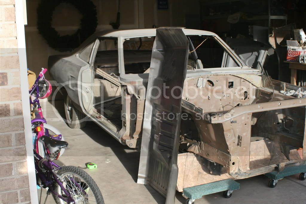

I had to cut out the bottom of the rear driver:

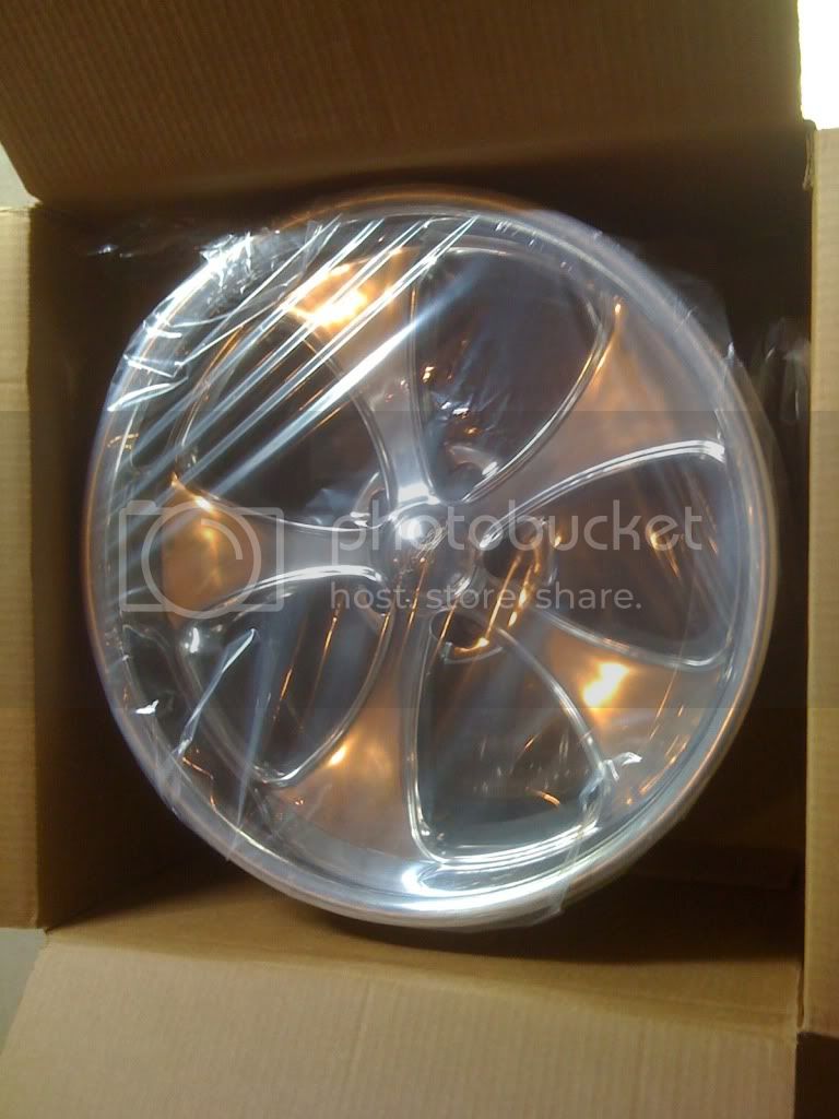

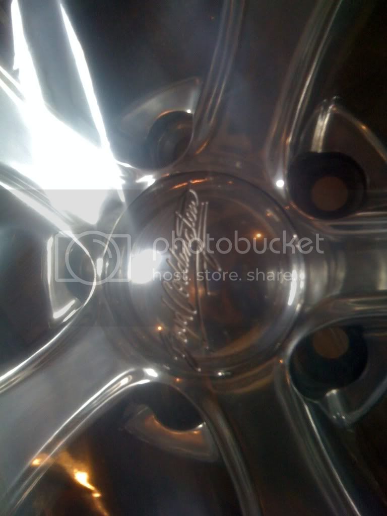

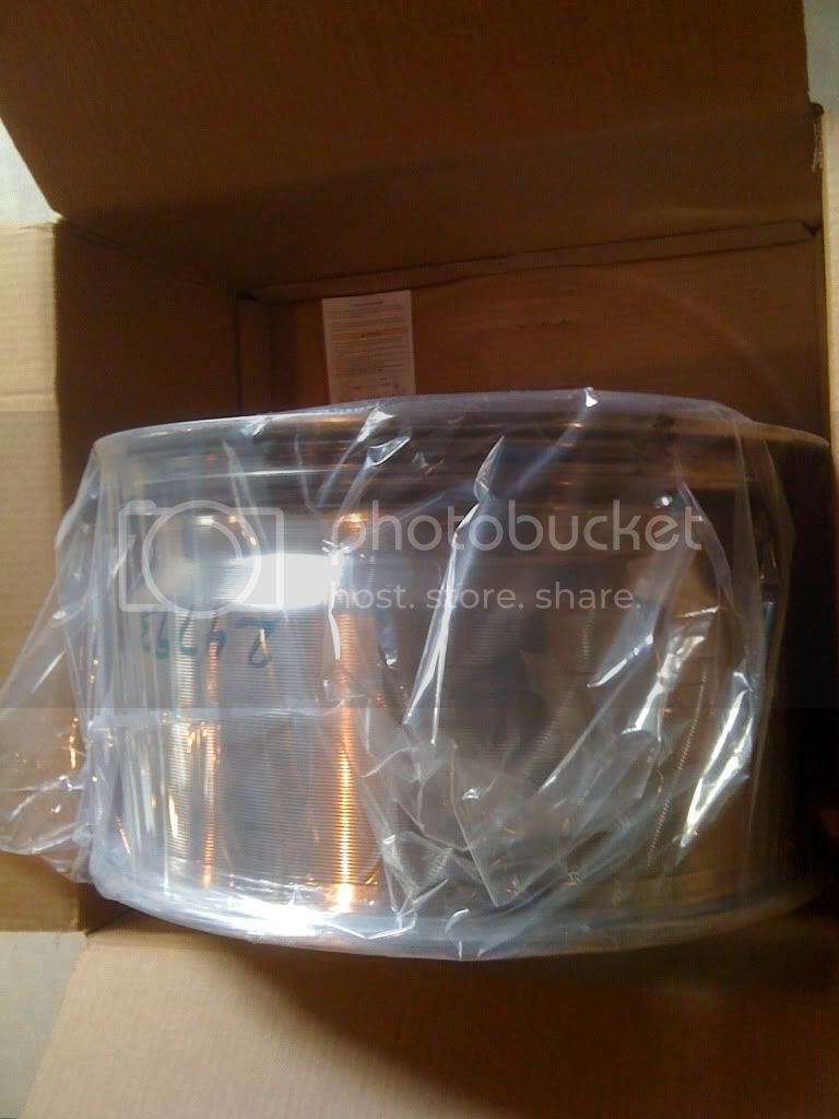

I contacted Boyd Coddington (Welcome to Boyd Coddington Wheels) and have them custom make me some wheels.
This is the ONLY non OEM part of the car.
Front: 17x7
Rear 18X12 (Hoosier D.O.T. drag radials 315.30.18)
It took Boyd Coddington 6 months to deliver these custom made wheels:
They look beautiful....but this is all the peaking you get for now.

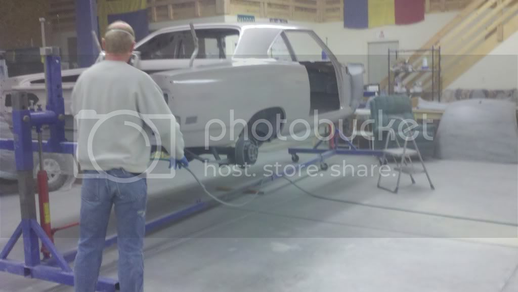

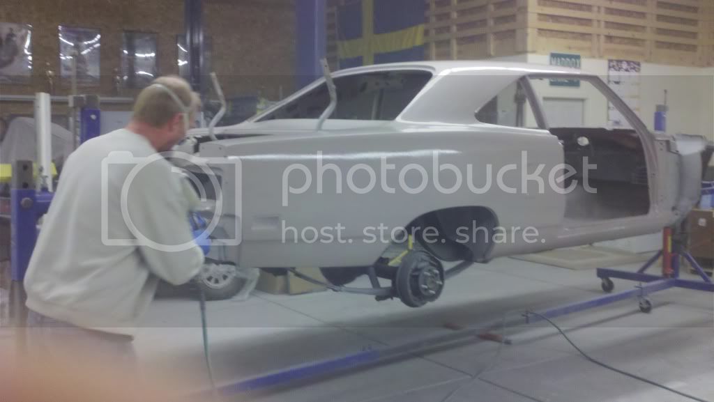

More fine hand work:

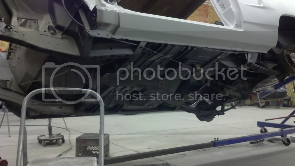

POR 15 the enderside and 1st coat of primer....

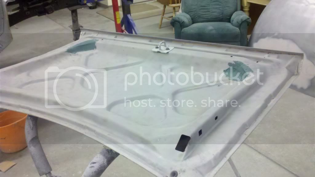

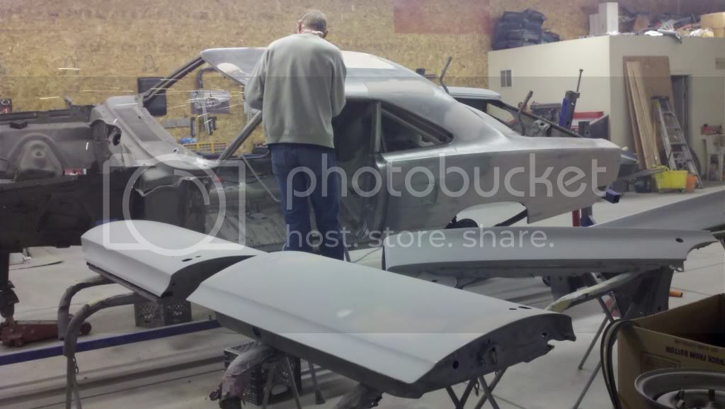

Using light coats of filler on the huge Plymouth fenders to make it perfect. . .

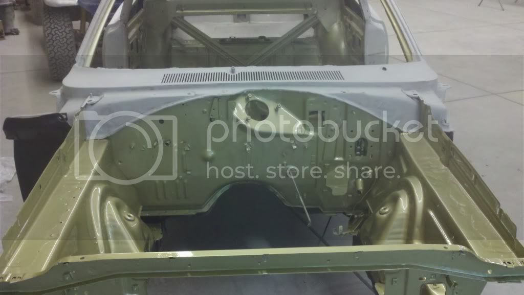

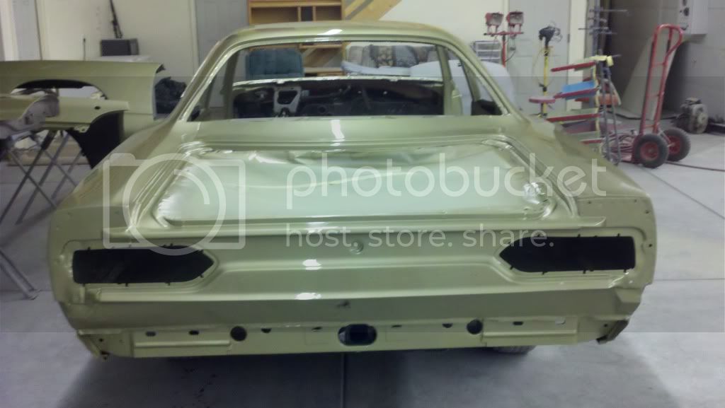

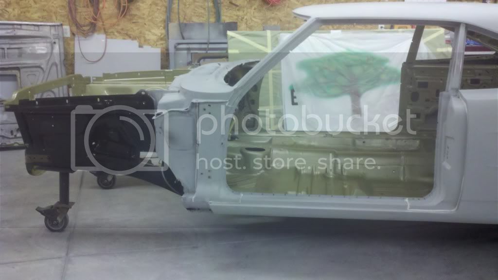

Final primer

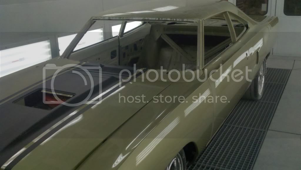

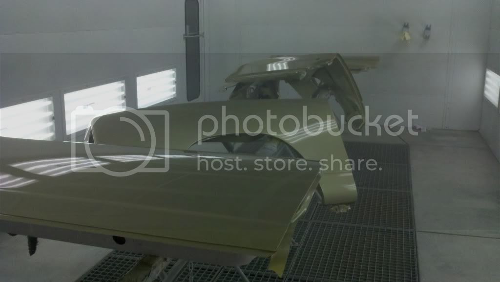

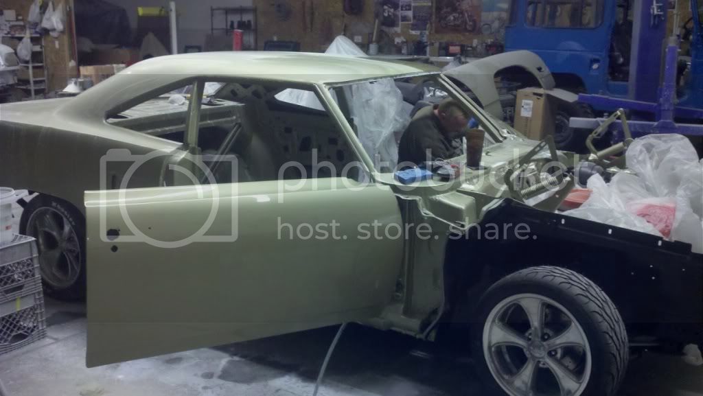

FINALLY....seeing some of that lushious FY4 Citron Poly Mist

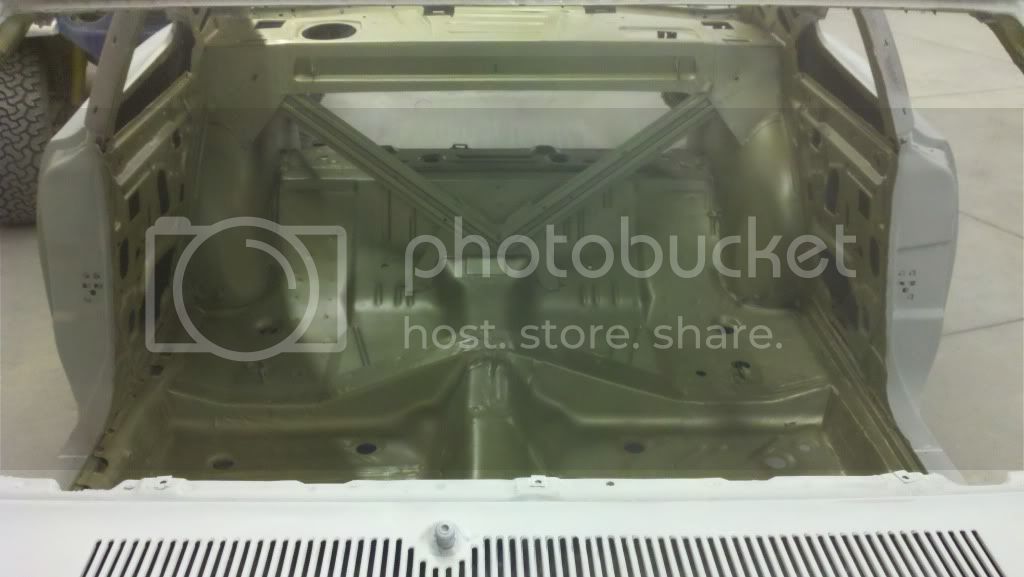

Just after jambing the car....
Engine bay:

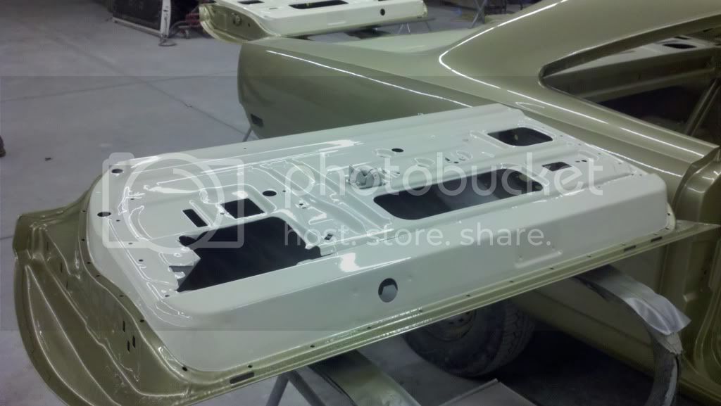

Interior jambed:
Exterior of the doors and fenders:

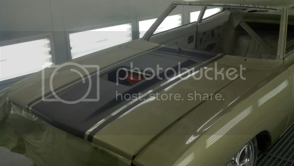

Body exterior, hood and trunk are next....

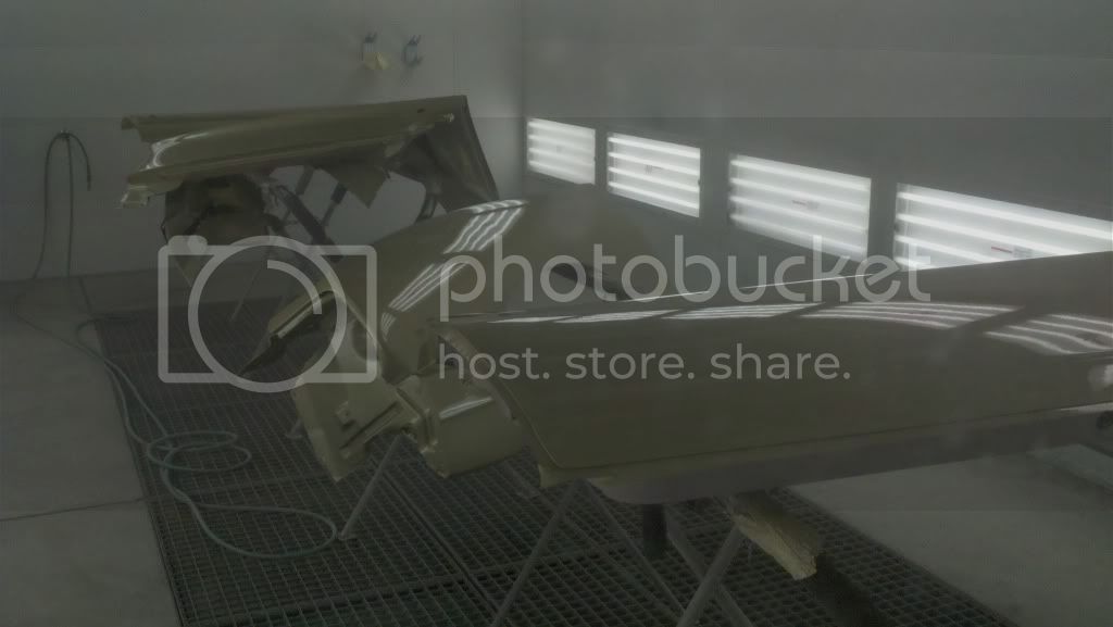

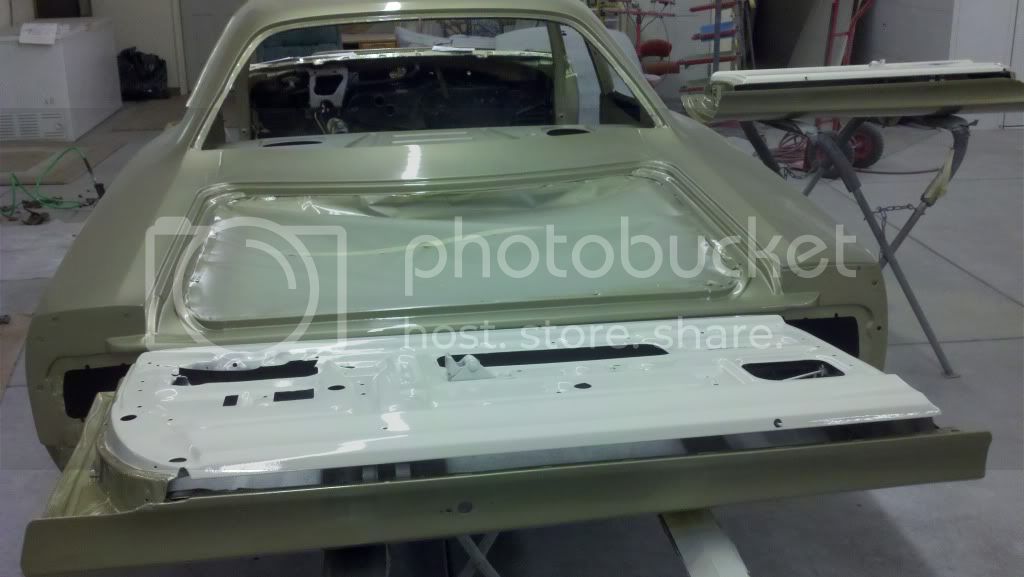

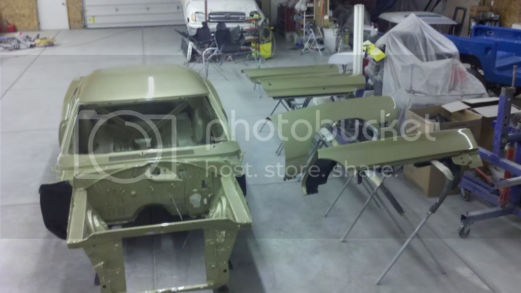

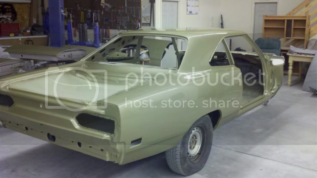

Doors are finished being painted - alpine white inside.
Yes - the PO hacked for speakers, lame. Will be hidden with door panels however.

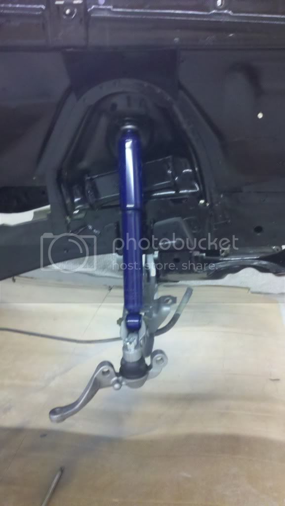

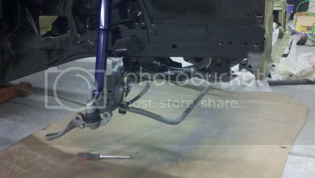

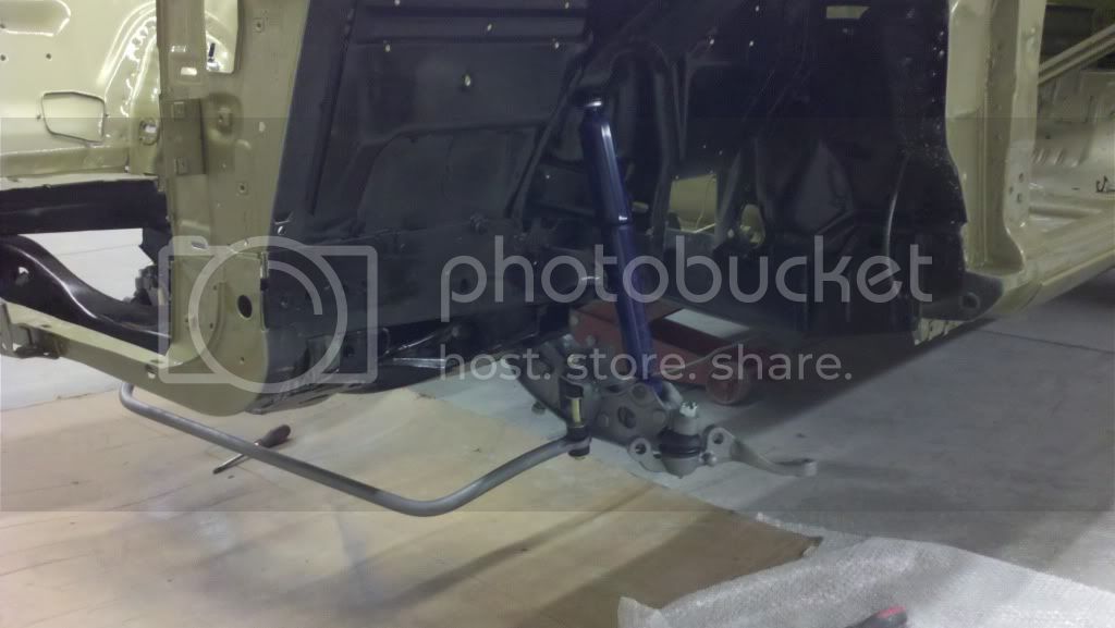

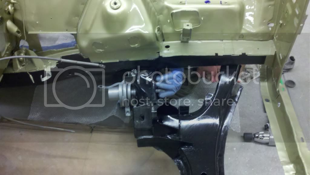

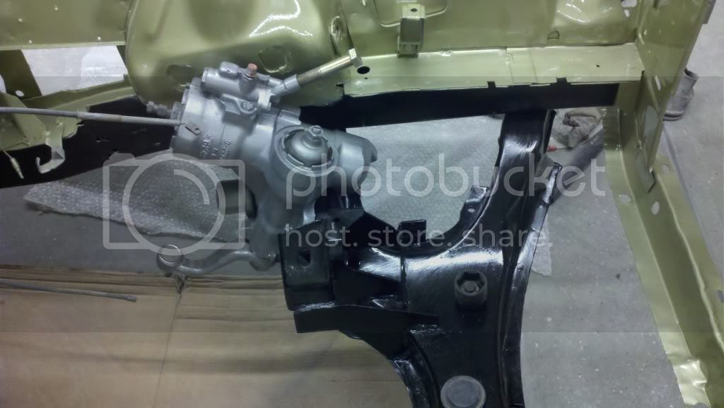

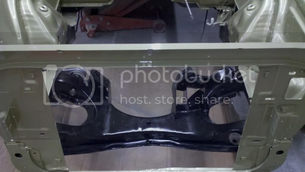

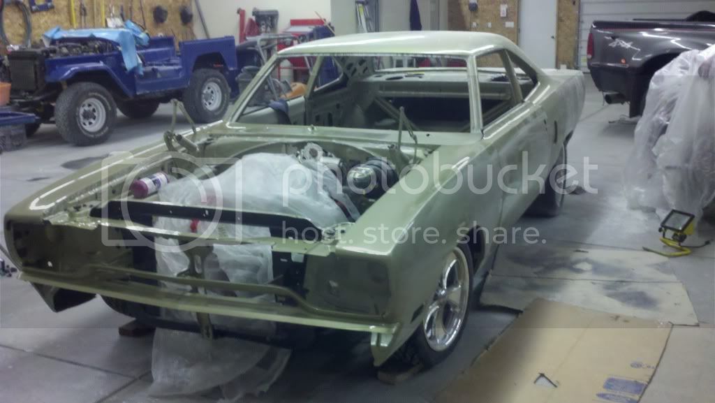

Now we are working on the front end, piecing it together first, and then will remove it to put the engine on, etc..
I have to get a new pitman arm. The stupid things are 150 bucks. I wish they would have designed them with a removable ball joint, but its all one pieces which means you have to replace the entire arm. Stupid.

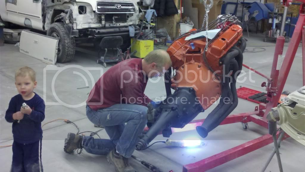

Wrestling the big block into place:
Settled in:

Painting the cowling area to match the hood (black goes all the way back):
Another:

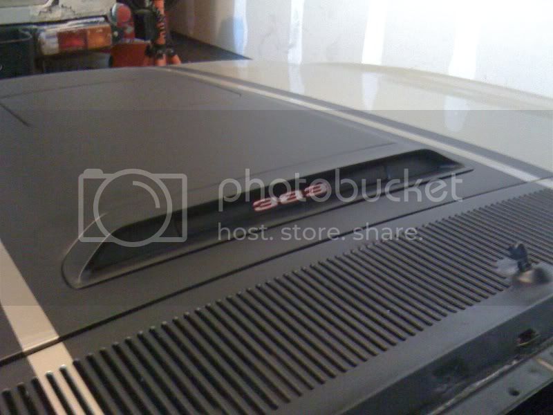

383 Emblem:

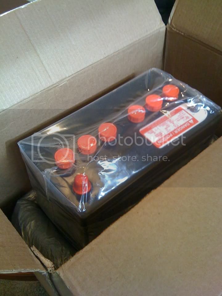

OEM Battery Delivered. Expensive buggers. . .

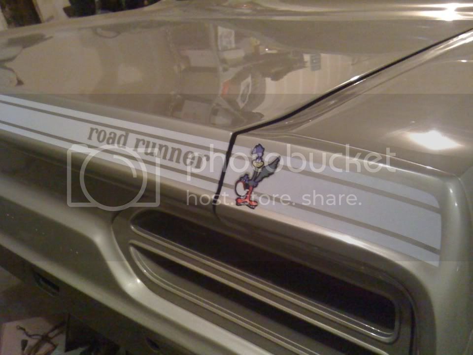

Fixing decals:

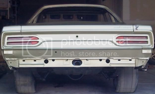

Butt end:

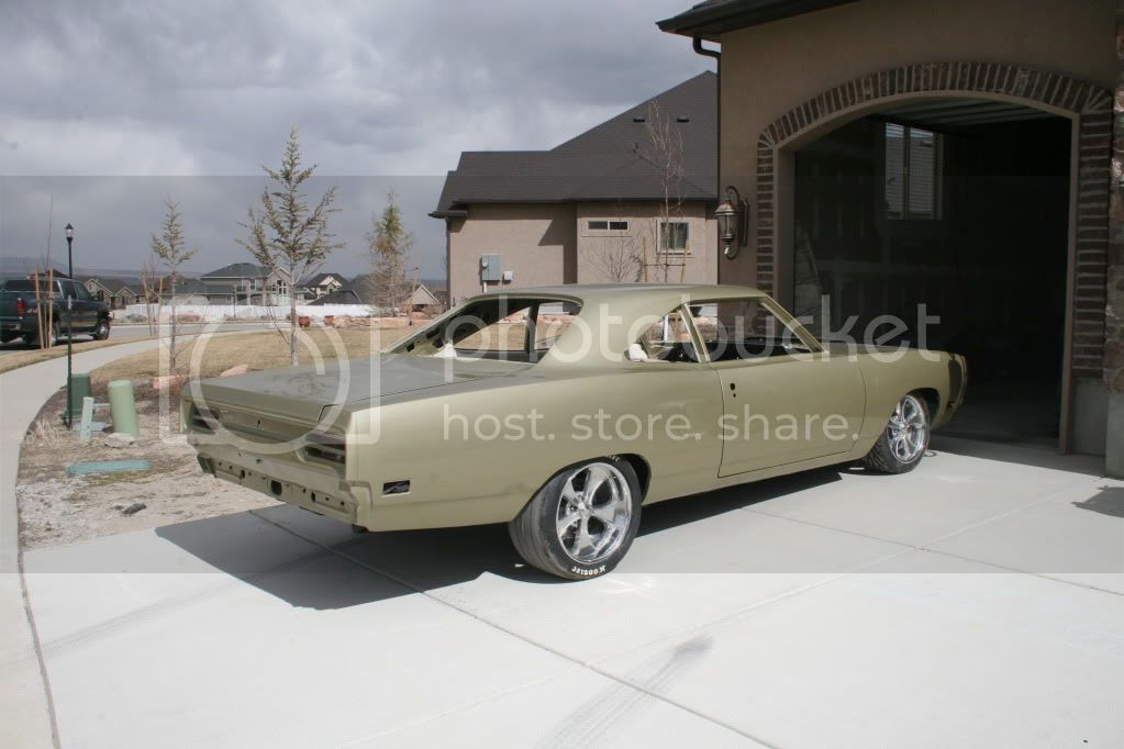

I put 4.10's in the rear. 410 hp to those tires should be fun. Well, more spicey than a 2F anyhow.
Radiator, Interior, and glass is all that's left. Well, bumpers too I guess.
