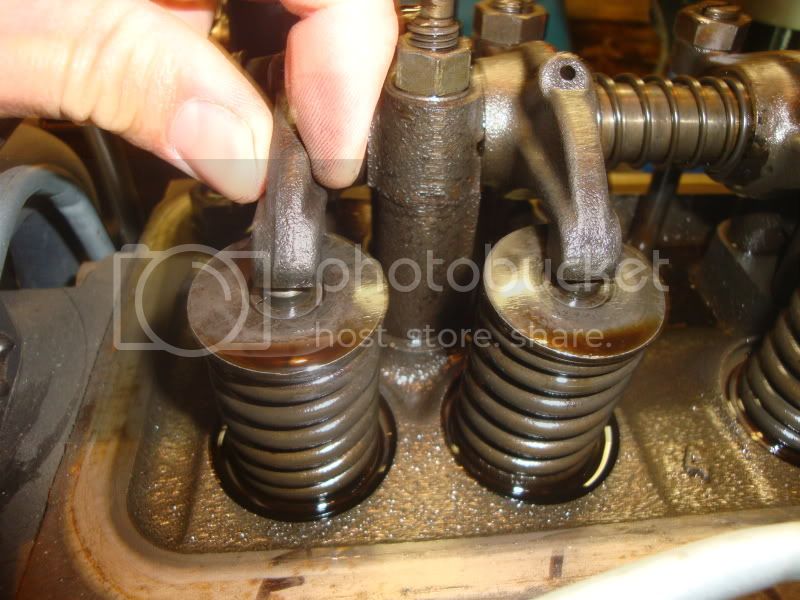

There are a couple of ways to be sure the piston is at TDC. You can remove the spark plug of cylinder 1 and place your finger over the hole and feel pressure building as you turn the crank. The pressure building up indicates the piston is coming up, eventually reaching TDC. You should see the line approaching the pointer in the window. Align the pointer and line after piston comes up and you should be at TDC. You can also check the rocker arms and push rods. Both valve springs should be extended and you can feel a slight play in the arms and pushrods. If you have the flywheel line and pointer matched and slight play in the rocker arms for cylinder 1 you are at TDC.

a few days ago i read this and followed the instructions: just the (TDC) part of it. it didn't fire so i was thinking that this is a four stroke engine; so the crank has to spin twice for the #1 cylinder to fire again. i just pulled out the dizzy and spin it 180 it fired right up.

the order is still the same. in a four stroke motor the crank actually spin two times around for all six cylinder to fire just one time. the piston actually goes down, up, down, up then fire. if it has only gone down then up one time, even though now the crank has actually turned 360, it has only gone two of the four cycles. it will take another down, up "another 360 of the crank" for that same cylinder to fire ones more. so when i had the TDC at the pointer, i was actually only half way through the four cycles. Kent went on about making sure that the piston was at the TDC. i skipped that and was 180 off. Kent's way is the way.
