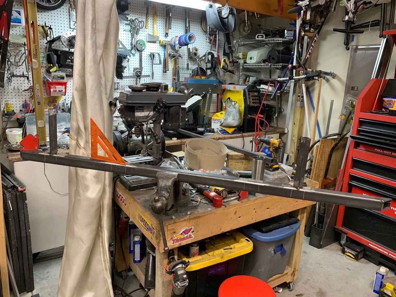

Trying to determine the right placement for the main siider tube. I think I settled on 9" legs from the base plate to the main tube.
1919802
Messy garage :(. This picture shows the 9" legs oriented at a 45* angle. My thought is that if they hit anything, they will be more likely to slide up and over instead of bashing into it.
View attachment 1919794 Trying to determine the right placement for the main siider tube. I think I settled on 9" legs from the base plate to the main tube.
Right on. Diamond configuration for legs is good but don't forget to gusset to main plate from the legs, 1/2" plate gussets?
Messy shop is a sound mind. 😆
There's a "how do you organize your garage/shop" thread. 😉
I like the 45 orientation on legs, some other slider does that, but in ant remember which one. 🤔
But yeah, don't forget the gussets to the frame plate. 🤙

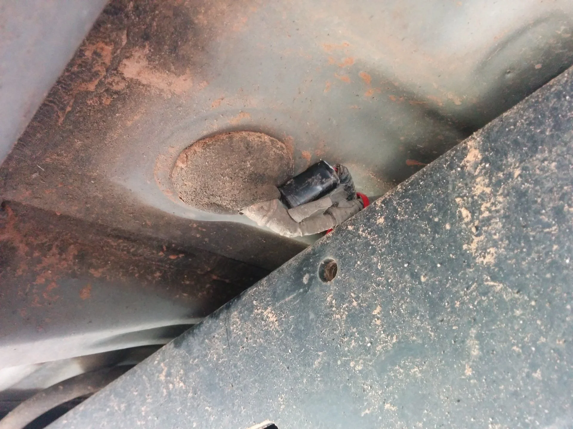

I will definitely add gussets to the legs once it is all where i want it. I will use 1/4" for the gussets because that is all my welder will do. I am also planning to add mounts for some rock lights to replace the lights that were in the running boards. Does anyone know where to get the factory plug so i can wire it like the factory?
Double quarter inch plates? I'm in the same boat, 110v welder. 🤙

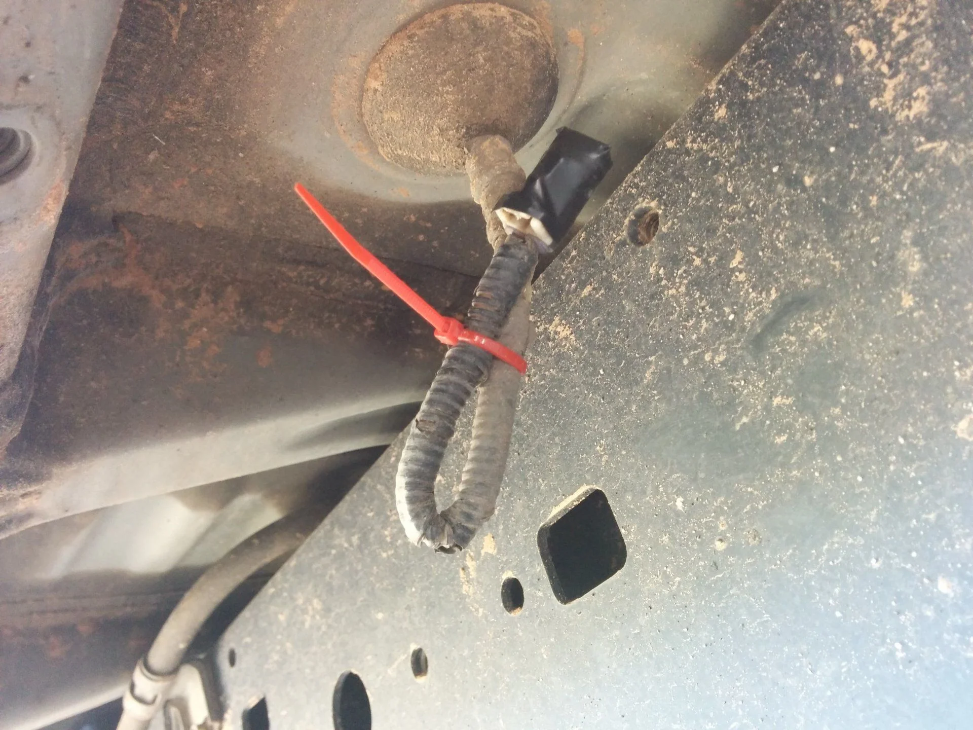

Factory running board lighting harness is about center of that frame rail, on top.... I just cable-tied and tucked it up for possible.later use.
