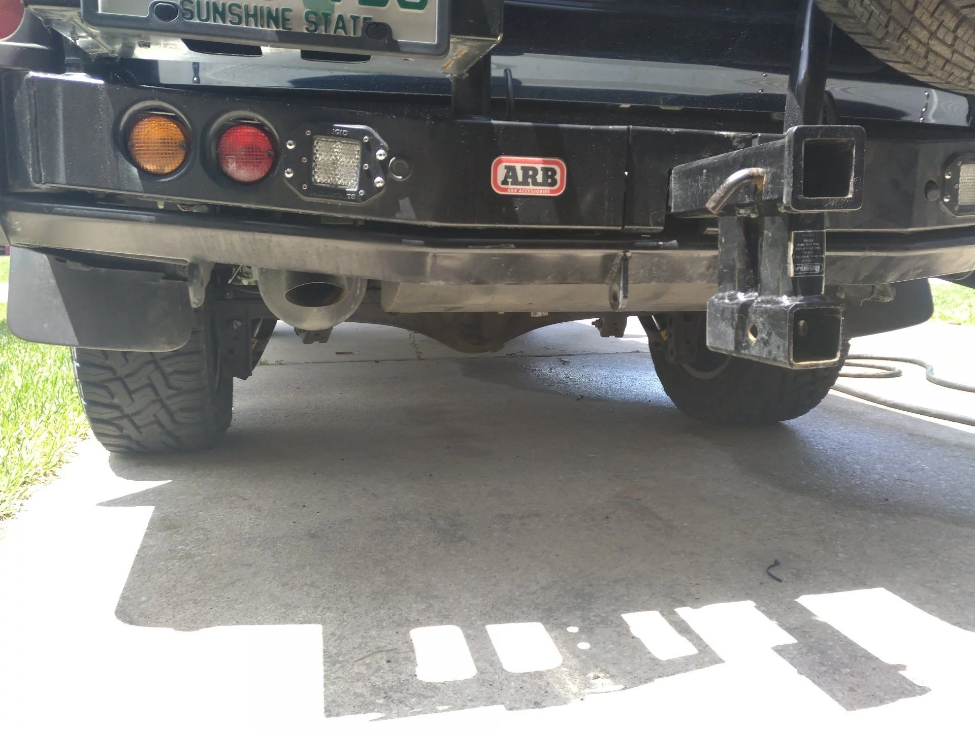

Would you mind posting a picture from behind your vehicle to show how this tank looks? Good to know about how it rides for you. We’re doing bags and springs as well so sounds like we won’t run into any issues with shifting weight. Have you ever encountered any clearance issues with yours?
Their bumper might make pictures from them less useful for you. There are plenty of pics of the 40gal tank on 200s online.. do some digging in google images. It does hang down on a 200 with stock bumper.
I have looked and seen. I was asking about theirs specifically as they have a swing out bumper and I have one on order.
edit to add I dig through their post history and found a suitable image. I’m new here and didn’t know each profile had a link for their posted media.

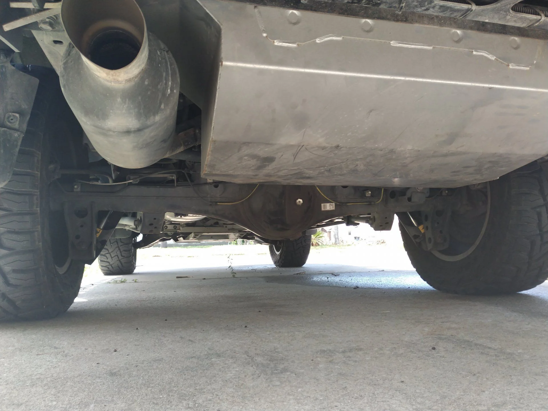

My comments would be the same as TERDRocket , it was not a hard job, and comes with good directions.
I think I got one of the first ones and put it in with a friend. It was not hard to do at all. If you can wire an offroad light, and read directions. A friend helps as the tank is heavy so friend and a floor jack, or two floor jacks.
I have never had shifting weight issues, or clearance issues.
The tank does sit straight my phone was angled.
It comes down to just about the same height as the resonator.
