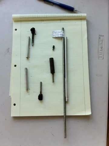

After looking around I settled on some thick wall 5/16" aluminum tubing, an all thread 1/4-20 rod, some 1/4-20 nuts, and some JB-Quick.
The first step was to cut off the linkage heads. The upper head was the one that twisted off at the connecting nut. I then cut down the 5/16" tube to a length that would provide a good contact patch for the heads as well as a sufficient length to tap for the threaded rod.

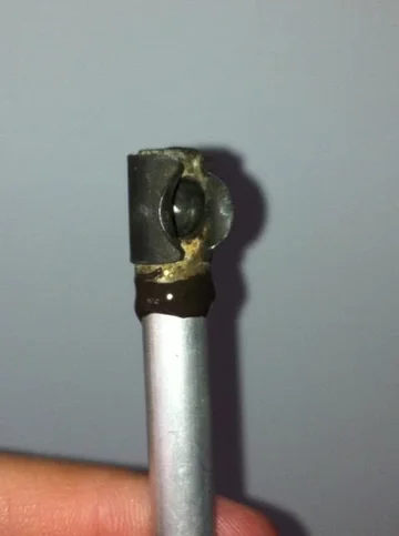

Next up was JB Welding the heads into the tube. I applied JB Weld inside the tube with a wood BBQ skewer, slid the head part way in, applied JB weld to the just below the top of the head, then pushed it the rest of the way in.

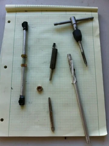

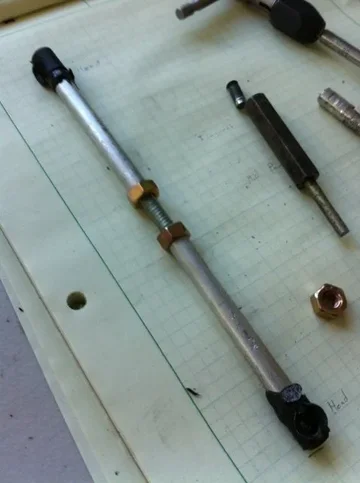

Once I let JB Weld dry, I used a 1/4-20 tap to put threads inside the tubes. After cleaning out the threads with a chase, I then test inserted the threaded rod. Once both new heads were cleared, I cut down a section of the threaded rod, added two nuts to lock everything down, and assembled the linkage.
This should give me about 1" of adjustment in that part of the linkage.
