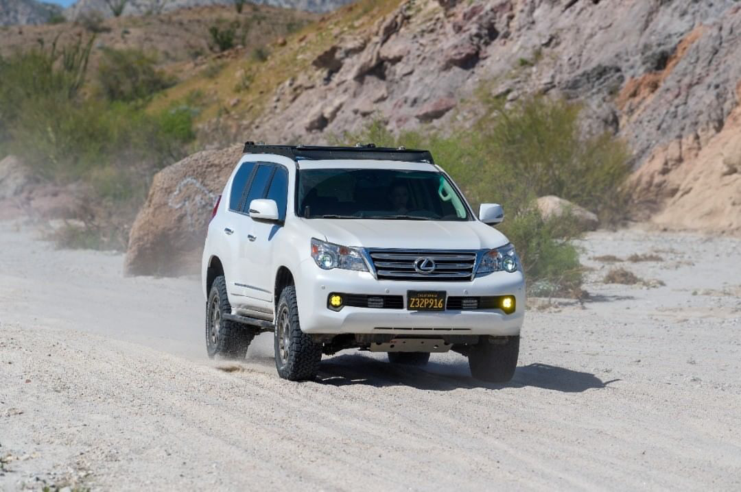

Interesting to see so many 460 owners running ditch lights. I've never liked the aesthetic (those Ronin's are pretty sleek, though) and could not justify a set, given how rarely I'm on a trail in the dark. Would love some feedback on how much better they are on trail over a set of decent fogs.
For example, I'm currently running a set of selective yellow Diode Dynamics fogs and a pair of Lightforce Striker LED rectangle "spots" stealth mounted behind my grille. What sort of visibility improvement do ditch lights provide? (I understand they angle out more)

since you have the pre-facelift bigger fogs i dont think the hood lights would do much more for you, with the 14+ the fog light is too small imo i tried first with an ssc1 but the output wasnt enough for me straight out. i wouldnt go hood lights with the full size fogs you currently have
Ditch lights are much better on the trail than a set of fogs. Front-mounted headlights/fog lights only project forward. It's very difficult to see what's coming up in the "ditch" area, off to the sides (where a light would blind oncoming motorists). I learned this the hard way when I was night wheeling - on a trail that I knew well at daytime - and slid off into a deep mudhole just to the right of my rig that I couldn't really see - and had to dig my GX out with a foxhole shovel :).
They're pretty handy too if you are driving in an area with a lot of deer/wildlife, as they light up the ditch/road area and allow you to see critters that your headlights really wouldn't catch. Also, they are good if you are driving on narrow roads with drop-offs at the side, as forward-mounted lights don't really cover that area either. My setup includes a set of $110 Cali Raised side-projecting pods, on $15 Amazon brackets, with a $22 CH4x4 switch where my Aux jack was, and $5 relay, so <$200 total considering spare wire/connectors/etc. I use mine maybe monthly and they've been a great mod.

I think the Ronin mounts are super cool and may switch to those, or add more lights with them because I can. I have the Baja Designs S2 wide/cornering lamps installed on my current hood brackets and they are angled like 45 degrees off to the side. Aside from the fog lights, a 2017 GX doesn't really need help with forward light. I have my ditch lights set up to illuminate the sides basically between the B pillar and the cutoff of the headlights.
Much of this choice was because I wanted some amber ditch lights so that everyone could see how hard I am trying, but being able to see out of the side windows on narrow, dim, and foggy trails has been nice.
