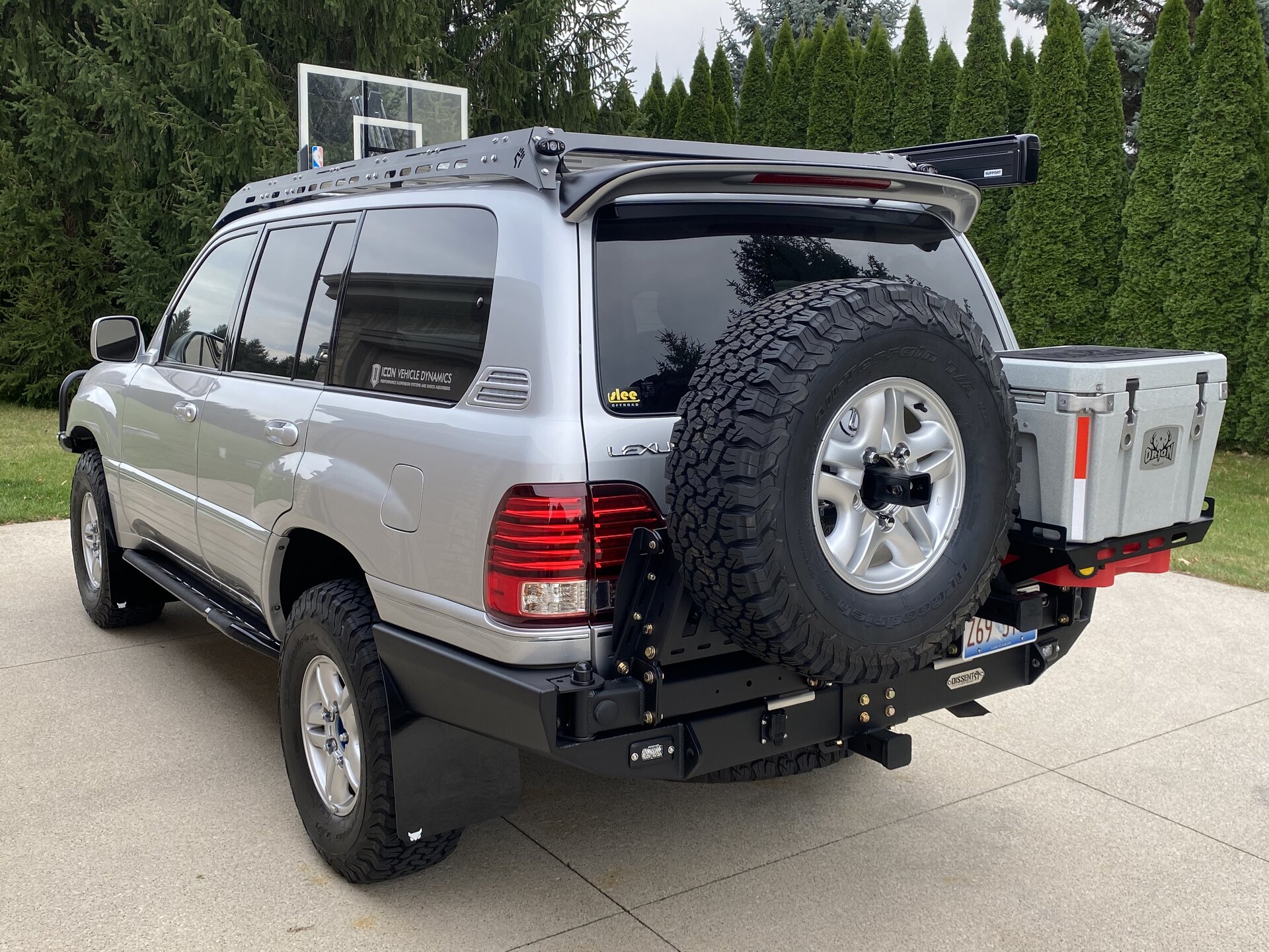

No idea. Here’s a pic.
You probably need to realign or adjust the swing arm then because the slam latch design is the easiest system to operate when installed correctly. Here's some videos that show the ease of operation and the alignment process.
well...this frustrates the hell out of me that these vids were not in existence during my install. I have no doubt that mine probably is mis-aligned.
what is not shown is the 90#-lb torquing. the smallish ratchet does not do justice to the large torque. You basically need a cheater bar on a beef torque wrentch to get the correct torque on the hinge housing mouning hardware. the larger equipment makes it pretty much impossible to get to the most hidden bolts where it becomes a guessing game w an open end wrench.
I guess I will be adding the re-alignment to my extensive to do list. not a happy camper.
I hate saying this about a valued vendor.....a great bumper, great customer service, sub-par assembly instructions.

I apologize if the instructions at time of your installation did not have what you needed! This is something we continue to improve on.
That being said if you are talking about the 4 bolts that attach the hinge bracket those are 50fp if I recall correctly Not 90. There are however several 1/2” bolts and m14 bolts that require 90fp and that is the case for any bumper that uses any of the factory bolt points. In reality these numbers are not extremely critical so long they are close but 90fp is less than the wheel lug torque specs and pretty simple to achieve with a standard 1/2” torque wrench.
If you need any help with getting things dialed we are just a phone call away and happy to help.
