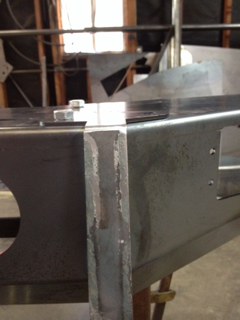

The front body mounts do allow a lot of movement on the 100 series along with most newer vehicles, that being said, the force and movement all depend on winch placement. This is one of the reasons I went with feet down and not feet forward.
Much less leverage on the mounting brackets. You will notice how low the winch sets to the frame horns.
Also on the frame brackets you will notice the side plates extend past the bottom of the frame about 1/2". This will help tremendously with load and force transfer!
I did a quick winch test on mine with a 12k winch. I blocked all 4 tires and and maxed a 12k winch out, no movement at all. This was on a straight pull mind you but a straight pull will tell you a lot about a winch bumper. If the is no movement on a straight pull this means the winch is in a good spot. If the bumper moves or twists on a straight pull the winch is too high. I have never had to re align one of my bumpers after a heavy pull.

Much less leverage on the mounting brackets. You will notice how low the winch sets to the frame horns. View attachment 1075441
Also on the frame brackets you will notice the side plates extend past the bottom of the frame about 1/2". This will help tremendously with load and force transfer! View attachment 1075447
I did a quick winch test on mine with a 12k winch. I blocked all 4 tires and and maxed a 12k winch out, no movement at all. This was on a straight pull mind you but a straight putt will tell you a lot about a winch bumper. If the is no movement on a straight pull this means the winch is in a good spot. If the bumper moves or twists on a straight pull the winch is too high. I have never had to re align one of my bumpers after a heavy pull.
Great stuff, Thanks! I do appreciate the winch placement being low and inline and if you've maxed it without movement on a straight pull that is a very good data point. I have also noticed the well placed bracing inside of the wings, strong and light don't have to be exclusive, good design can provide both.

My pleasure. Unfortunately I do not see very many winch action shots in the future. It's hard to get these things stuck:)
