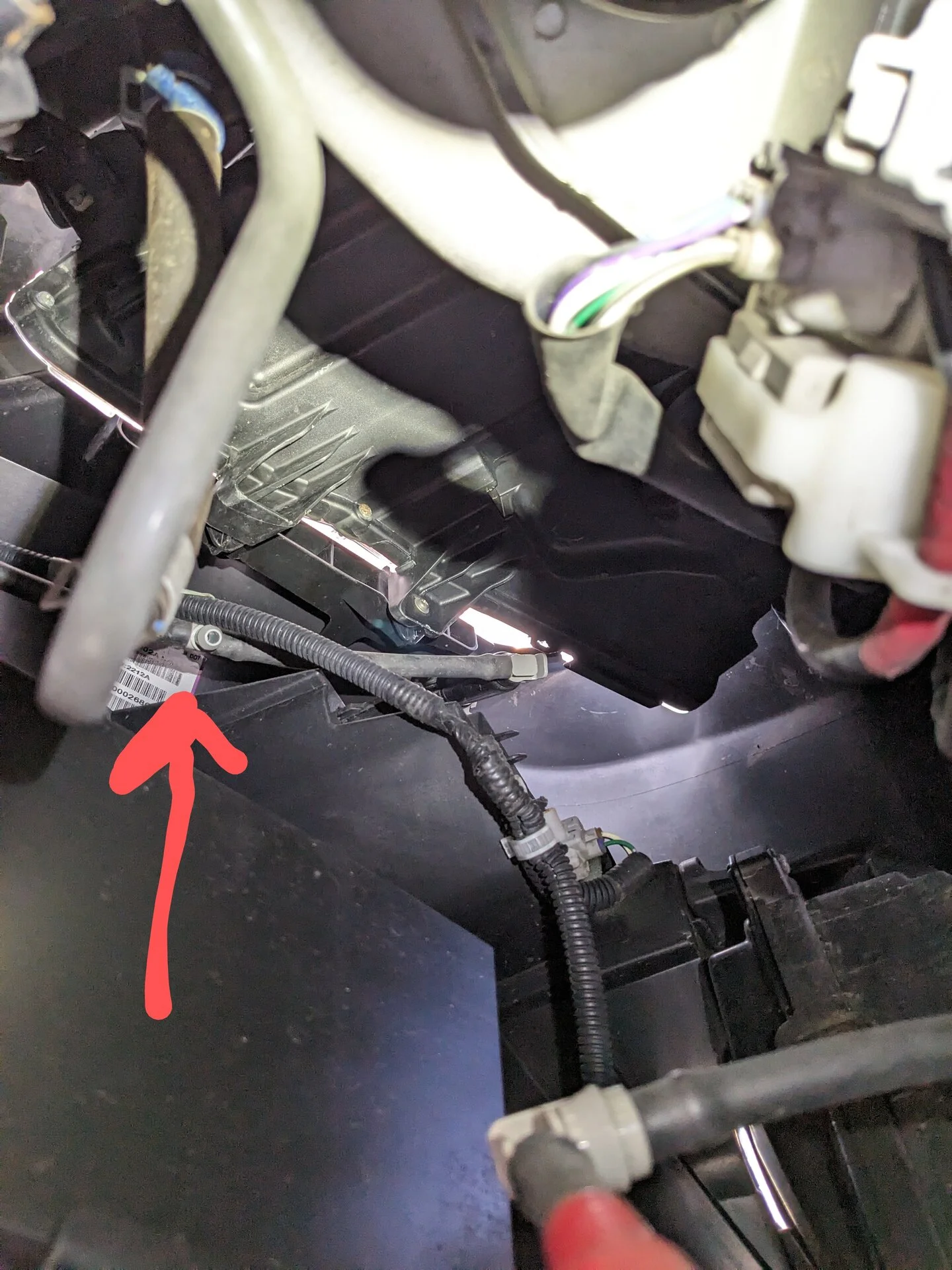

I just bought a jug of windshield wiper fluid to fill up with since the dash was saying I was low. I filled about a quarter of the jug, stopped and saw there were no leaks so I continue to fill the rest of the jug... until I noticed my garage flooded with blue!
I peaked underneath and I see this tube hanging down leaking onto the floor. I haven't done anything rough lately, but I did do another oil change 2 weeks back. So potentially I could have loosened something without noticing when putting the covers back on.
Does anyone know where to plug this line back in? I assume it's a quick reattachment but I didn't want to lie down in windshield wiper fluid to do it so I figured I'd ask the experts before heading back under there tomorrow when everything's dry.

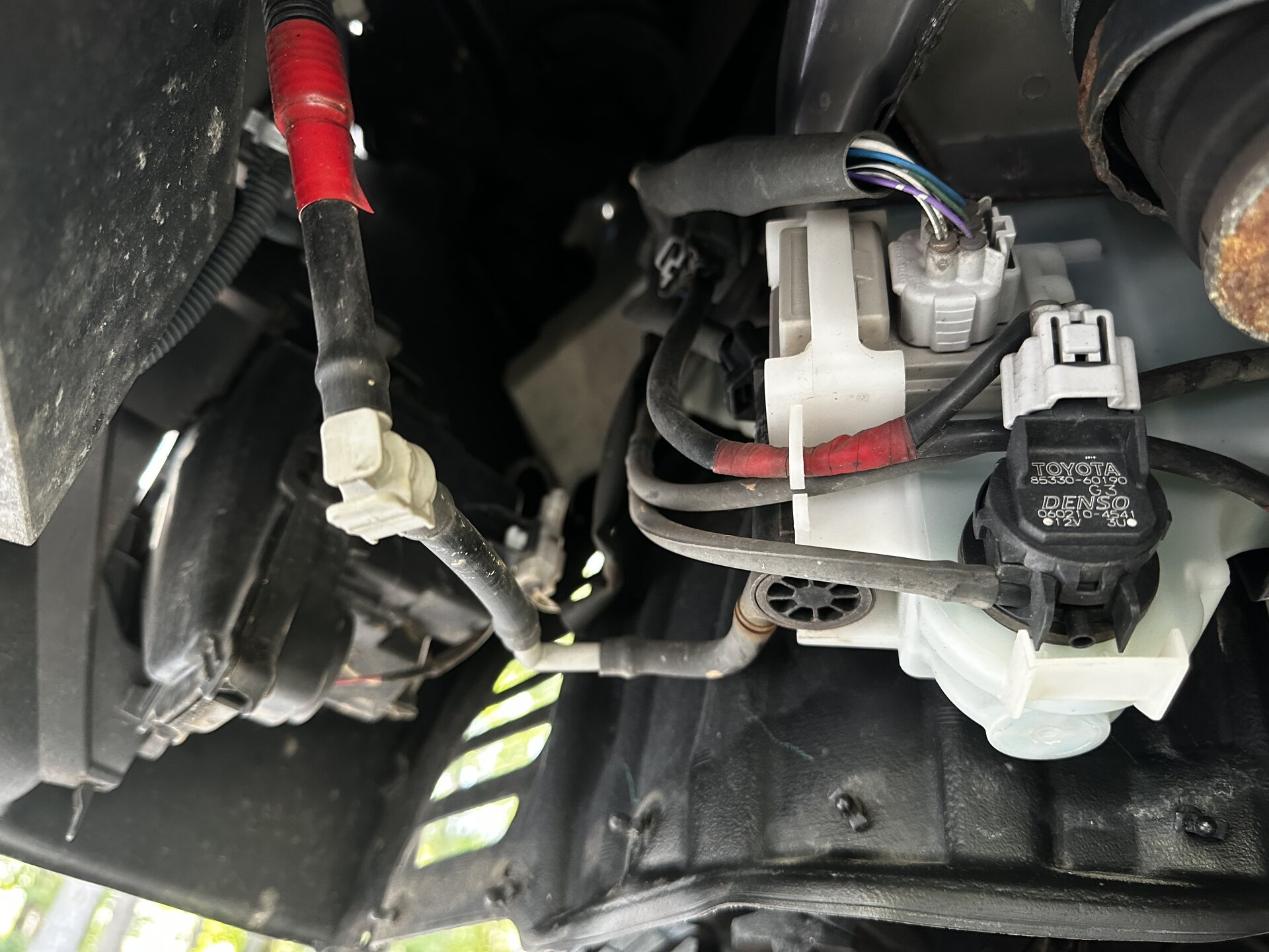

Here’s what mine looks like just from pictures I have on hand. The end that’s hanging down in your shot is above and out of view of this picture but should give you a good idea. Will be some sort of 90 or T up and forward of the washer pump assembly
Just a quick picture was very helpful to determine where to look for the open connection. Thank you all
Here it is in case this is helpful to someone in the future:
