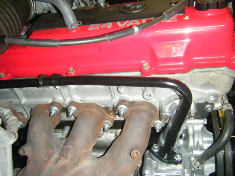

Can anyone tell me what the part number is or what truck came with the one piece heater pipe that is in this picture?:confused:
I have been searching but have come up with nothing. :bang: Thanks!
