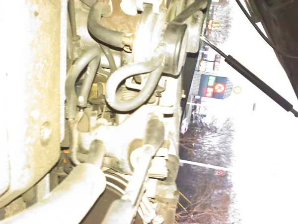

Did I re-route the vacuum lines correctly?
It looks like I have successfully disabled (or tricked) the temperature sensor. As far as the vacuum lines are concerned, does this look right? Thanks!
dude,
please turn the pic :D
