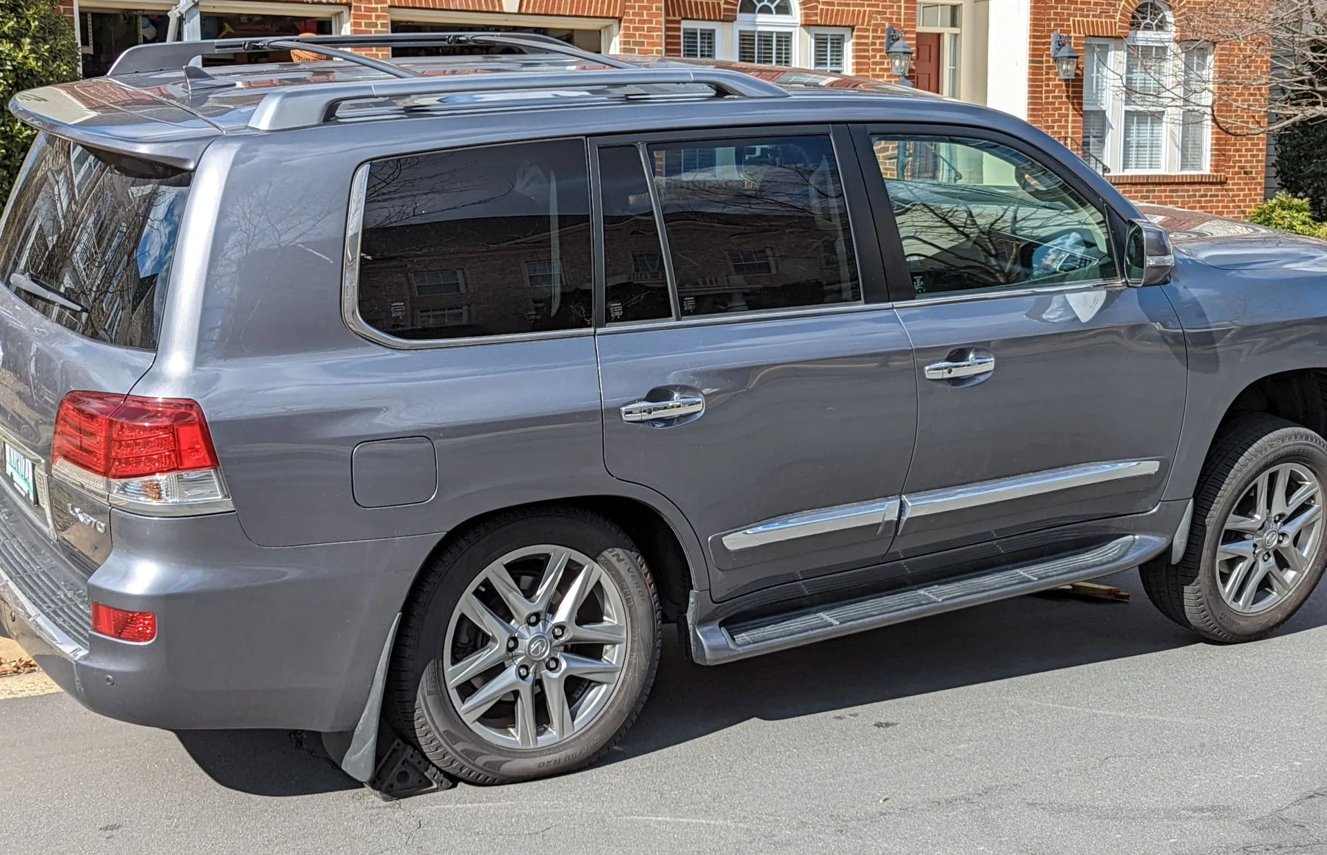

This is a 2016+, which has different rockers. The 08-15 fit is much better with cut rockers. At least I hope so, because mine get here tomorrow. Here’s some with 35s. Stolen from @TeCKis300
I missed what you were saying at first. The pic of the blue LX was a 2016 with different rocker, that's what you were saying. Good to know, will revisit Slee.

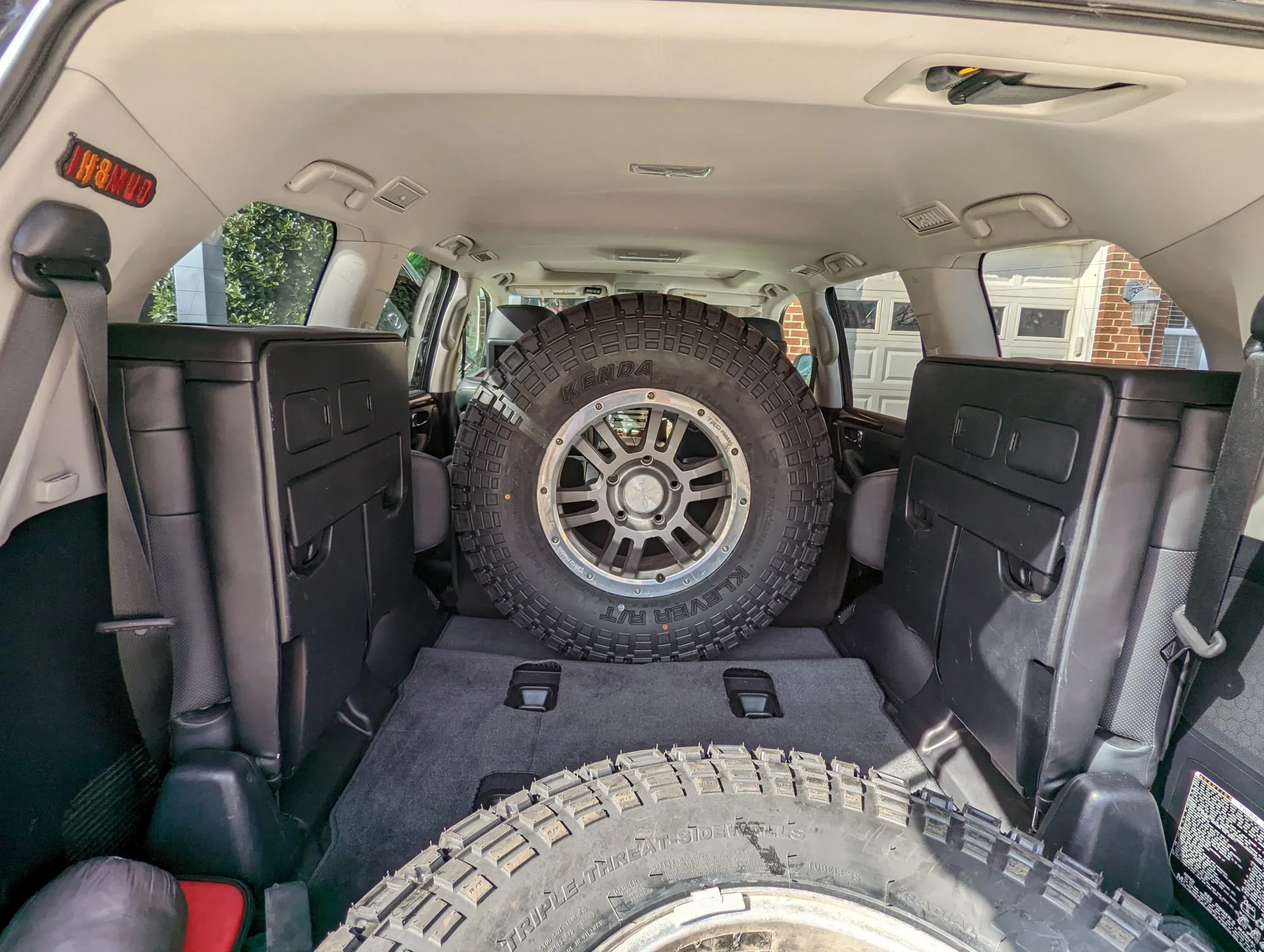

Edited just to add some pix of the tires mounted on the Rock Warriors. They are big.

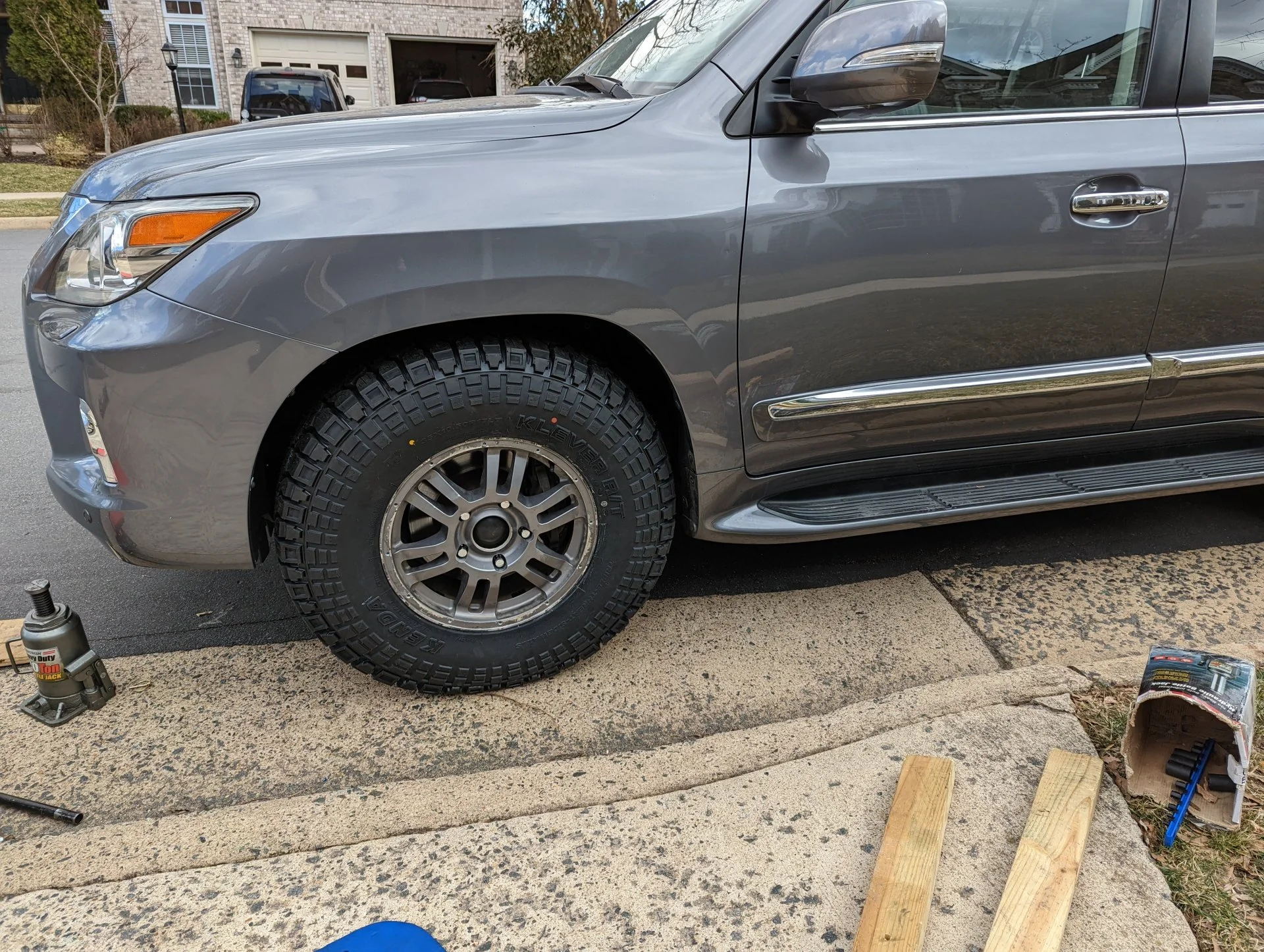

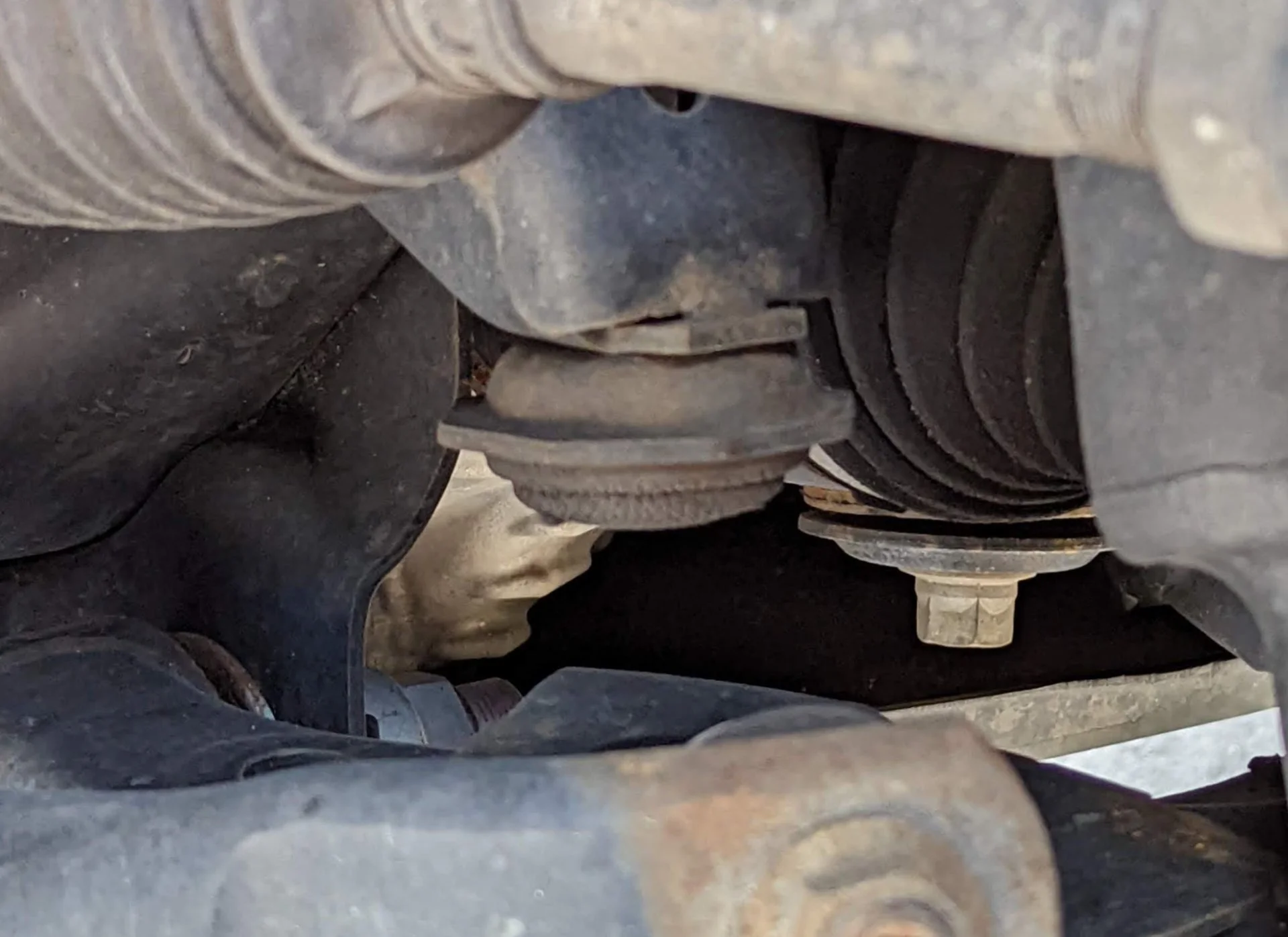

TEST FITTING THE 35X10.5R17s
So the TRD lug nuts showed up last night so I could finally do a test fitting.

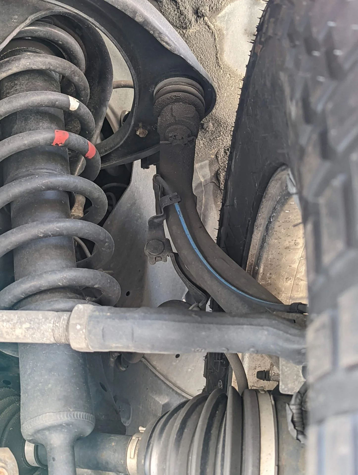

Full Droop (AHC High)
  • Wheels straight had 1.25-1.5" clearance to front and rear.
  • Full left, tire just hit the mud flap. For a test fit I just removed it, and ended up with about 1.5-1.75" of clearance, which was surprising.
  • Full right, tire just hits the front fender liner and the little flap, just barely.
  • Cleared the UCA
Ride height (approximate, AHC High), the results were roughly the same.

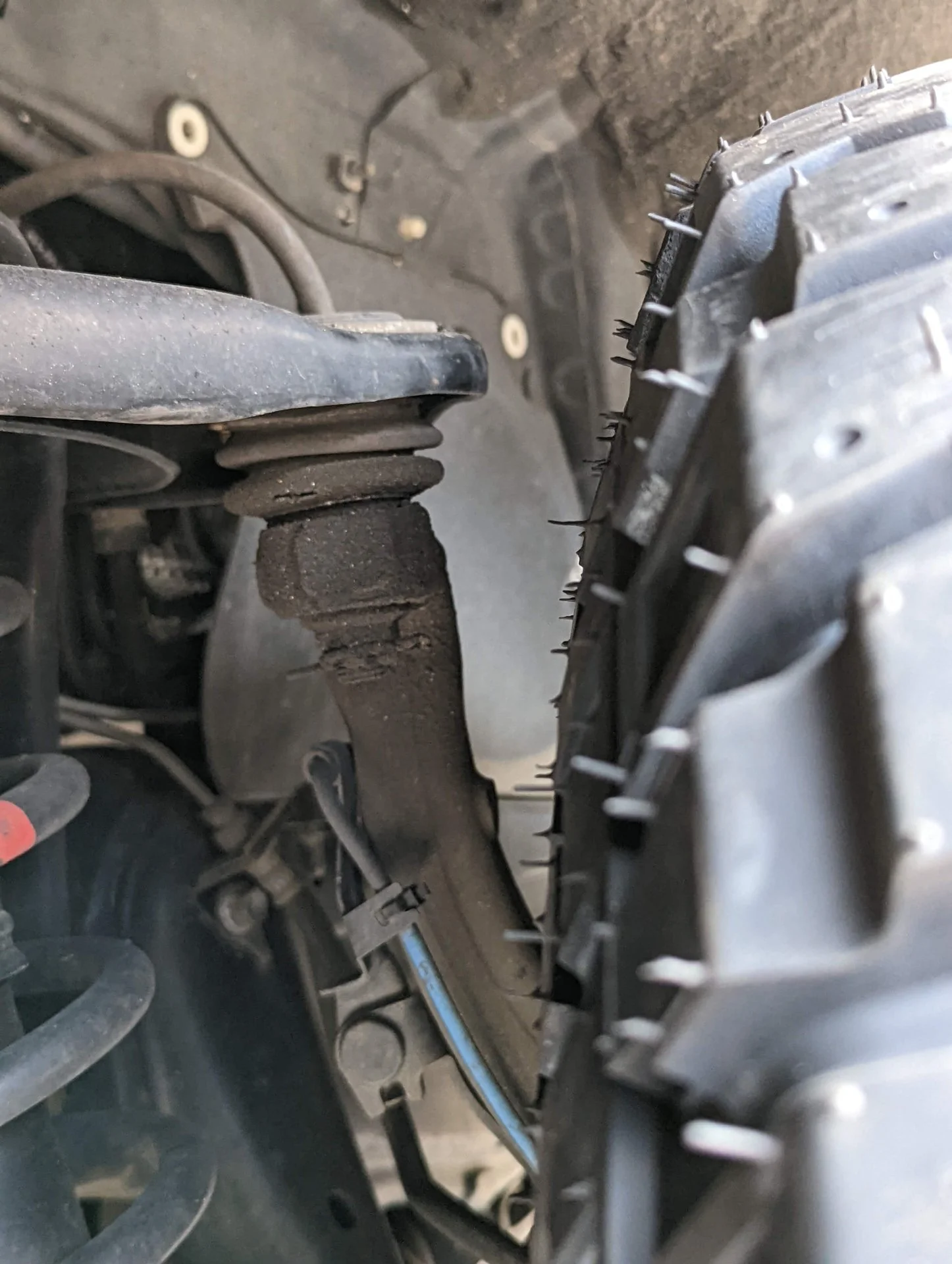

Max compression (AHC High)
The truck has so much flex, it was a bit of a pain in the behind. I had to jack it up, put a stand under it, then put the jack up on some boards to get more lift, rinse and repeat. Pretty cool though. This was with the suspension in High mode.
Clearance was about the same as at ride height from what I could tell: plenty of room at full left (w/o mud flap) and just touching front fender liner at full right. Cleared the UCA just fine

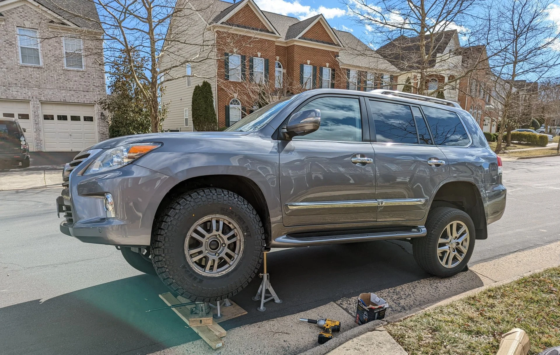

That was as high as I could get my jack to go, so I thought I'd see if it was any different in AHC Normal.
AHC Normal
I jacked up the driver front until I noticed that the passenger front had lifted as well! At this point there was a 13" difference in fender height. I still had the stock size tire on the passenger side, so if I had a 35 on that side, I might have been able to eek out a tiny bit more compression. At this point, the clearance situation appeared to be the same as before, i.e., just touching in the front, plenty of clearance with the mud flap removed.
I wouldn't quite call this "full stuff" though since it looked like the LCA was still an inch away from touching the bump stop. Maybe I'm doing something wrong, or maybe this was due to the sway bar. Maybe a Cruiser with KDSS might get a little more up travel.
So all in all, I think making the fender liner/mud flap adjustments to make this fit will be a one :banana: job. I see three options:
  1. Move the wheels rearward to clear the front fender liner, leave the mud flaps off (or trim where needed)
  2. Move the wheels forward to clear the mud flaps, and move the front fender liner a bit forward to create the necessary clearance
  3. Leave the wheels "as is" and do a little work to move the front liner forward and reshape or trip the mud flaps a tad as needed.
I will likely choose option 3, so I don't have to mess around with the alignment. I think the fender and mud flap work will be pretty minor.
So, I can say that the 35x10.5s will fit without a problem on an LX 570*!
* This isn't "fully stuffed" from what I can see, so I can't call this fully settled
* Might not be the same for a Land Cruiser; could be KDSS rub but I doubt it since the tire is a 267mm width equivalent. Might get more uptravel so would have to check that too.
* Let me know if I missed something!

You can undo the front liner clip at the base, move the clip up one hole toward the back, and put it back in. Documented a couple places on the forum; including in my build and linked of @TeCKis300 build.
That will fix the liner issue.
Front tire rear mud flaps I just removed, but there is some small space behind them to air gun back a small amount

Good "stuff" getting the tire fitted and it's looking beefy! I especially like your first pic with only the AT tire at the front. Such a contrast.
I'd highly encourage you to do #3, to keep alignment as the priority and handling as Toyota/Lexus intended. Most everything forward and back of the tire is plastics (at least to fit this tire size) that is easily massaged.
In regards to stuffing the front, as you're lifting the front end high, most of the weight will transfer to the back making it harder to stuff. Easiest way is to put AHC in low and try stuffing it again. I find that the tightest clearance against everything to be the situation where front is stuffed and at full lock. Take a look at the clearance between the tire shoulder and the upper UCA when in this position.
I wouldn't doubt AHC and believe KDSS will get you "more". Because AHC is the cross linking of KDSS at its core, but on steroids.
Looking forward to hearing you take her through some paces in the dirt.
