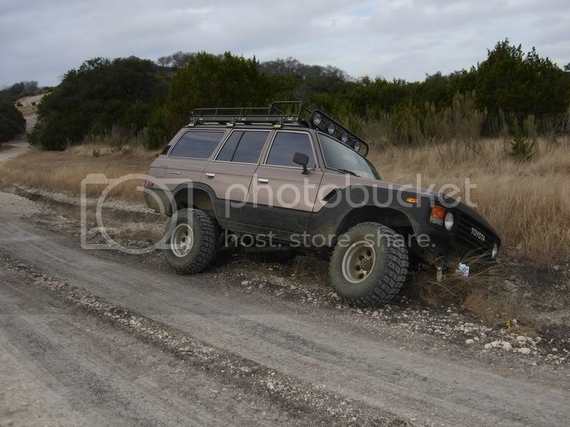

Figure I'll at least post up what I got myself into-
I meant to go off the road. what i wanted to do was drive over the ditch and straddle it, but the earth gave way to the awesome-ness above it :)
sweet looking rig. maybe next time a more direct approach would keep that from happening?...
it can make for good stories tho so its all good.
