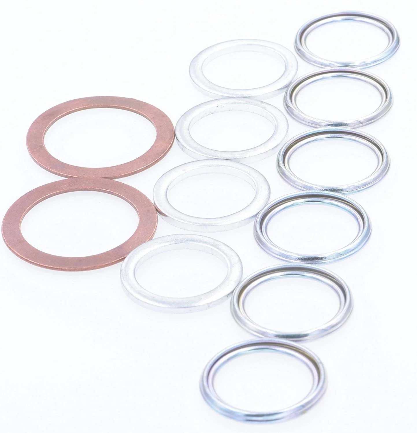

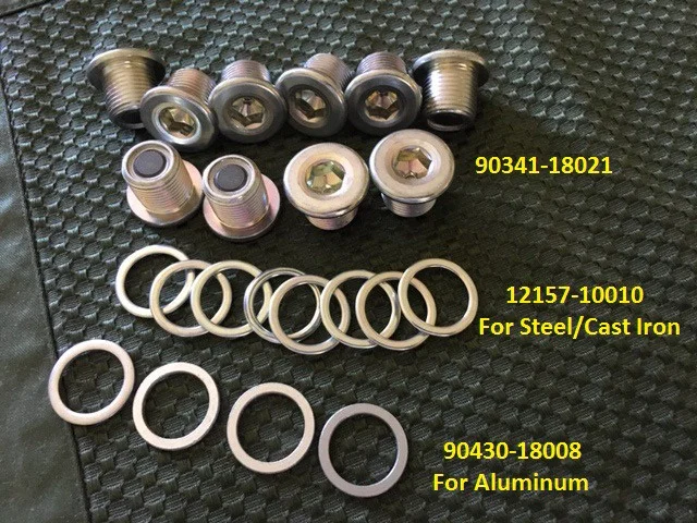

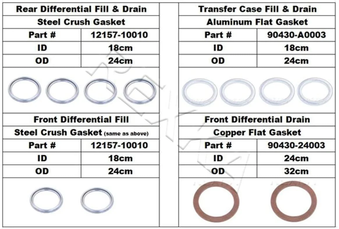

I am trying to order the correct crush washers for the Diffs, transfer case, and transmission before I flush them all. I thought they were all the steel 12157-10010 style, but now I'm seeing aluminum washers and copper ones as well. Is there a definitive list of the washer/gaskets for each component? I found an Amazon listing that seems to show the transfer case and diff's, but not the Transmission:

Is the front drain (steel) really different than the front fill (copper)?
Also, from what I can tell, the transmission drain plug and washer is item # 35106B on this pic, but it shows two different part numbers, the usual 12157-10010 and 35178-30010. Which is correct?

Does anyone have the part number(s) for the transfer case fill/drain plugs? I believe they're the same perhaps with the drain having a magnet? Or?
90341-18057 drain
90341-18006 fill
90430-18008 drain/fill crush washer
