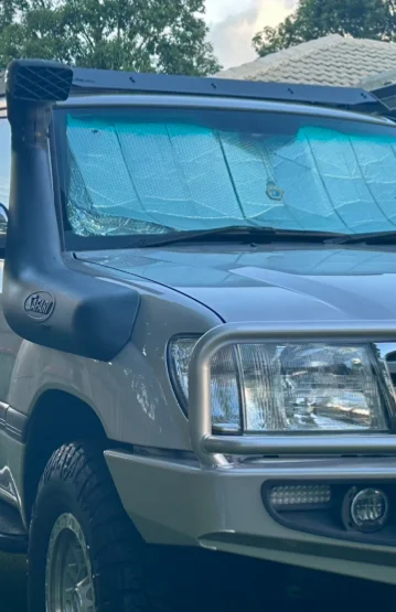

I’ve noticed a lot of your cruisers from the US and even the middle-east have really clear glass lenses compared to the ones we get here in Australia. They look a lot better. Wondering if they have a different part number so I can get a pair.

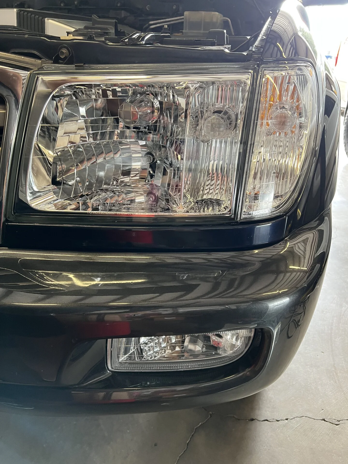

These are new OEM housings I purchased a couple of months ago, perfectly clear.
Housings
81059-60072
81019-60072
Corner lamps (Clear Euro/GCC market)
81511-60490
81521-60360
The bulbs you have in your original housings may be different.

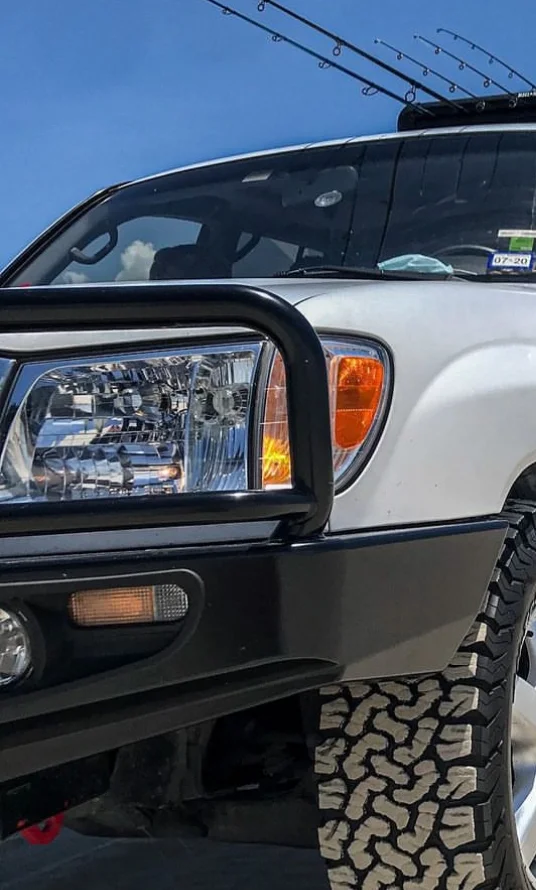

Different laws dictate different headlight designs. The AU/EU models have fluted lens, that shape the beam pattern, not the reflector bowl. The North American vehicles have clear lens, with a reflector that shapes the beam pattern. Given the 80's were built the same way, Toyota likely carried over the fluted optics to adapt to different markets with platform sharing to drive the cost down. I'd imagine Toyota developed what we have in North America to increase the curb appeal to buyers with their new "V8 IFS Land Cruiser" which was up against Range Rover, Cadillac, etc. I'm sure Federal Regulations, played a part in this difference as well.
FMVSS 108 in the United States dictates most vehicle headlight laws. I do not think a single new vehicle produced for the USA comes with Fluted lens that shape the beam pattern. We typically see those in pre-2000 passenger vehicles, or late 2000's work vehicles (Round or Rectangular headlights).
I'd imagine you could order from any country, as long as they are RHD for your market, and swap out for the clear lens.
