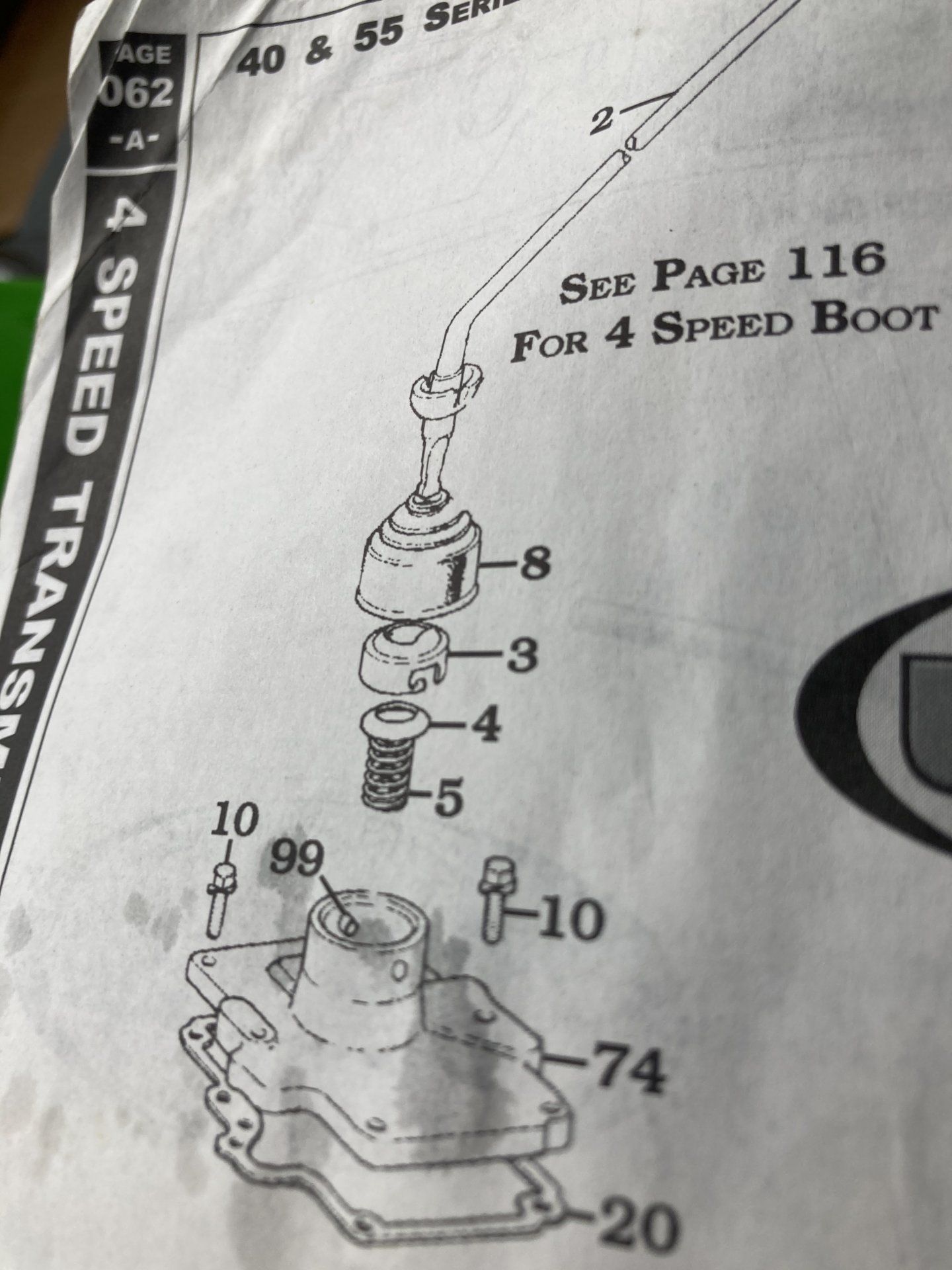

Hey,
Wanted to know what the difference between part numbers 3,4,and5 between a 4speed transmission shifter and a 3speed one. I hade my 4speed shifter power coated a year ago and don’t know where I placed the parts. I found part numbers 3 and 5 in my dads shop and took part number 4 off a 3speed. I tried to install the shifter yesterday with no luck. I had my dad try today thinking I was doing something wrong with no luck. He said it was going down far enough to turn it to stay in place. I believe all the parts listed or from a 3speed. Any help would be great. Thanks

I just looked at the springs I have from a three and a four speed. The three speed is a little longer. I have four speeds that turn both directions. I have been playing around will different shifter and besides being a pain in general to press and twist to remove makes it even harder not knowing which way to turn. Other that the spring think all the will work. The style changed in the eighties when the two piece shifter started on the 60 series. It no longer had piece #4 and #3 was no longer domed shaped.

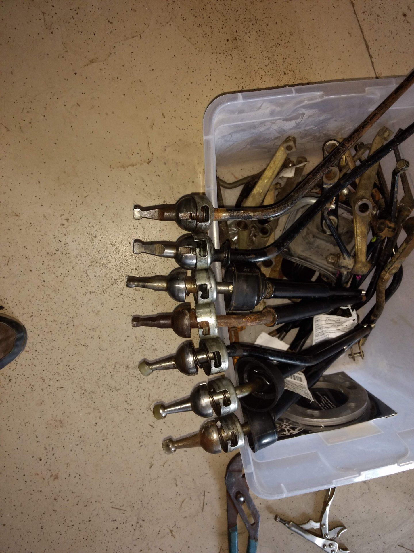

Only available loose three speed shifter I have is one that was cut off. Almost all my four and five speed shifters are at another location. May be a week or longer until I am around them.

Living in the Past, for your cut off shift lever, would you sell it, and if so does it include items 3, 4, and 5 in the drawing above, and if so how much $$$.

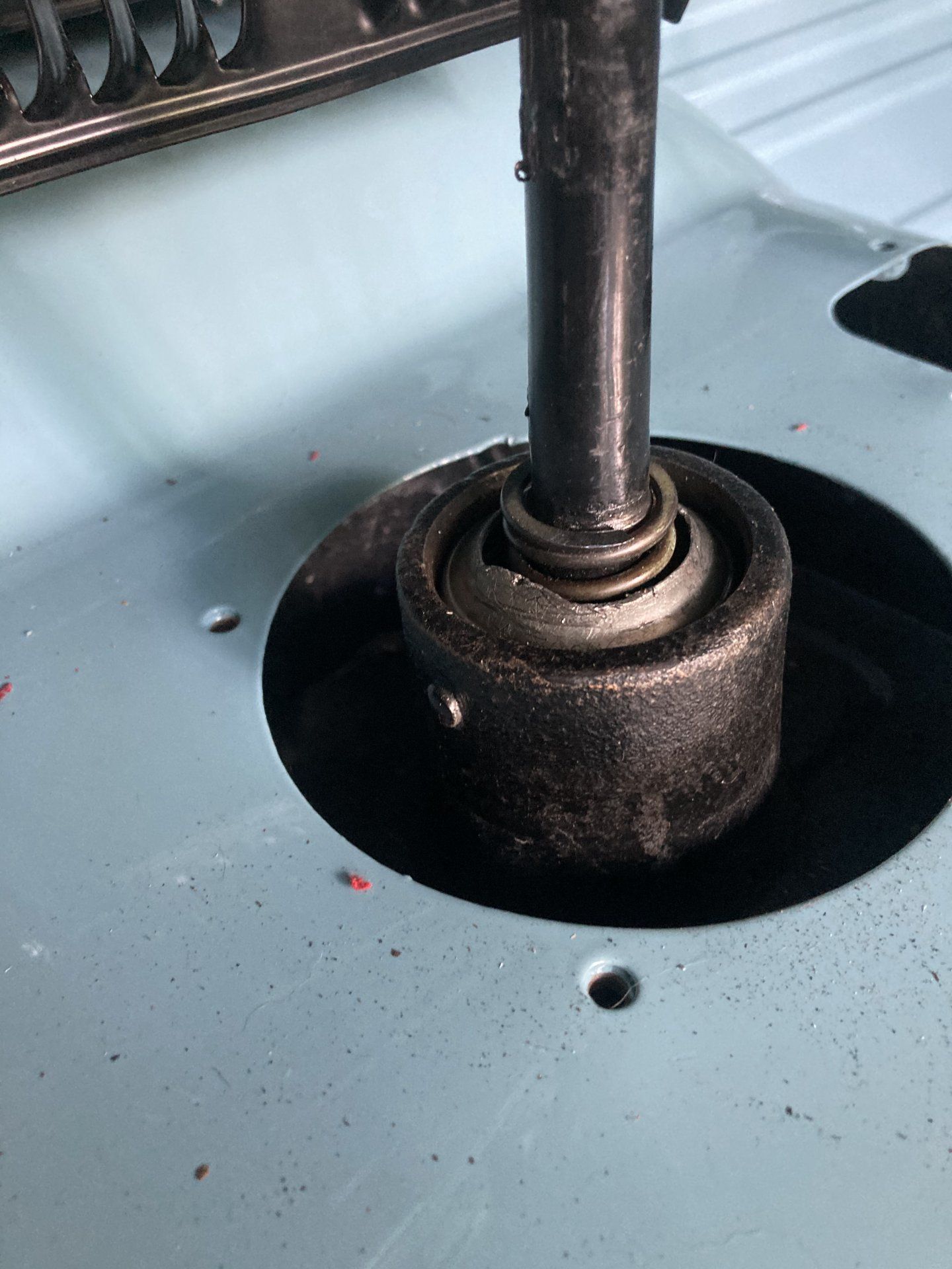

Thanks for the measurements! I was able to compare the spring that I had with two other springs. The 3speed was taller as mentioned. The spring I was originally was using was a 4speed. My dad and I was having a hard time getting it pressed down far enough to turn the cap to hold it in place.
We finally was able to make it happen. We end up pressing it down by having a closed in wrench and some vise grip above wrench to lock it down. After that we dropped in the shifter into the transmission and tapped the cap with a hammer and screwdriver until it turned as far as it could go.

Didnt know you were looking Jim. Plenty local. :)
I have a couple 3speed shifters. One has all the item numbers above. Let me know if your interested. Thanks
