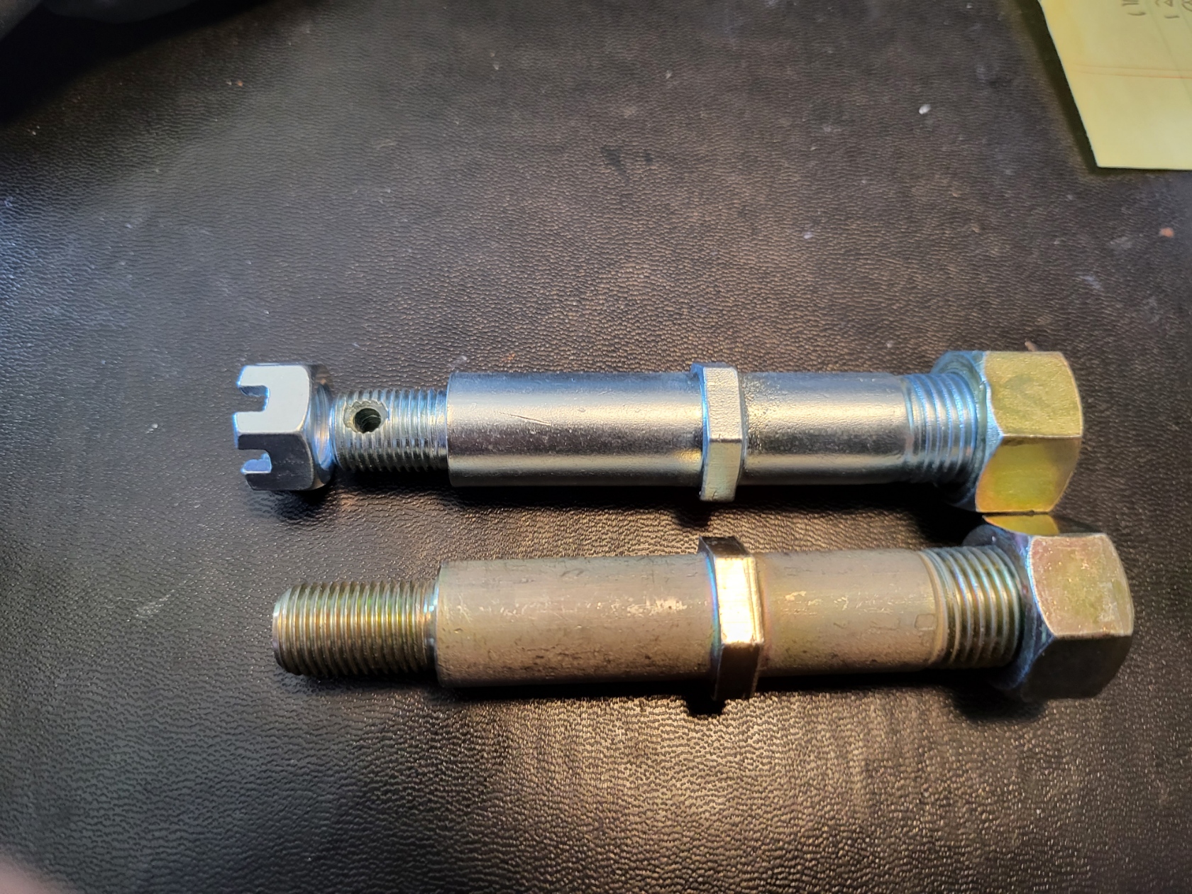

I am pretty sure the newer ones do not have the cotter pin hole, if I am talking about the same pins. Silver one is front off a 1974 FJ40 and yellow cad is new one
Diameters measure the same, the newer one is longer on the threads only, possible to add lock washer and/or locking nut,
Not sure if this helps....
