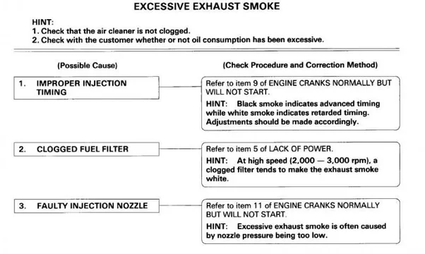

This comes from Toyota:
And:
Mr Yota missed a few other possible causes. :smokin:
Very true John.
(I just threw that in because I thought the stuff on "injection timing" and "choked fuel filter" was interesting - Particularly since it was coming from Toyota themselves.)
