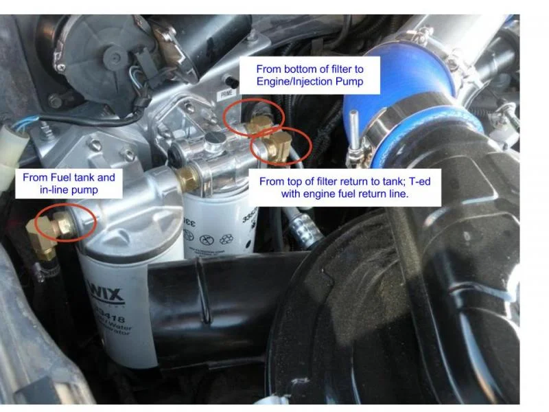

Yeah mine had a butchered 350 conversion when I got it and the canister was already gone. If you look on page 4 post 66, you will see the double filter system that I built to remove water and air and particulate from the fuel system. I added an electric fuel pump in between the tank and the filters to assist in the filtration and because the system returns the aerated fuel back to the tank, it needs some pressure on it all the time to assure the lift pump on the injection pump doesn't run out of a fuel supply.

I am working through your filter system and I wanted to make sure that I got it right; is the attached image correct?
Also, how do you have the pump electrically setup? I understand the momentary switch, but how does it make sure there isnt too much fuel being pumped? Is that taken care of by the return out of the water separator and the engine fuel pump limits the flow?

Hi Mitch,
You are dead on with all your line layouts and the fact that the excess electric pump pressure is just diverted back to the tank through the return line. The only thing that I could add is that I made the inlet and outlet fittings all 1/4" and the return line fitting I made 1/8" to create a positive pressure to the lift pump and a lesser pressure returning to the tank.
The electric pump is wired on its own circuit that comes off the ignition key and the prime button is direct wired to the battery so I can prime anytime whether the ignition is on or off.
