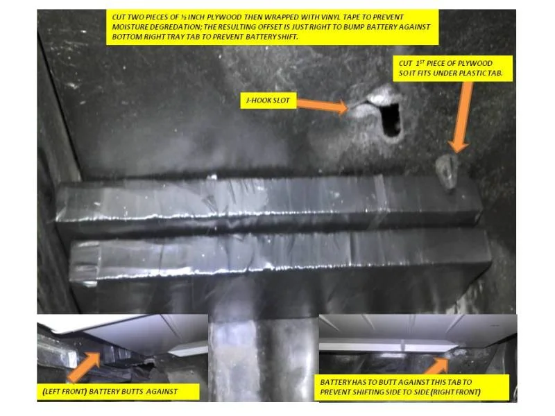

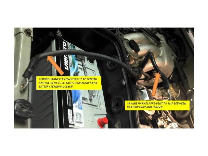

Hi to all!! This is our ( my son and I) first post of our first project.

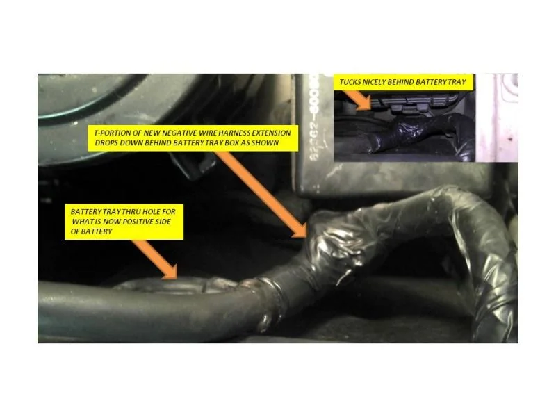

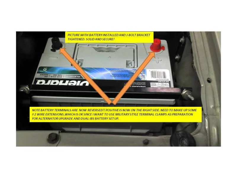

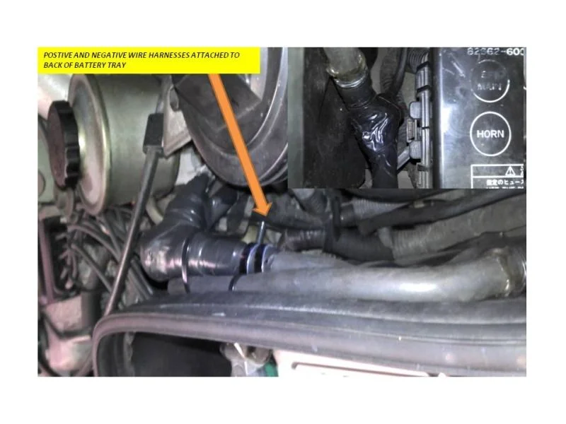

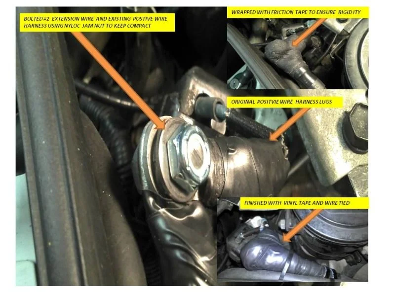

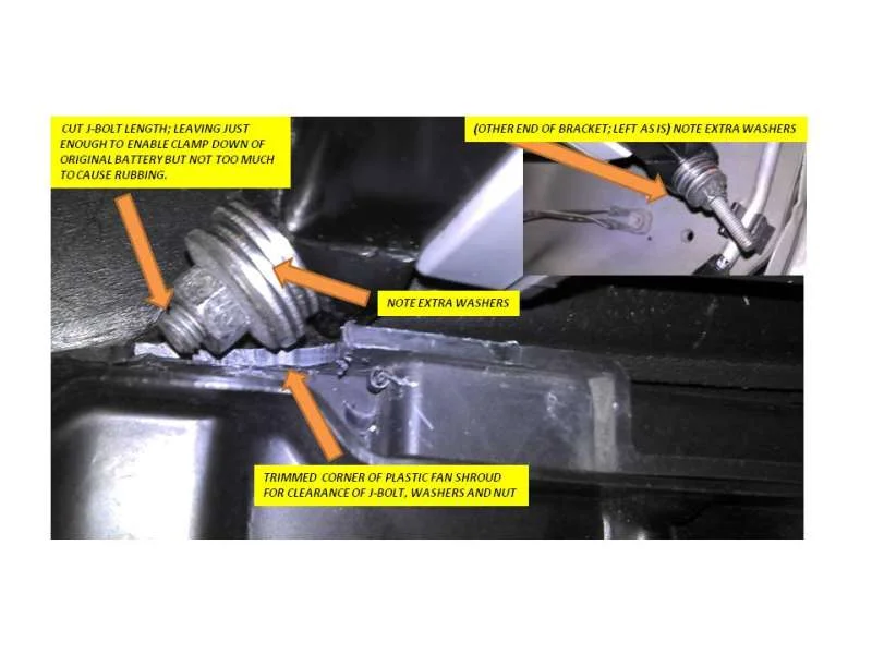

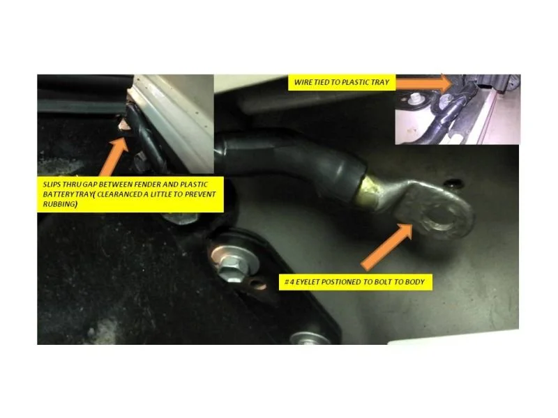

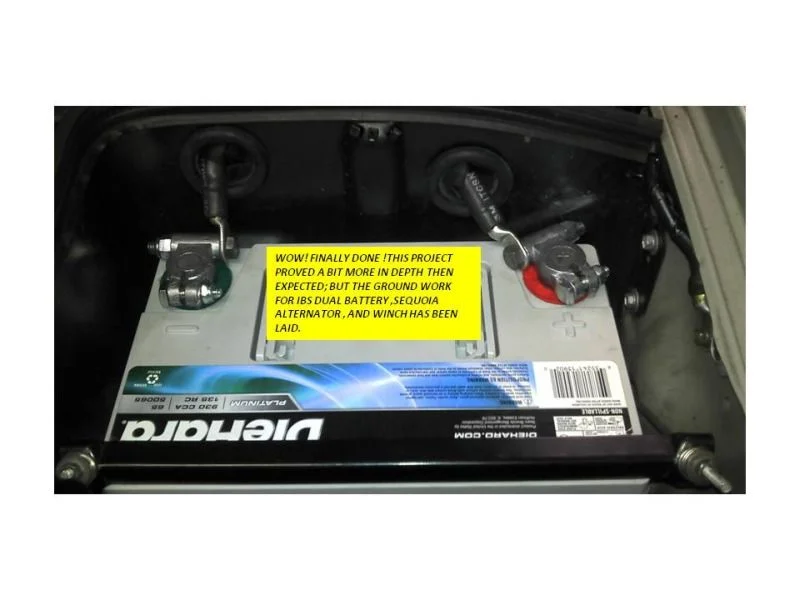

It turned out to be more work then expected; yet was fun. We decided to go with Sears Die Hard because well we have always had great luck with this battery. We opted for the 935 CCA Platinum series (GEL) battery. Unfortunately, that meant some problems. Mainly the battery is considerably shorter and the terminals are reversed so some minor fabrication and alteration was necessary. Overall we are happy with the result; she cranks over really well now! We've made up some pics detailing the project. (Hope this works
