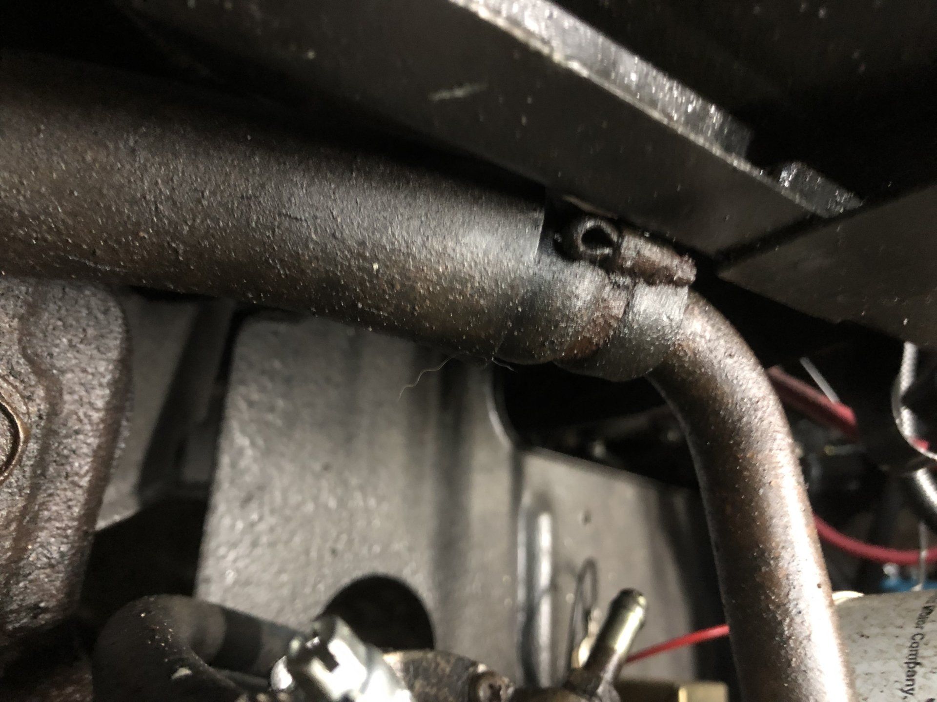

Did you see this one too?
That's a lot of leaks.

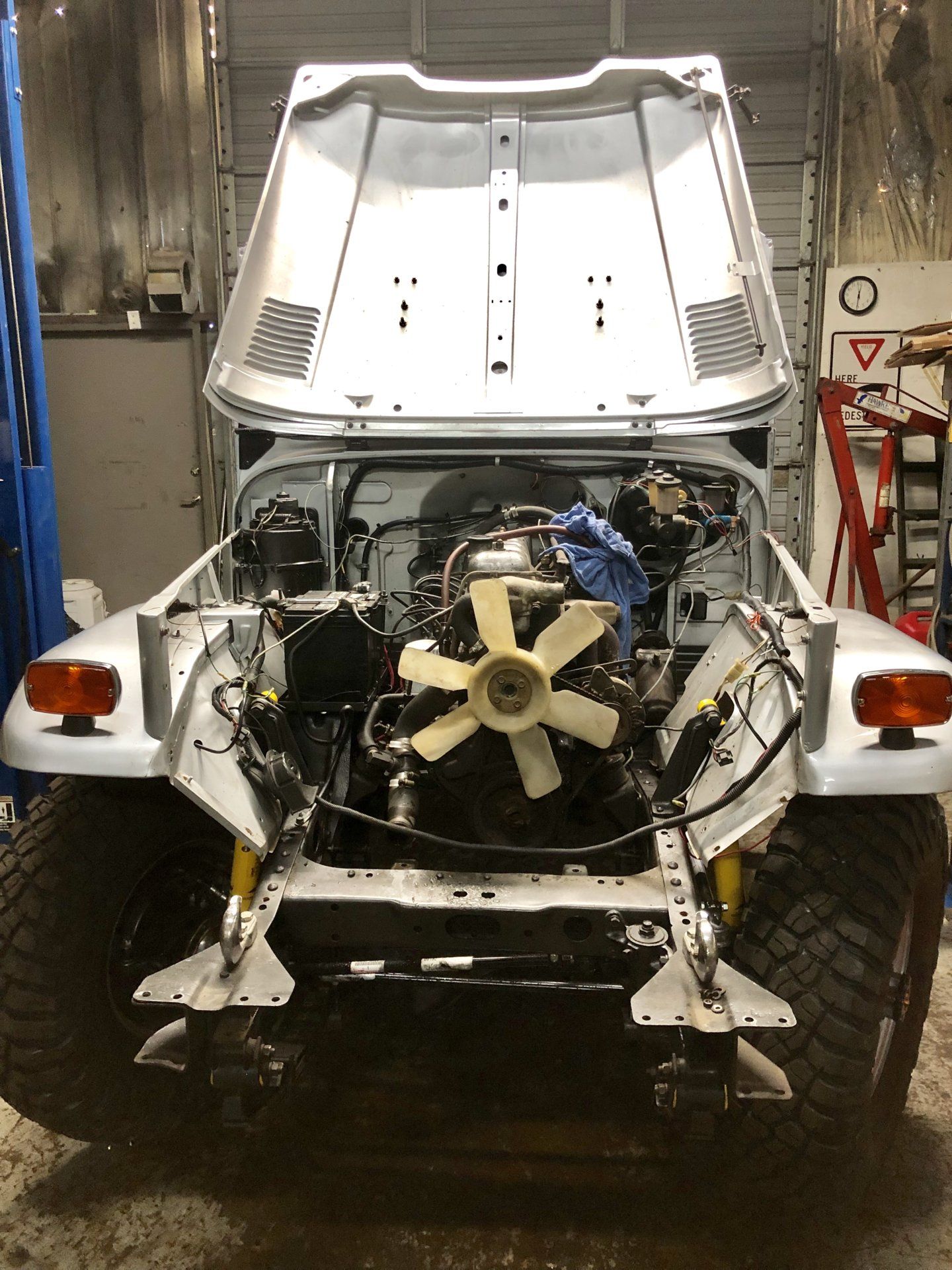

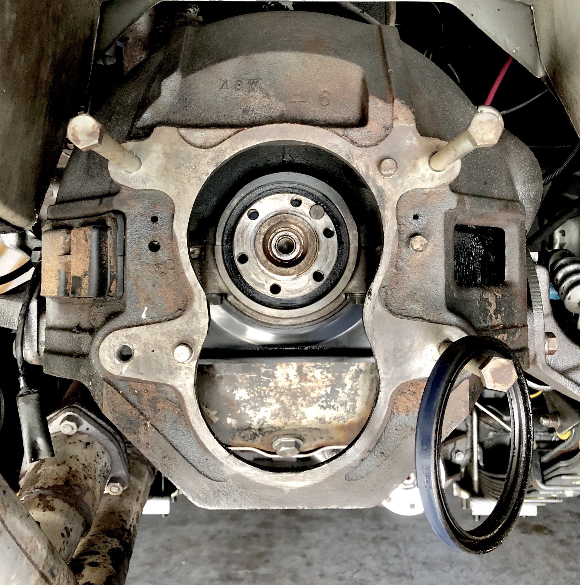

Eating the elephant one bite at a time. I should have the leaks all at bay sooner than later. New rear main seal and pilot bearing going in.

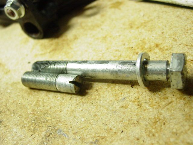

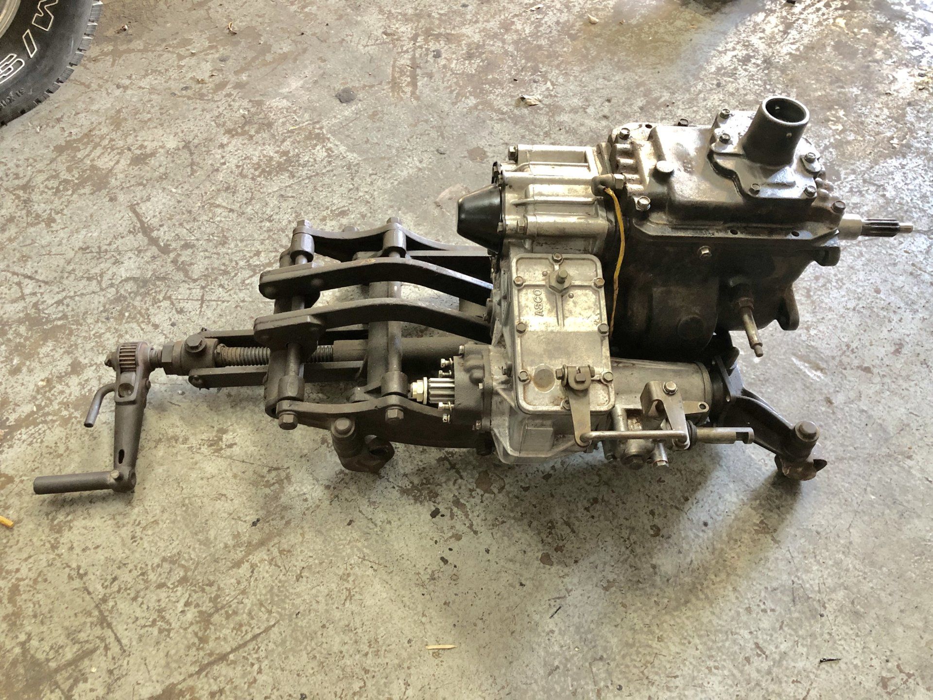

Note 60 steering box bolts on the bellhousing. I’ll cut the heads off and use them as dowels to slide the trans into place, then swap them for bolts. It makes stabbing the trans a breeze.

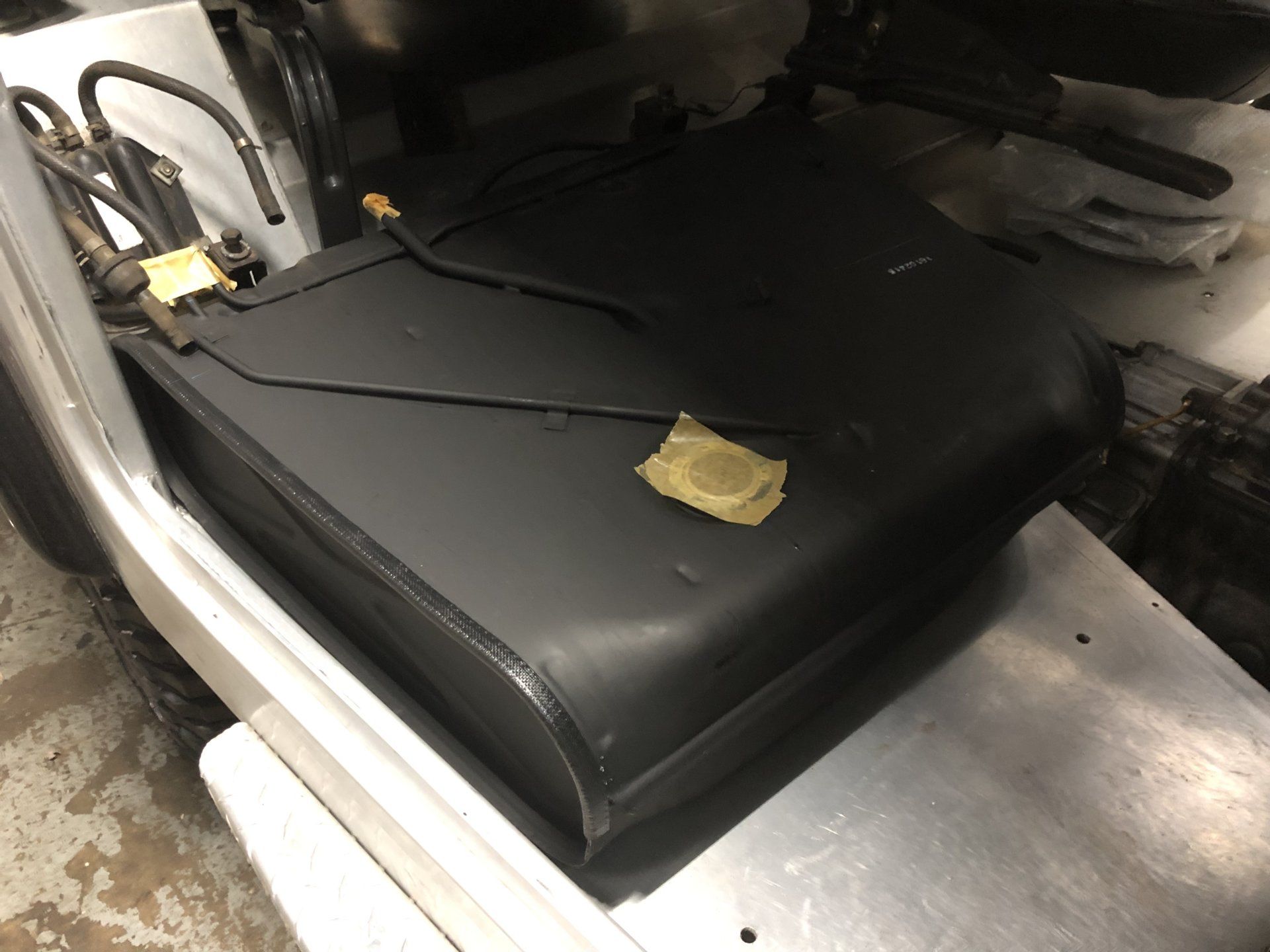

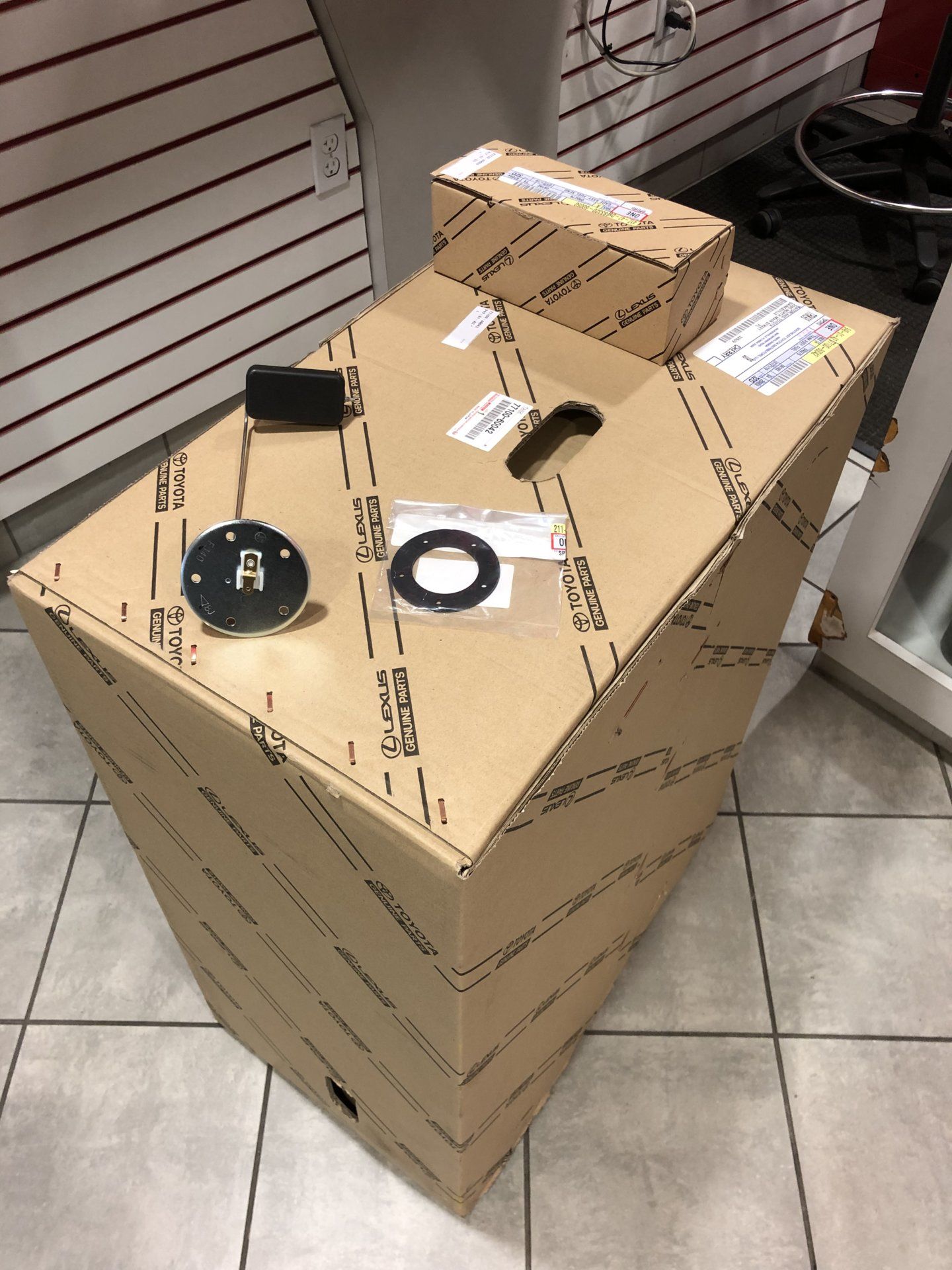

I believe old tank and radiator were painted during the “resto” but not serviced. I’m replacing them both with new Oem Toyota.

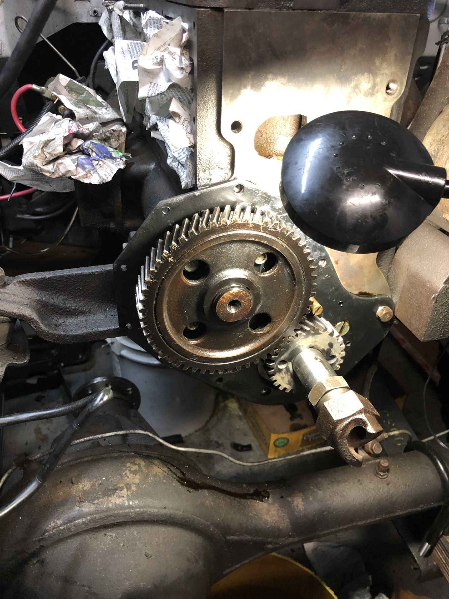

Thanks to my pal Gunnar (GP AUTO) for helping replace the timing plate gasket. #25
