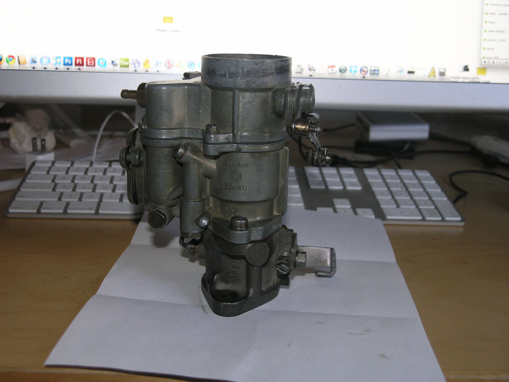

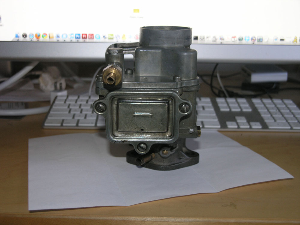

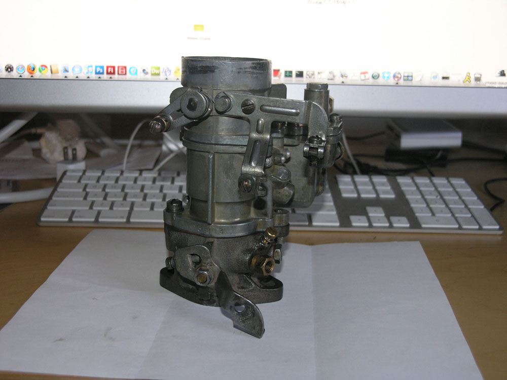

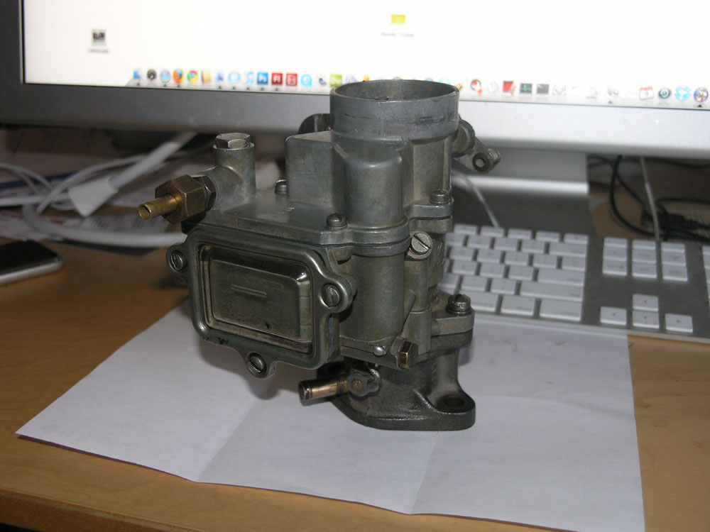

Just got my carb back form Mark's offroad :)
Booya thanks Mark!
ok back to work :)
Need to make some svn updates before everyone in tokyo wakes up :D
had to add the carb with out the riser...
The right stud was shorter than the left ( driver side bolt was longer )
So no way the riser would have worked unless i replaced the stud :(
Will things be ok with out the riser? Will be using the old PCV that was in the lower throttle body...

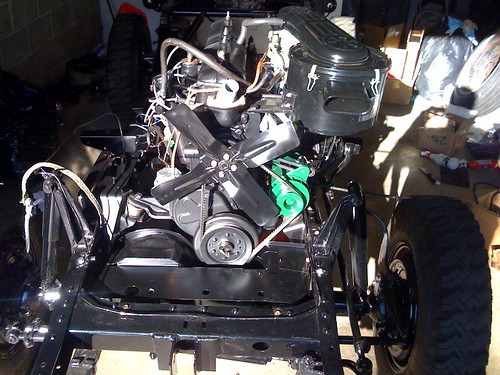

Got the parts back from the powder coater.
How tight should the fan belt be tension wise?
It is tight enough now if i turn the fan everything turns over properly...
Will replace the thermostat and housing when they arrive from Mark :D

Two things I would be concerned about. One that piece would help insulate the carb from the intake manifold. The carb was warped once already. Second wouldn't the carb be too low for a good fit to the air cleaner? If it were me I would try hard to find one. If the port that's drilled is threaded you can always use a plug there.

So i would need to find a long manifold stud/ bolt with threads for one of the carb bolts...
( one is too short for the riser to fit , likely had been replaced )
Is it though to remove the carb bolt stud and replace it?
How do you even go about doing that?
Mark hooked me up with a riser, It is just the matter of the manifold bolt being too short on the side facing the passenger.
the heat riser was stuck closed before as well ( not anymore )
But if the riser is needed i definitely want to put it on if it will cause warpage again...
r08uC
Is it tuff to remove the carb bolt stud and replace it?
I haven't had to remove the studs from the F135 cast intake manifold but the way I remove studs is to double the stud with two nuts then remove the stud by using the bottom nut. The trick is knowing when to back off before breaking the stud off. A little heat might help.
