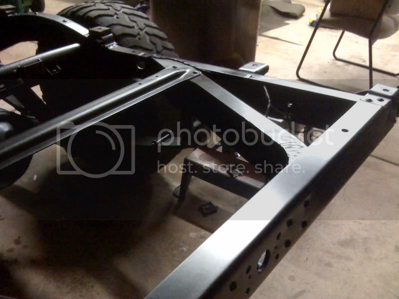

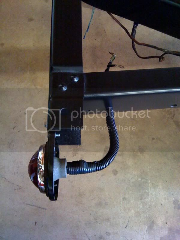

I know this was in my thread showing my tail-light, but my entire frame looks like that:
....so as you can see it flows out nice.

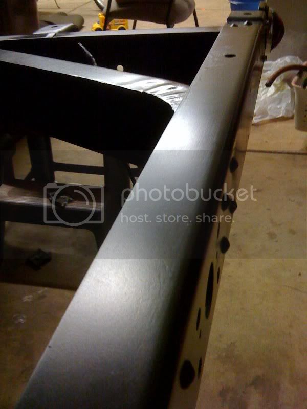

I ran out and took two more pictures for you of my frame up close.
and...
again, the brush strokes flow out well enough for a frame. If you look really close in the top of the 2nd photo you can "kinda" see some.
Spraying would be choice, but I wanted it THICK on there, and I still had my engine and brake lines, and exhaust attached....so brushing worked well. I'll let you be the judge I guess.

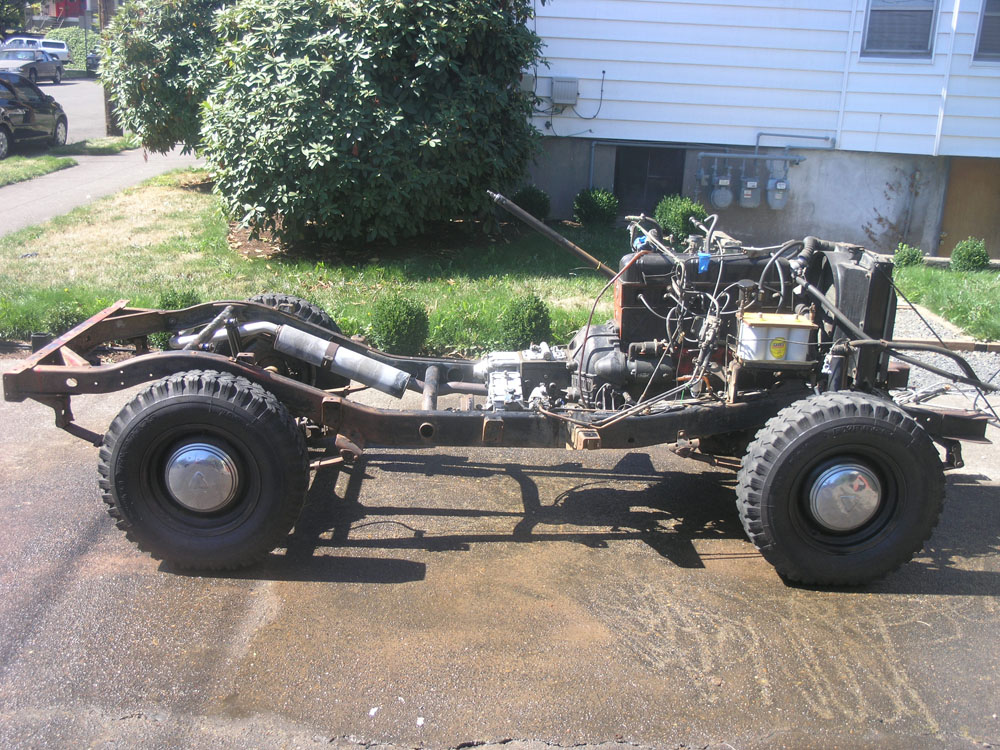

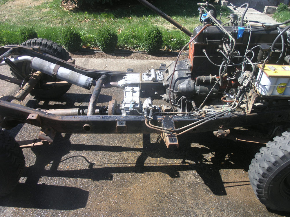

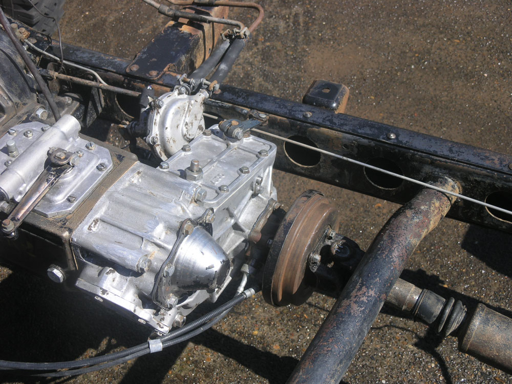

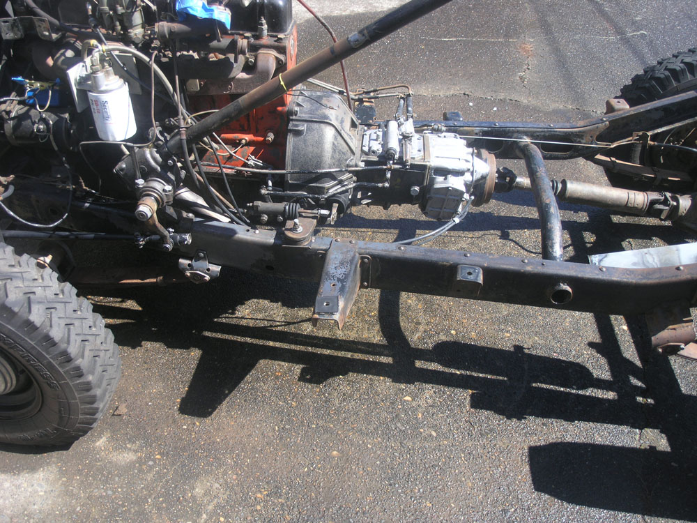

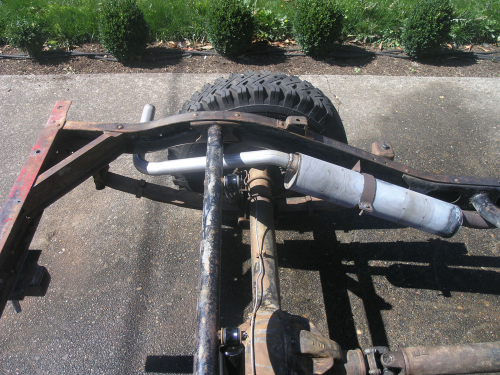

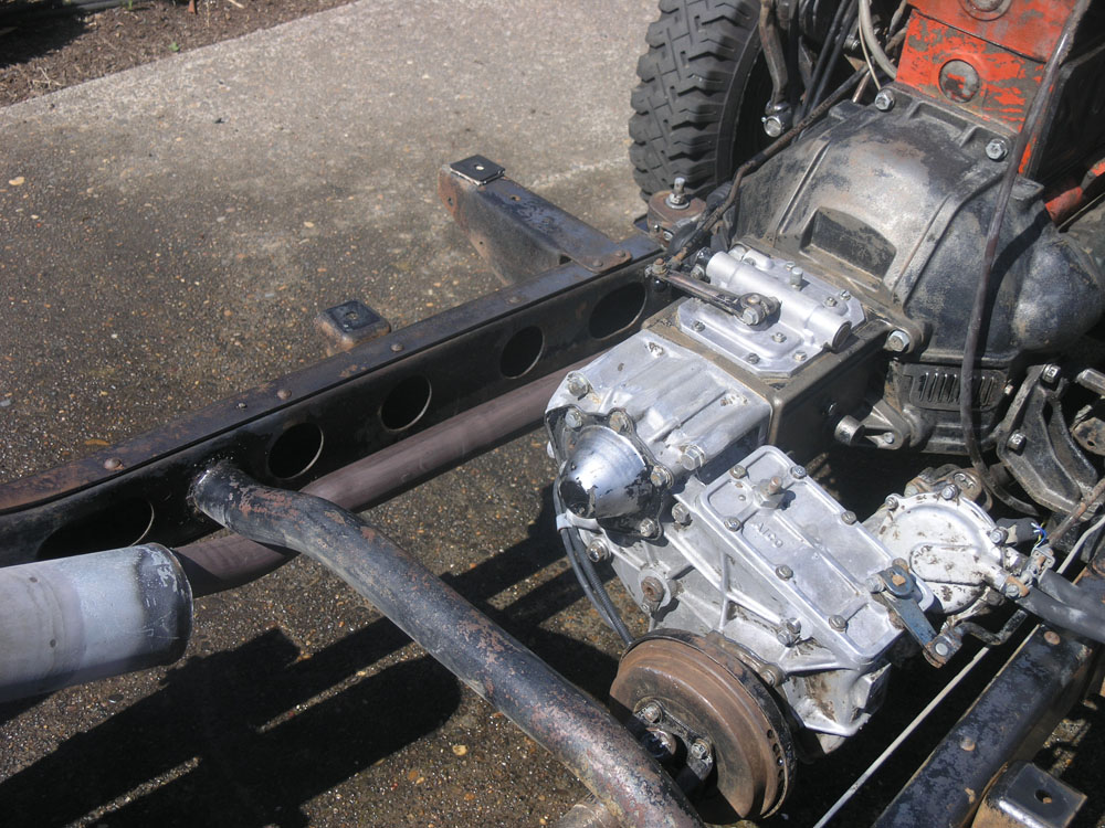

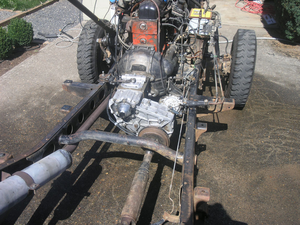

power washed / degreased the frame today :D
Couple of questions...
Some of the paint is coming off when i am pressure washing ( 1500 psi )
Should I apply metal ready to season it even though some spots still have paint?
Might degrease and power wash it again tomorrow just to be sure it is clean :D
some pics:
