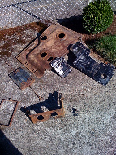

Sending all the skid plates and guards and battery tray to get powder coated black with some other parts soon :D
I wouldn't powder coat...but that's just me. I would rather see it painted properly. Same deal with the POR stuff. I have never used it, but from my understanding of, I don't want to either...just a personal choice.

Yeah i can see if I can have the shop paint the guards black, but They might have taken everythign to the media blasters already ;)
I will check in monday :D
