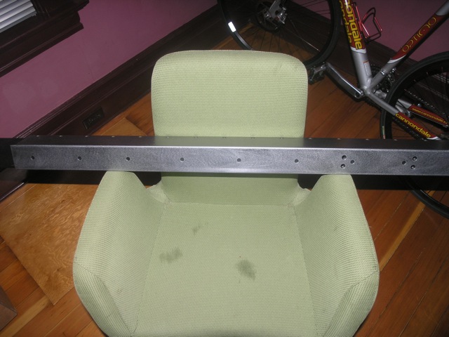

ok metal channels are all off the soft doors.
Tired drilling, not to successful, tried dremel, meh, time consuming...
Ended up gently popping it off with a screw driver as leverage, metal stayed in decent shape, old screw threads popped right out :)

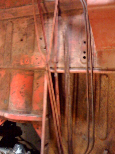

I made a 90* nozzle for my pressure washer. Compressed air works nice too, get a piece of 1/4" or 5/16" brake line and attach it to your air and it's flexible enough to snake inside the rail. :hillbilly:
