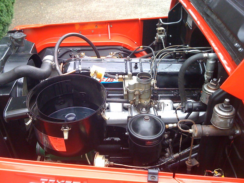

Heat soak is when things get hot after you stop the truck versus driving around.
For instance, you mentioned the lack of an isolator on the carb. When you start the truck cold and drive it around, the engine warms up but the flow of air under the hood keeps the carb relatively cool. When you park the truck for 5 minutes, the heat from the exhaust manifold cooks the carb and fuel in the bowl and lines. Now when you restart everything *could* act differently because of the heat. This is a general phenomenon that can apply to any engine system: cooling, electrical, lubrication (think turbo), etc.

so could it be just not having the insulator below the carb or the carb has massive vacuum leaks?
It was rebuilt by Mark, but he said he was curious to how it would work as he had to file the warped bits to get them so seat well.
is it easy to pull a stud and mount a longer one so i can place an insulator?
i have and aluminum/metal one from mark, but would not that metal conduct heat rather than insulate?
also the previous owner had drilled a PCV thread tube in the lower part of the throttle body, probably becuase they removed the insulator. could that be the problem?

Mark had some carb insulators made (from aluminum) and sold me one. I would definitely get one of those if you can.

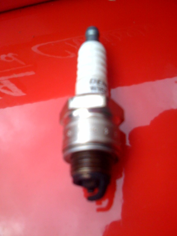

i pulled the spark plugs and they were kidna dark, let me get a photo:
here, sorry kinda blurry

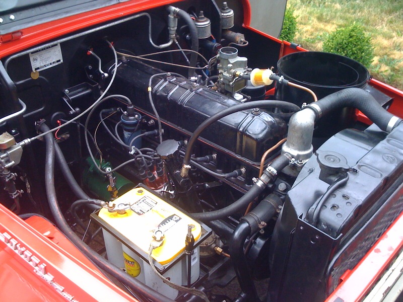

This is how I connect my vacuum gauge. (That's my FJ40 but they're the same).
"T" into the manifold hose to the front drive shift. I have it connected to a gauge in the cab, but I have a reducer adaptor connected and can have a hand held gauge hooked up while I'm doing a tuneup.
I don't know what they mean by 3 degrees of advance. If it means 3 degrees BTDC, then yes it's wrong. If it is 3 plus the standard 7 degrees (= 10) then that's OK. I would check it myself with a timing gun, of course.

Spark plug indicates too rich. And that looks like an awful big gap.
