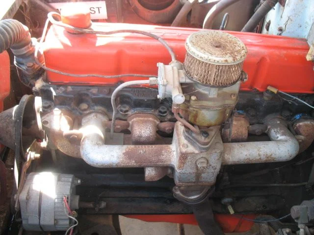

Something kinda interesting i heard from the engine shop owner
there is a little piece of tin on the exhaust manifold that drops and wraps over the top ( circled in red, you can see the little piece on the bottom )
He was saying those where usually set up for an automatic choke or something, that as it heated up it would unchoke etc...
not sure if that is true for cruisers, but it was interesting, anyone can verify>//?
Dunno. Nothing like that on mine, or in the next couple years that I could find. Anyway, no automatic chokes for years in the future.

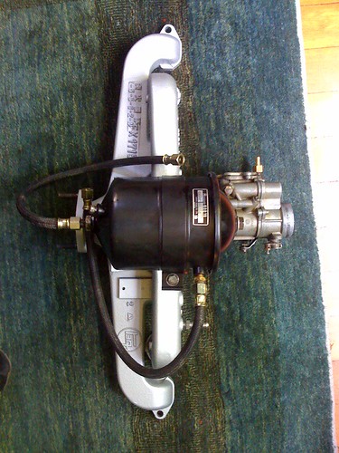

Automatic choke
When I replaced the carburetor on my '57 Chevy (mostly stock) the new one had the automatic choke, so I fabricated something similar to what you have there.
The tube is slipped through a hole in the sheet metal and transfers the heat up to the choke.
attachment.php
