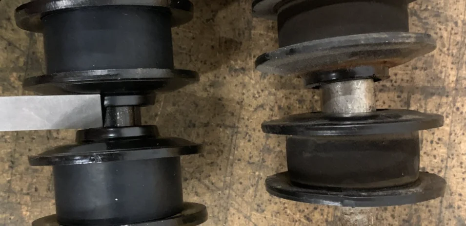

this is the money shot:
you do not want the left one. My OME hardware was per the left pic and I just reused OEM washer. Immediately all better and hasn't squeaked since (2 years)
Did you also add a spacer washer to the top, right under the nut?
Yes you can and that is what I did so it would tighten down good.
FYI .. It took me a long time to figure out what it was.
You use the lipped washer on the bottom and the one with no lip on the top.
So the ones ARB sent you .. you can toss out the lipped ones.
I did not add a spacer. It tightened down fine. I see no harm in adding one if needed to tighten the nut.

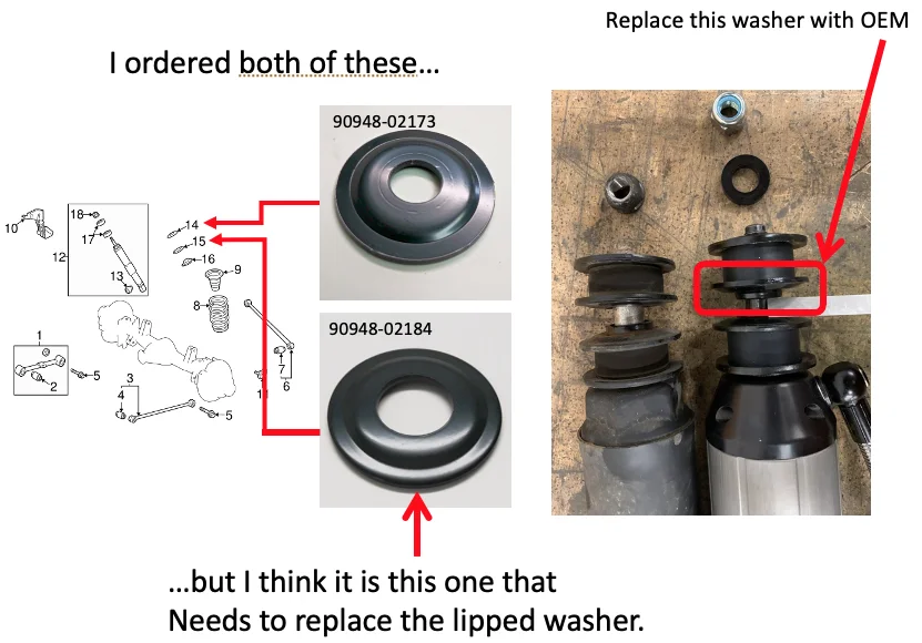

Just went through this for about two years and finally got it fixed. Did exactly what was described above re: kcjaz's post. I attached a pdf that pretty much details my communication with ARB (and their reply) and also some details that I provided to 4Wheel Parts when I asked them to replace the OME lipped washers with the OEM washer (s) that I bought. It includes the picture below. Anyway, it was super annoying and now it's fixed! Good luck1
This is correct. Per parts diagrams of the factory toyota assembly 90948-02173 goes on the very top under the nut. 90948-02184 sits under the rubber bushing and the larger diameter keeps it from interfering with the raised lip on the lipped washer.
