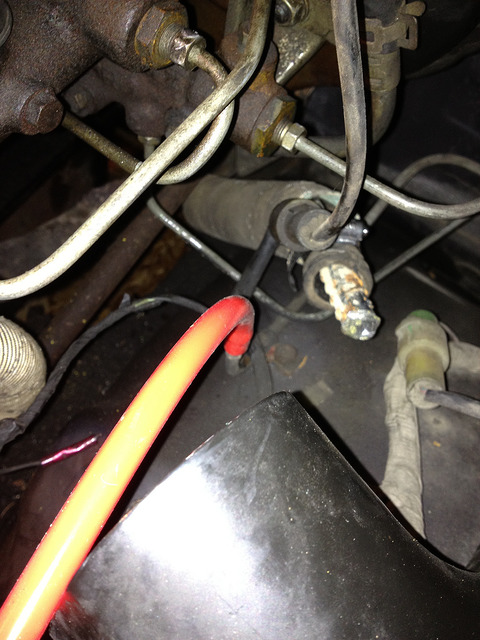

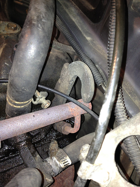

1. I am supposed to remove all this spaghetti of metal vacuum line correct? I have looked a numerous pics and dont see it so I am leaning towards yes.

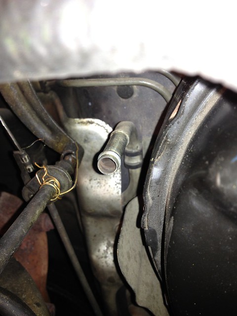

2. For the last (furthest back) Air Rail nut How the Hell do you get back there? Are you supposed to remove the engine hook back there along with the line to the booster and EGR line?

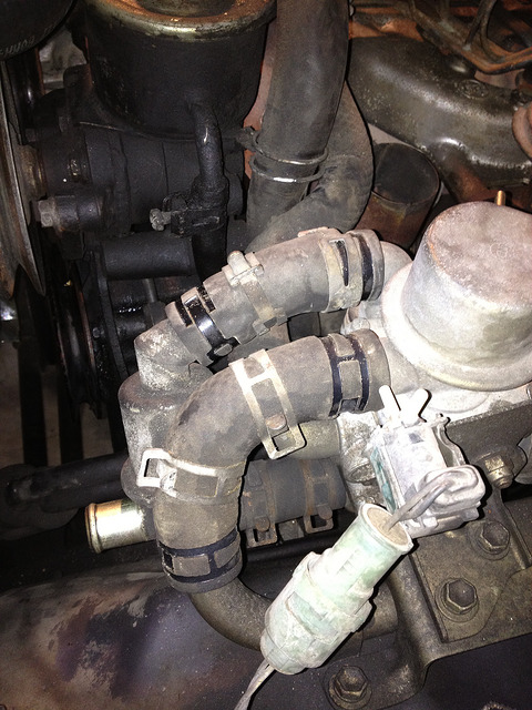

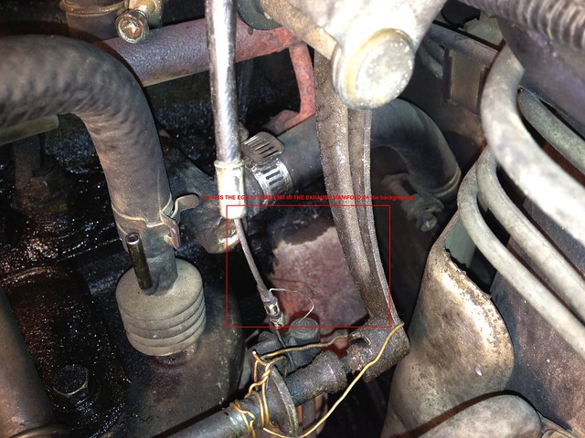

3. The hoses that are connected to all the emissions crap here (look like radiator hoses almost). These all get removed correct? I have been trying to remove them but they are so short that I can barely move them and dont want to cut them before I know for sure..

1. The metal spagetti goes away.
2. I cut off the air rail, then unscrewed the individual nuts. Crude, but easy.
3. Those hoses and the parts they connect to also go away.

I just ended up cutting the hoses out so thanks for the comment. JimC document for the desmog says some people leave the rail in and I think that for the time being I may do that as I just can't get to that last one. Rest broke out just fine. I would love to save it and get it to anothe mud member that needs it.

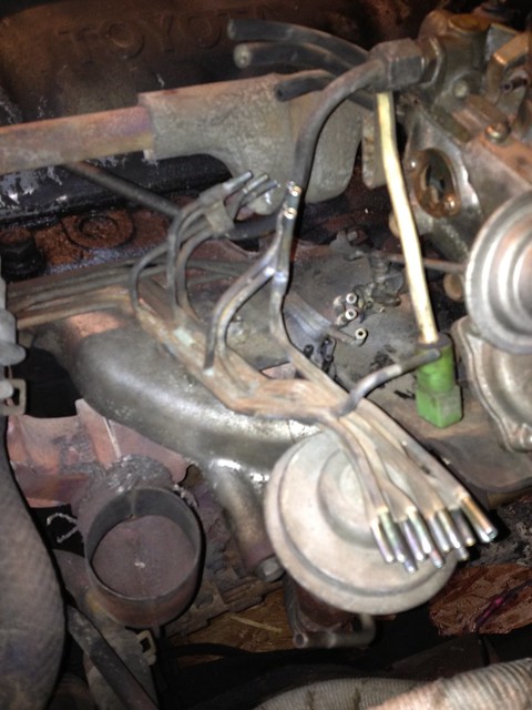

Remove the EGR Diaphram (UFO looking thing) with the EGR plate under the carb
Untitled by renofizz, on Flickr
Somehow unscrew the flex tube the leads from the EGR Diaphram to the EGR Cooler (still can't get this to budge)

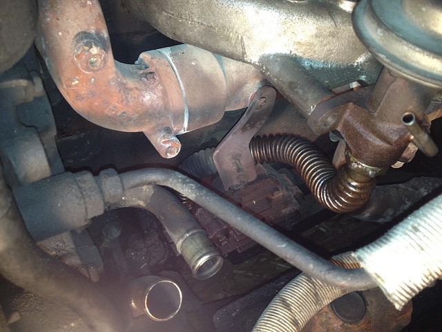

Then you are supposed to remove the EGR Cooler? Note the big bolts are 14mm. The pipe that is coming out of the back of the EGR Cooler is that the J Pipe referenced in the desmog document? (Seen here out the back of the EGR cooler?)

If you are removing all the EGR that the flex tube is connected to take it all out and don't worry about the flex tube just unbolt the other parts and take off. If you are leaving them you can leave the flex tub too unless you have a plug for it.

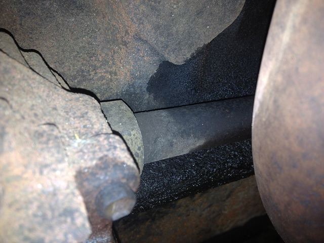

Hit pretty much a stopping point for the night as one of the "J" pipe nuts does not want to come off.. hit it with some PB Blaster and will let it sit. Went ahead and removed the busted BVSV1 and plugged that and then put the bolt back in that was holding the metal spaghetti to the front of the manifold. Had no clue water/antifreeze was coming out of the open bolt hole until I started rocking the truck trying to tighten down the plug for the BVSV.. NOTE you should have an 8mm allen attachment for your ratchet to get these in much easier... didn't realize I had one until I had been fighting with a small hand allen wrench. :banghead:
Yes, the pipe out the back of the EGR cooler is the J pipe. Just cut the flex pipe, then you can remove the EGR valve. Once you take the EGR cooler off, you can cut, crimp and bend the J pipe to seal it, or weld it up if you have a welder.
I'm vague on the details as it was a year or so back when I desmogged, but I think the EGR connection to the manifold is shared with the PCV connection. I just stuck a bolt in the end of the EGR connector and welded it in to make a plug. I posted pics of it when I did it, I'll look for them.

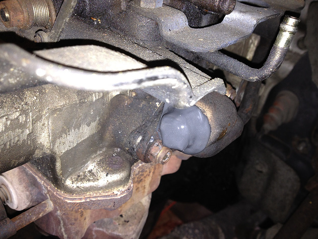

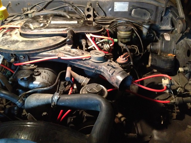

Ok so got the EGR welded up by my buddy, threw some JB Weld on there for good measure. Got that installed and the PCV line routed back to stock location.

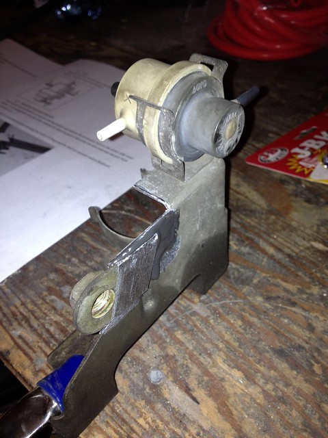

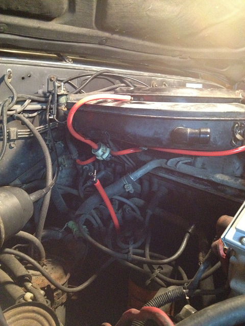

Then modified one of the brackets to accept the VTV, HAC, and added the ability for the fuel cut-off.
Once that one is done I will start working on the line routing. Going to start looking at things now and sure I will be back shortly with questions.

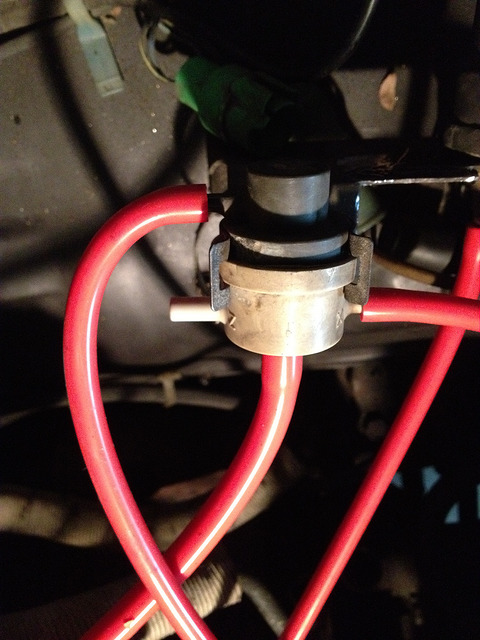

Ok in the picture above.. the white valve, is that the VTV or VCV? It is referenced at one point as the VTV and another as the VCV.. I thought the VTVs were the white/opaque and blue or green valve...
Ok so I am so close to being done but I have a couple questions..
First one is going from the drivers side VCV to evap...
- Line (z) to EVAP canister "PURGE" line (

The last thing is the "T" fitting that is talked about for the HAC Advance on the the Distributer to HAC Port D and split to manifold Gas Filter check valve.
Am I missing a "T" fitting or was I supposed to purchase another one.

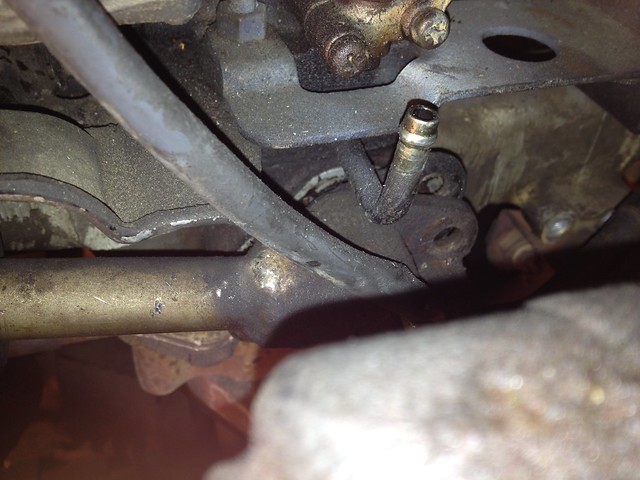

Ok found the EVAP purge line... sneaky little bugger is hiding under the Brake Master Cylinder..
Picture that I was showing above was actually another port that routes from below the carb to the firewall.
Figured out my A/C Idle Up so last thing is the HAC Advance to Manifold. Guess I will have to go to NAPA tomorrow to grab a T fitting for those and then I will be done.
