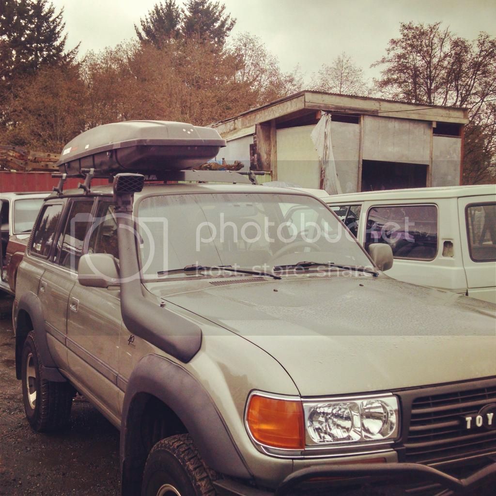

still need to do some adjusting, but i prefer these over my HIRs that i was running in the stock headlights. this is the only pic i have at the moment (please pardon the chinese snorkel and hipster instagram photo, both of which are likely to get me kicked off of MUD!!):
