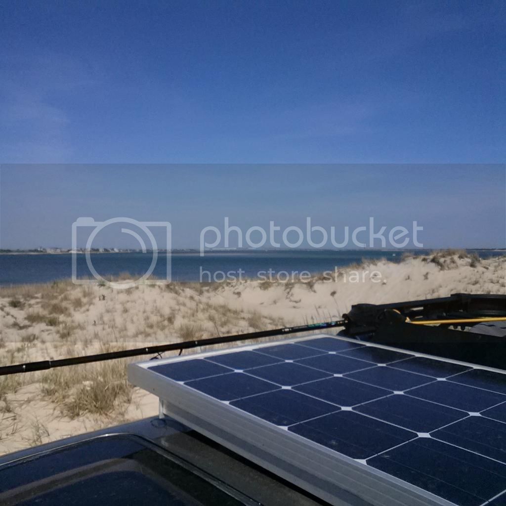

Almost on a whim I went and got a 100W solar panel and rigged up a mount off of my short rack.
Better shot of mount:
And panel:
It actually makes 120 watts at just under 7 amps, and that's even on a cloudy day in a drizzle. (rated 100w and 5.3A) But after the charge controller takes the 20 volts coming from the panel and knocks it down to 12v (actually 12.6 to 14.6) the amperage comes down to around the rated number.
For the mount I simply used two 1.5" angle aluminum from home depot and bolted them under two crossbar slats each in the roof rack, extending out in front of it the width of the panel. Then I used two 1" pieces of these L beams connecting the two larger beams to make a rectangular frame under the panel. But the two large L bar extensions go under the proper mounting points for the panel and provide the main support. The two thinner bars just brace the whole affair and actually make it so the bolts for the panel can't be accessed without taking the whole rack off, reducing the chances of theft.
I've only had it for about two or three weeks now but I know I can blast the 100wpc stereo I just put in all day long without ever running the engine and still have a fully charged battery at the end of the daylight. It's never gone under 12.7v. This gives me a fully charged battery for the night, and by the time I wake up (10-11AM-ish) I've got 13 to 14v again.
The whole deal, panel, controller, cables, cost $184 delivered, and I consider it money well spent!
I bought it through Amazon which had about 100 very positive reviews and almost no negatives. If anyone wants the make and model numbers I'll be glad to post them.

Dave: There's instructions but it's pretty basic. Panel to controller (small box about 4" square) and from there to battery. I have 4awg cable already in the back for an amp and inverter so I tapped in there. The only thing else to buy is some 10awg wire to go to the battery. (this is why the box should be near the battery or cables leading to the battery)

But honestly I don't see that much difference in voltage from say 9AM to noon to 6PM with my panels. They're Monocrystalline type PV's which aren't sensitive to sun angle. They make good voltage in low light. It was raining the day I got it and I was getting 20V aand 6.7A at 3-4PM. That's maximum rated voltage!
Where did you mount the charge controller? I heard they are supposed to be as close to the battery as possible but the rear quarter panel has so much space inside!
That's true but that seems to be because there's only 10 gauge wire running to the battery and the loss would be to much running it 15 or 20 feet. But I already had 4 gauge in the back going to a splitter for the amp and inverter, so I just tapped in there.
