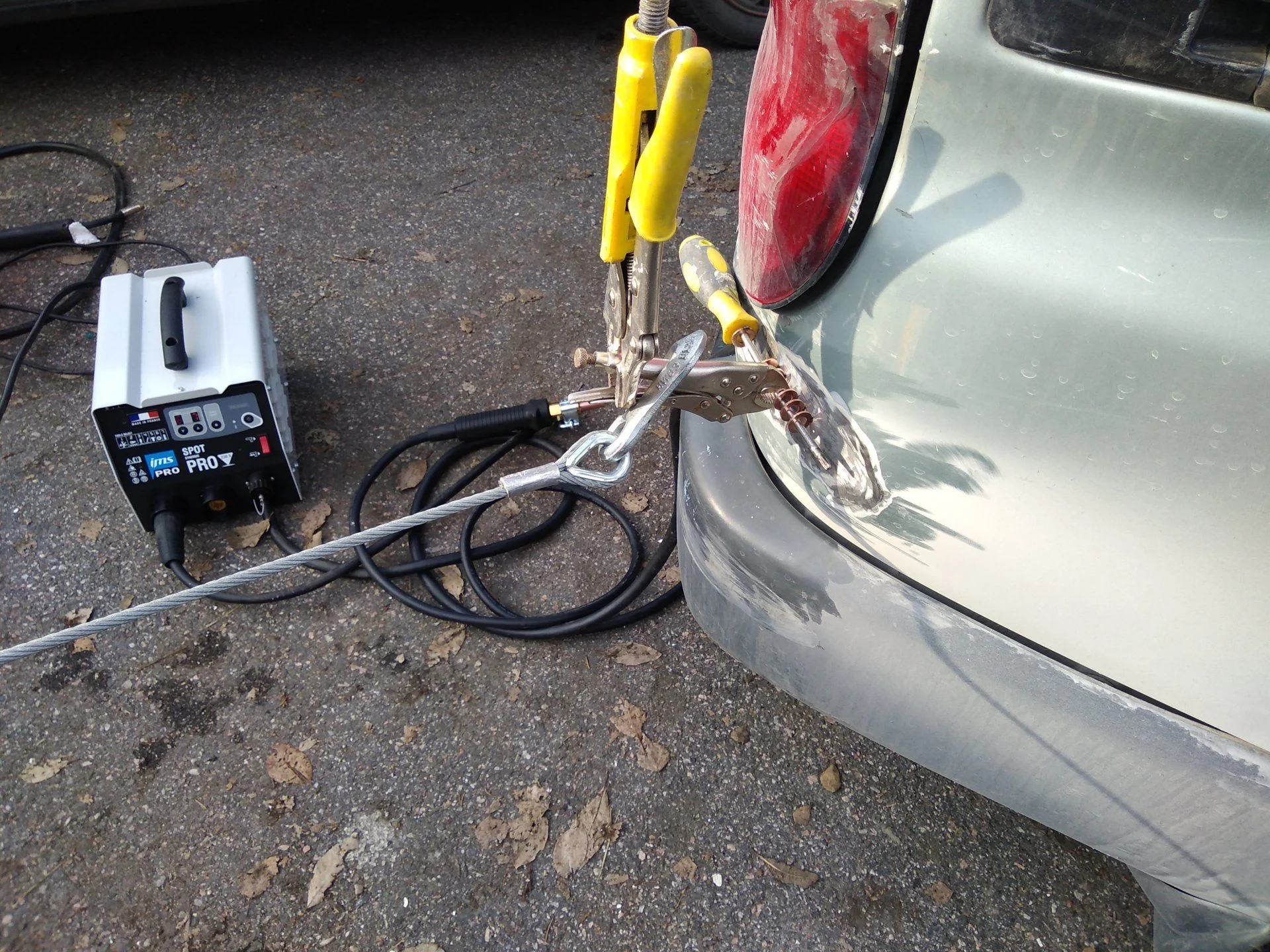

    heres the offending tool. its a pro230, does everything except help me.

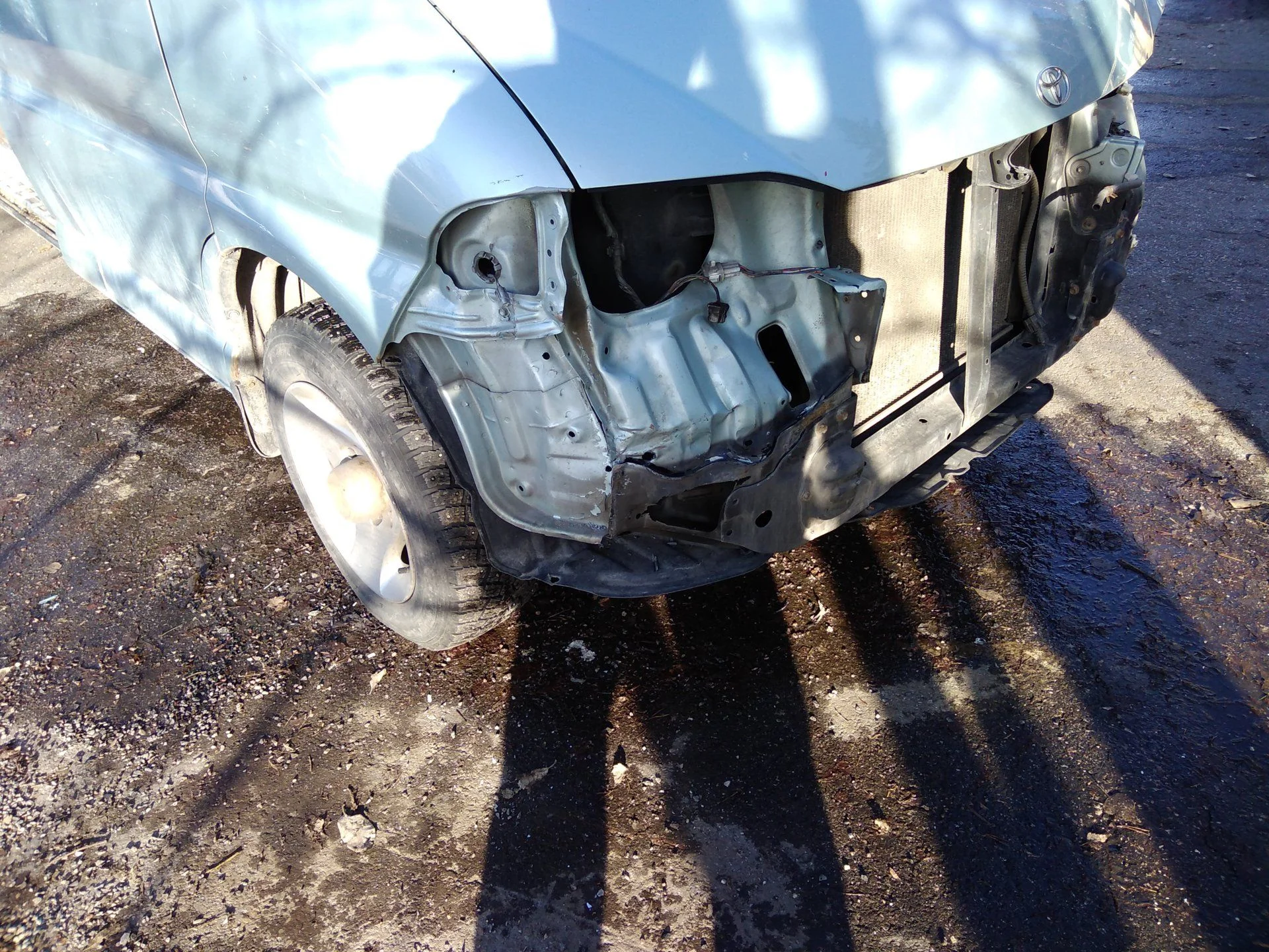

    heres my handy work on the highway
    I did a 360 on ice and hit the back aswell.
    In this pic i tried so many times to pull the panel but the weld keeps breaking.
    If the puller cant do the little crease at the back , then the front is a lost cause.

    I would guess you need clean steel, and more attachments to pull on.

    Seems like an updated stud welder. Do you have a good, clean ground?
    Looking at the crease across the back, I'd be using a series of those rings they show in the video. You're not going to pull that crease out with just a single attachment. Personally, I'd be working that with a hammer and dolly.

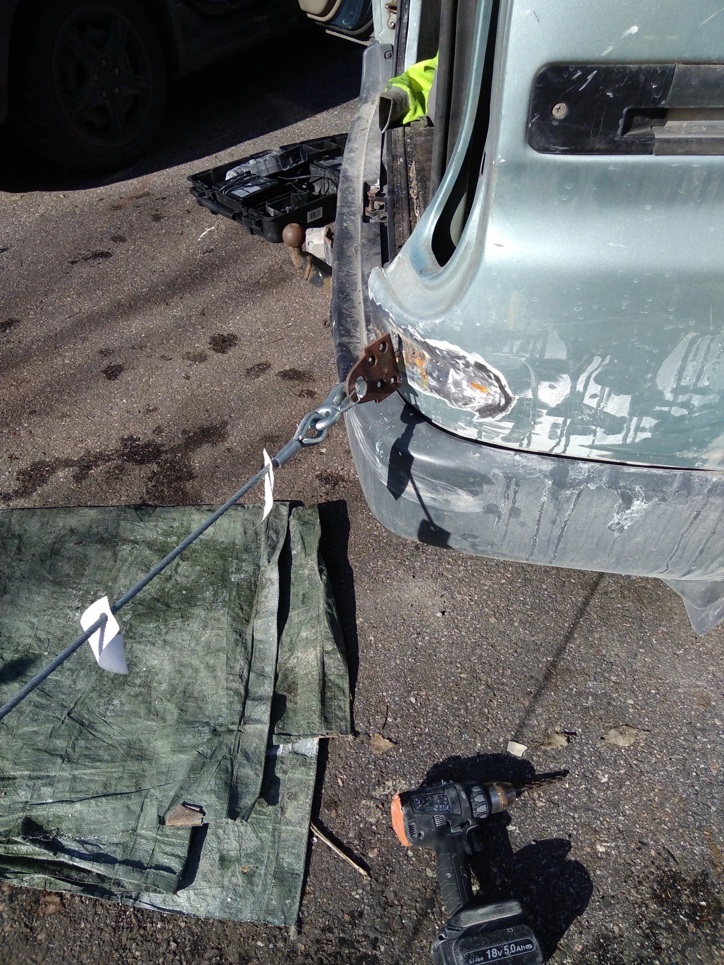

    took the advice here and tried to use the washers, turns out that there was a second frame arrangement behind the top panel so i got out the drill and did a samwich jig. IMG_20180409_172257.jpg IMG_20180411_154751.jpg IMG_20180411_164825.jpg

    Those sorts of tools are used more for "popping" out a dent with a slide hammer. Once you have a crease or significant metal movement, you're pretty much back to hammer and dolly work - or even cutting and patching.

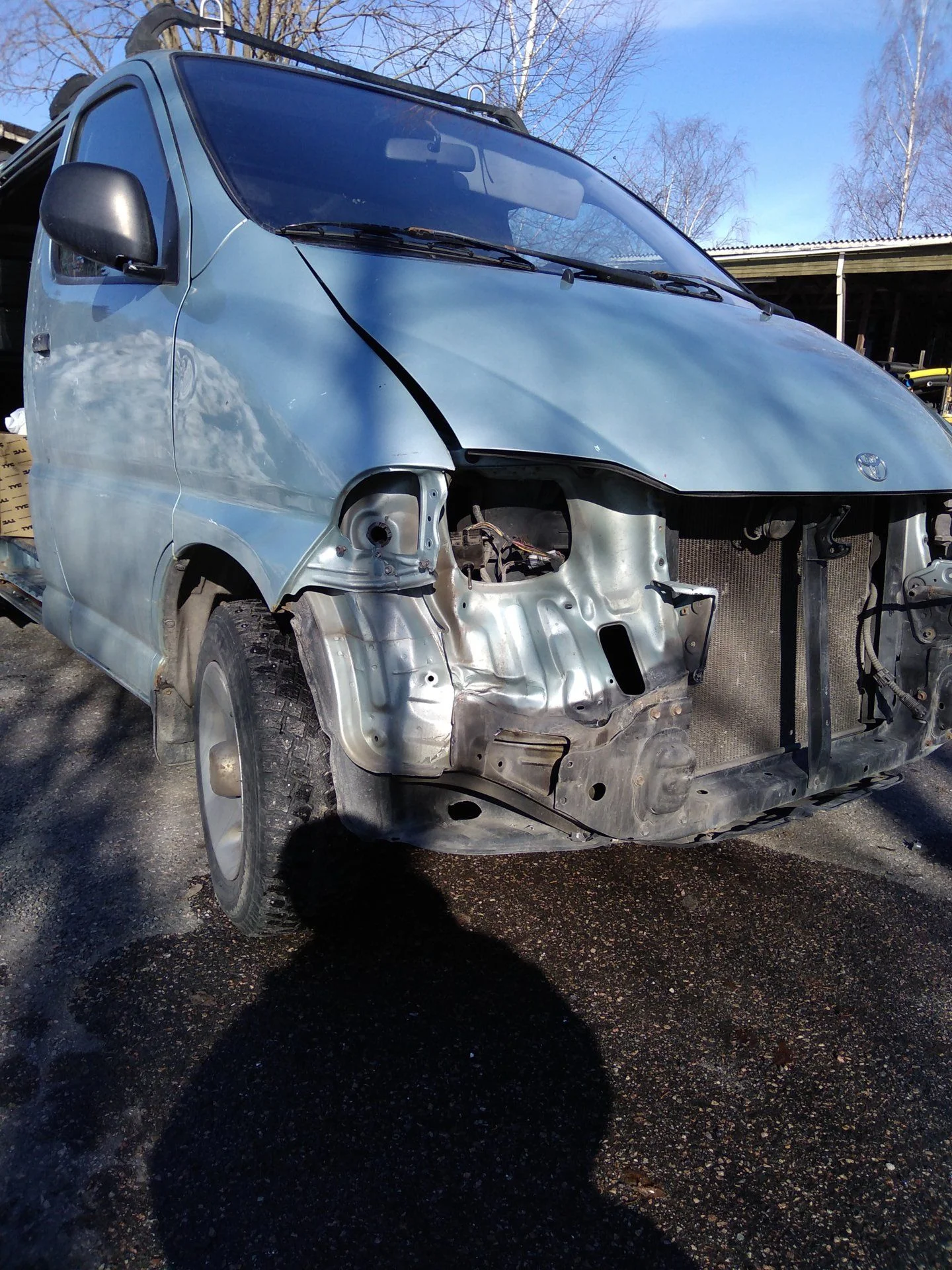

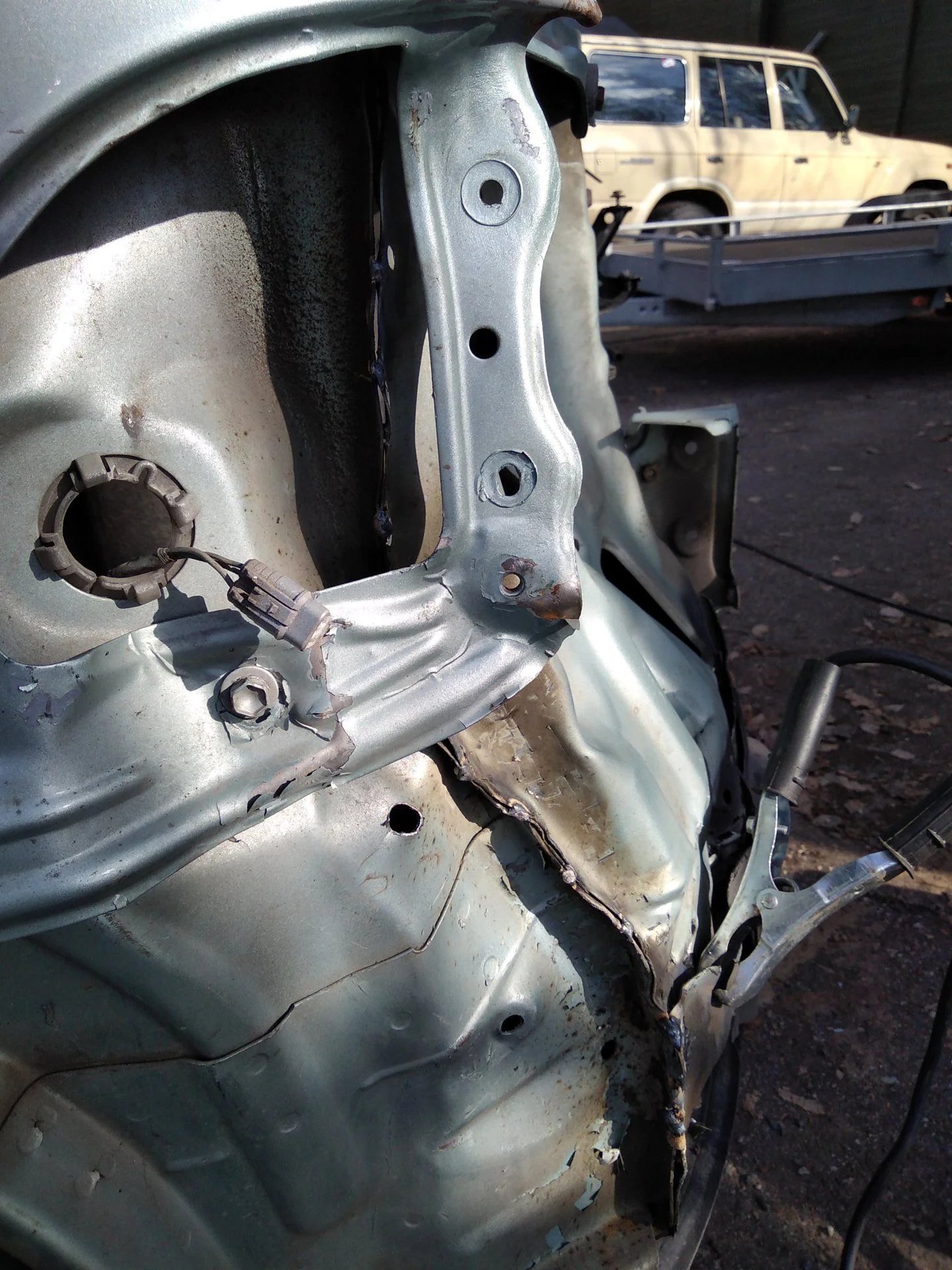

    I think i got somewhere today

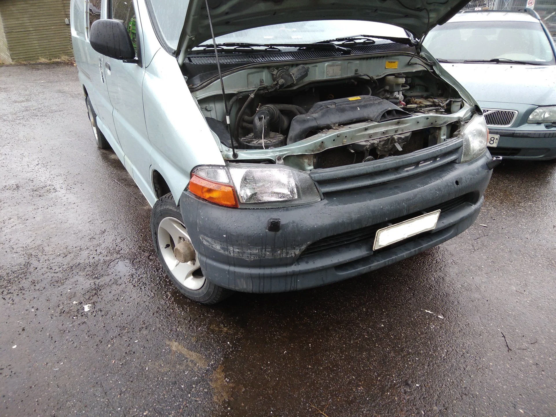

    you can see the van has been fixed on the left side front before, its different to the right.

    hmmm , well its going forward

    back together just .
