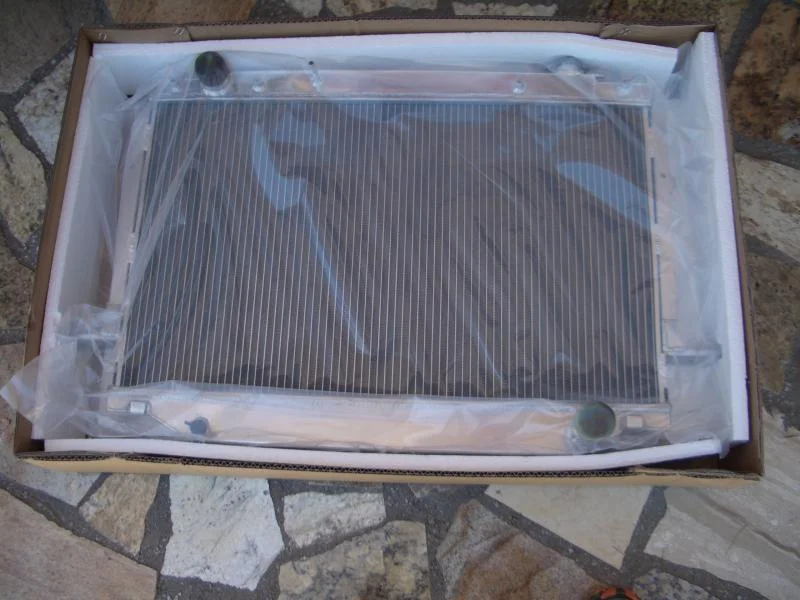

I have installed a few of the CSF all metal radiators. They fit correctly and function correctly. No need to worry about blowing it up when the head gasket fails either. ;)
With minor finagling they work in the 91-92 FJ80s too.
They are my go to replacement radiator for the '80 series.

Thanks. I'll prepare to finagle.
For full disclosure, I also have a used CSF all metal radiator, had to resolder one side bracket, about to install it into my high mileage 80 where the original plastic top tank cracked at about 350,000 miles. Been running it with a patch made up of ~6 layers of fiberglass cloth and two part epoxy (with the radiator cap on loose to decrease pressure on the repair) for a couple of years :hillbilly: .
