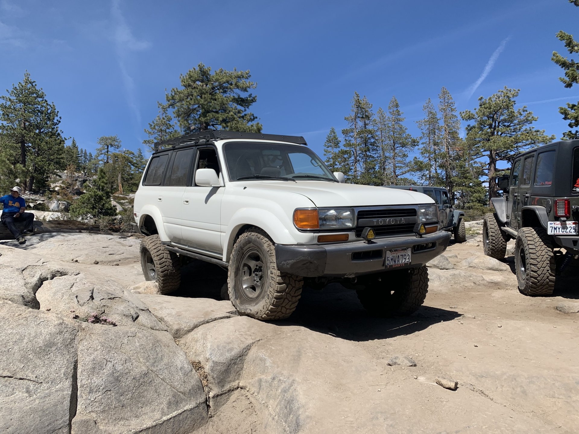

I just completed the rubicon this past weekend and these arms performed as advertised. I don’t know how much more up/down travel I had compared to those running plates but it as definitely noticeable. And boy did I abuse them on the trail. I haven’t really noticed any dents but I’ll take a closer look and will post pictures of all the damage occurred, can’t really say that bout my front bumper though 😂
