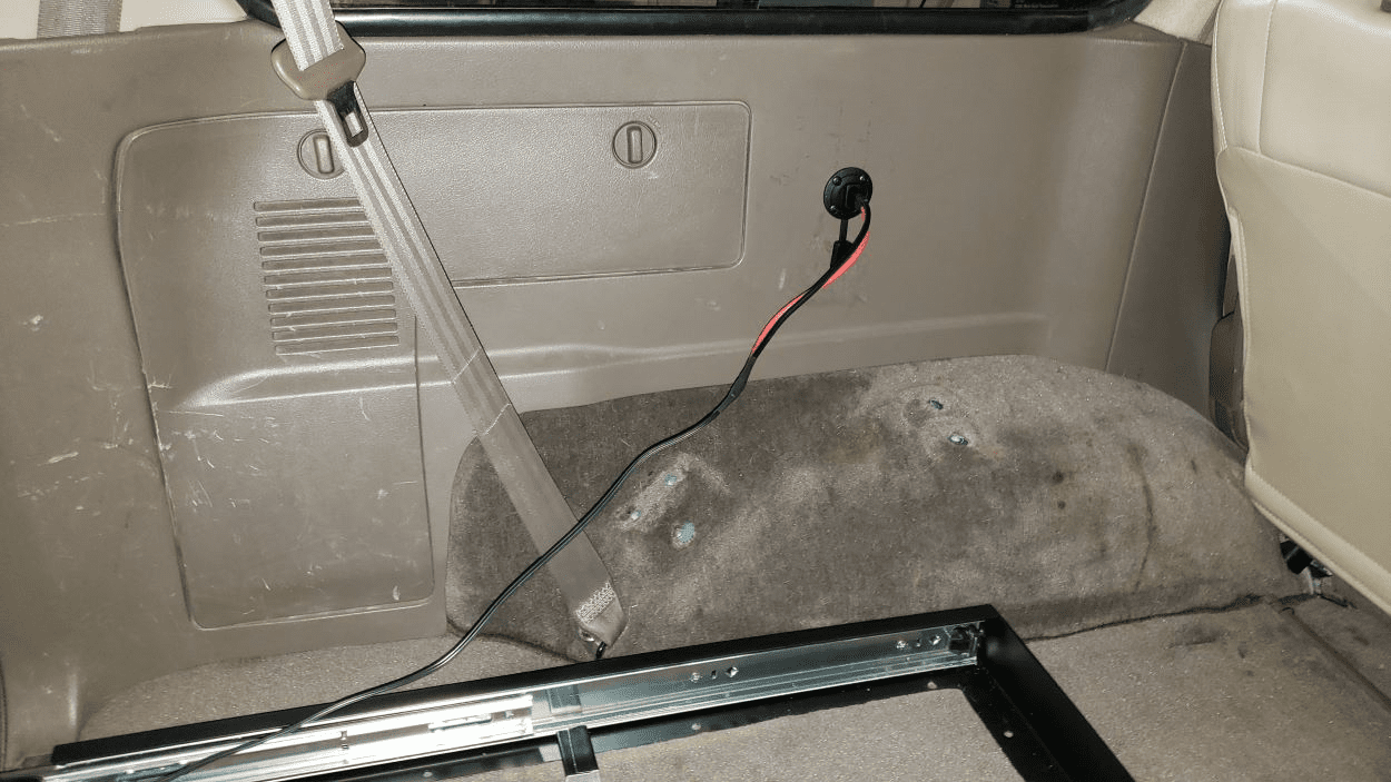

My super generous neighbor gave me a complete W53 setup a couple of days ago and I just got it installed in my 97 LX450. I attached the slide using existing bolt holes for the third row seat anchors.
I have 8 gauge wiring running to the back of the truck through the driver side of the body to supply power to a couple of cigarette lighter plugs ( was previously running a small 30L fridge), so I added an SAE plug like these. An inline fuse was added here inside the trim panel.
The cigarette lighter cord that comes with the fridge is quite long, and while definitely adequate in gauge to safely power the fridge, voltage droop while running was a bit more than I liked -- I am running everything off of a Northstar 27F battery and 100W Renogy solar panel and MPPT controller, so efficiency is important to me, and voltage drop kills that.
I used as much of the SAE plug 10 and 12 gauge wiring as I could and then cut the cigarette lighter cord that came with the fridge as short as possible to allow full slider range.
(wow, the camera flash really makes the scratches on the trim panels look severe!)
While running, it pulls 2.87 amps. I am not sure if that will vary, but may go up if it has a higher operating mode for when the ambient temperatures are really high.
The app works well, although it only operates in portrait mode, so forcing it to landscape jumbles some of the text. It is nice being able to monitor / control the fridge from the front of the vehicle with my Android tablet!
Slide out!
