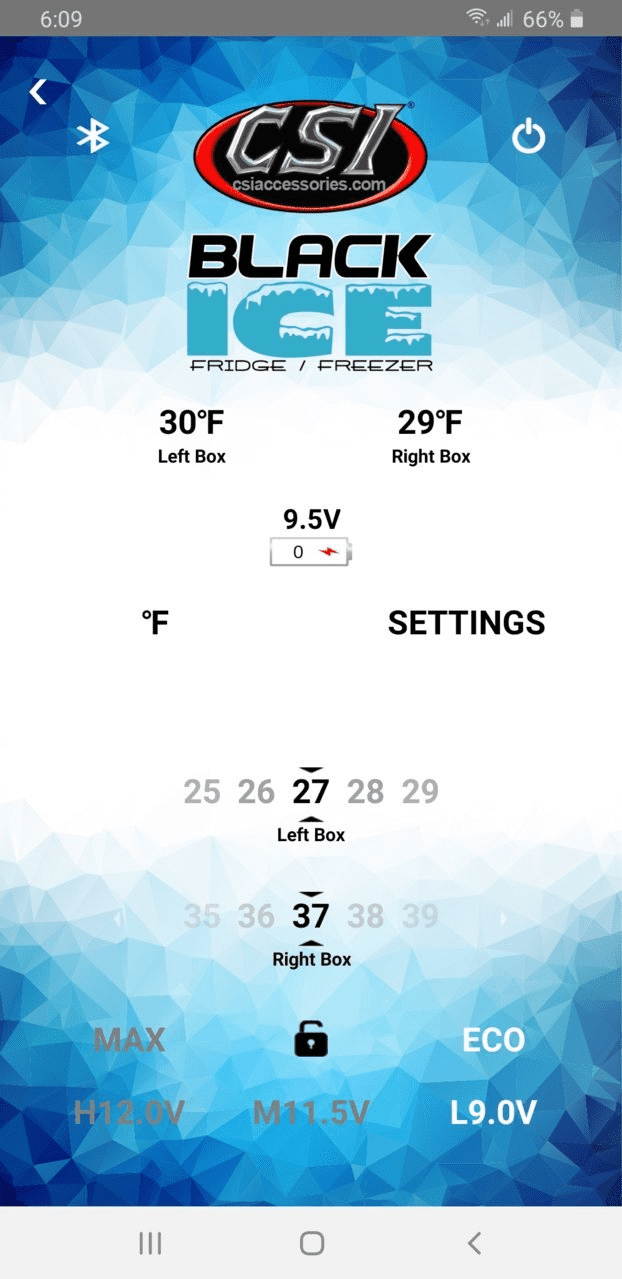

Thanks. I may need the battery pack. It won’t run on medium either. It shows 12.5 v until the fridge kicks on then it drops to 9.5 for a few seconds, then F1 code. It runs on low but the battery shows 10.2 v on eco. I’ve only had this battery on for a few days but it’s worked flawlessly. Could it be that I need a battery pack?
The little battery has done an awesome job. Ran for 8hrs and here is the app readout with the compressor running.
