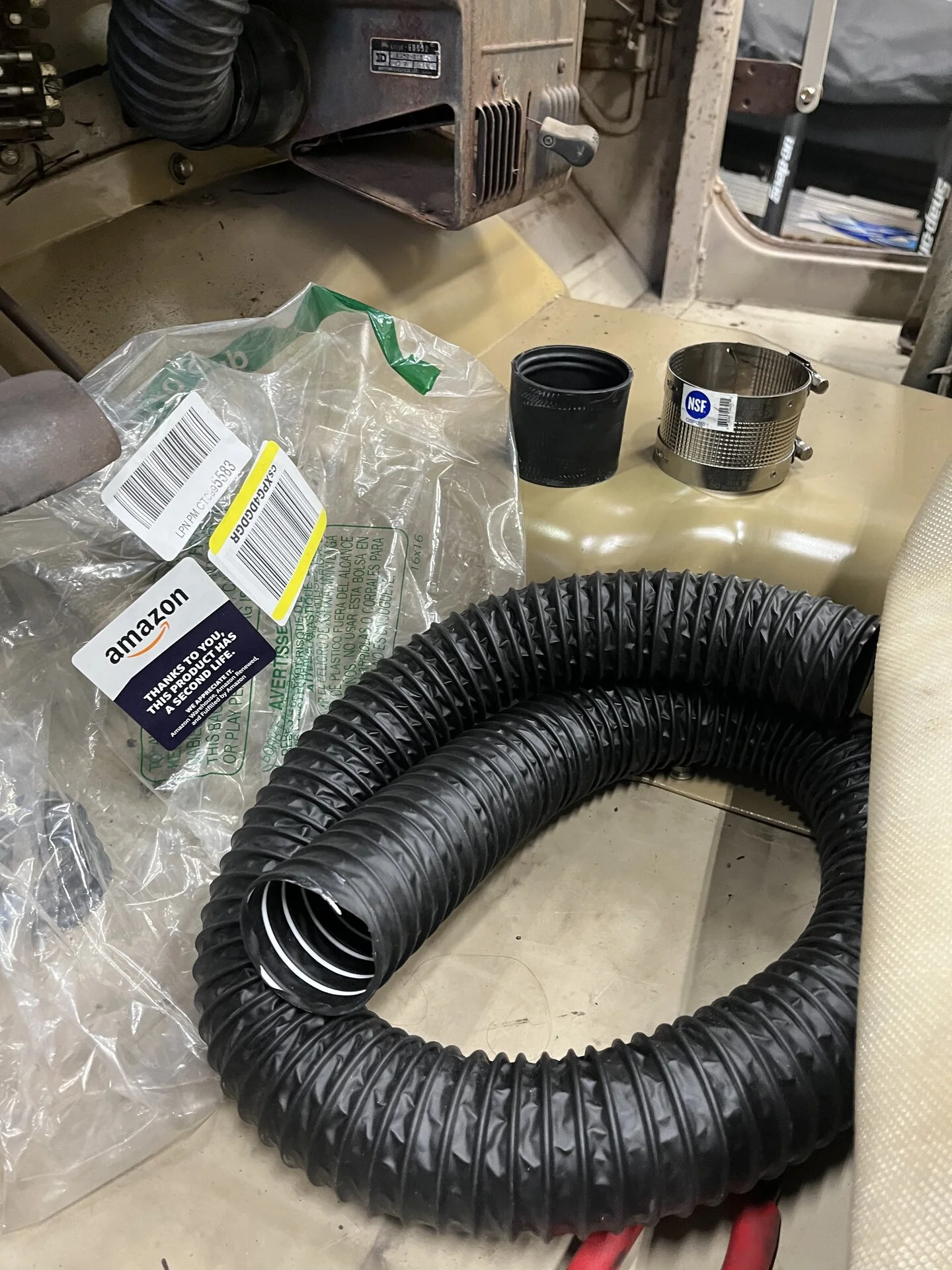

Amazon- dorman 96002 2” defrost hose.
Menards-2” no hub coupler#6895934- qty 4.
4 black cable ties- total cost $32.

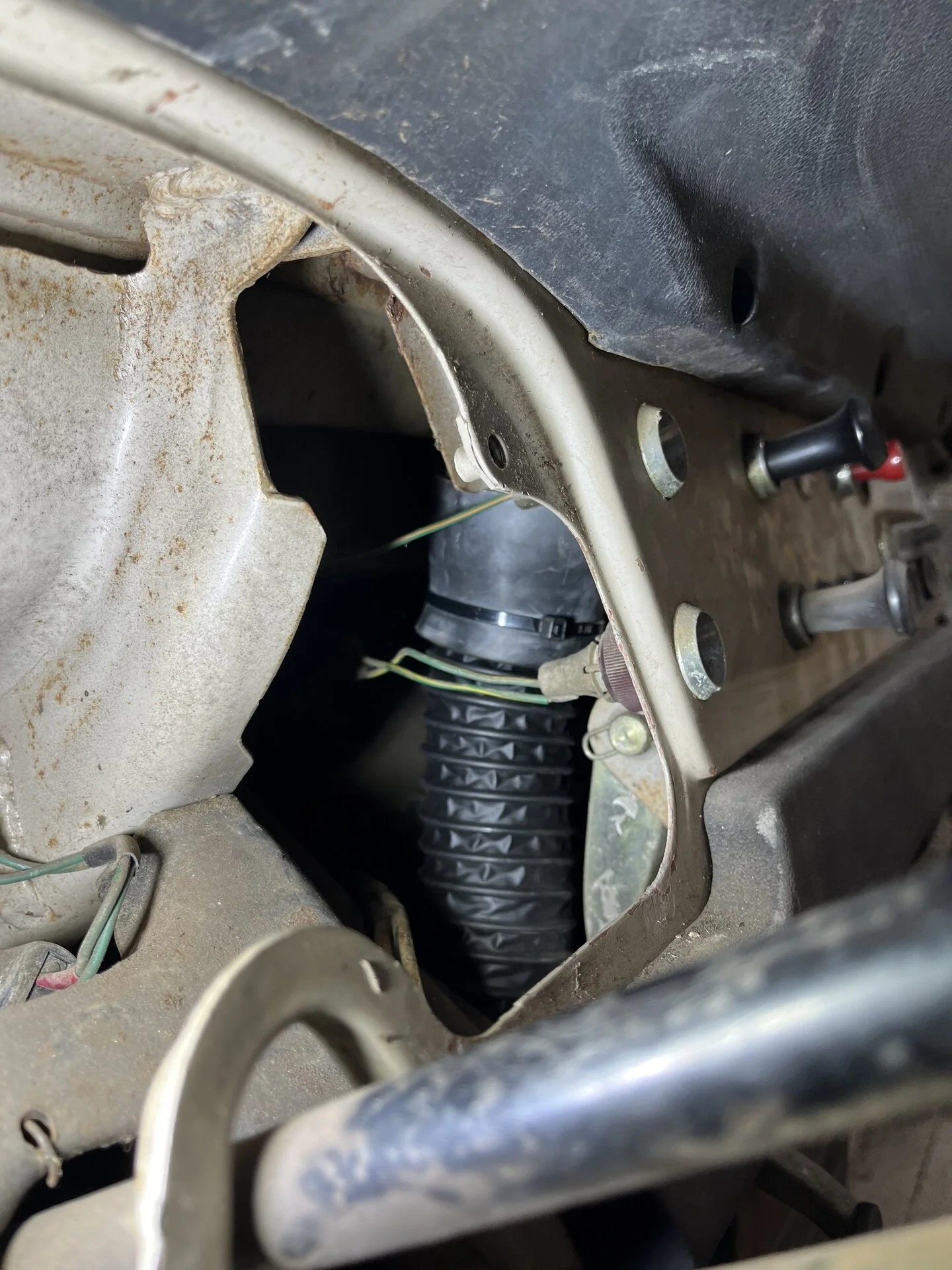

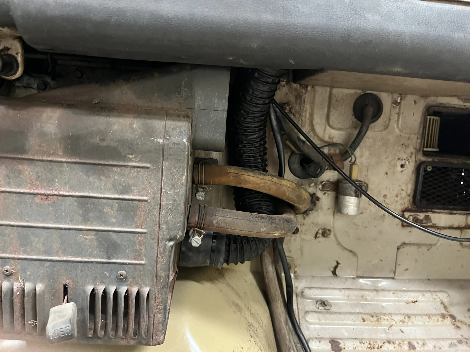

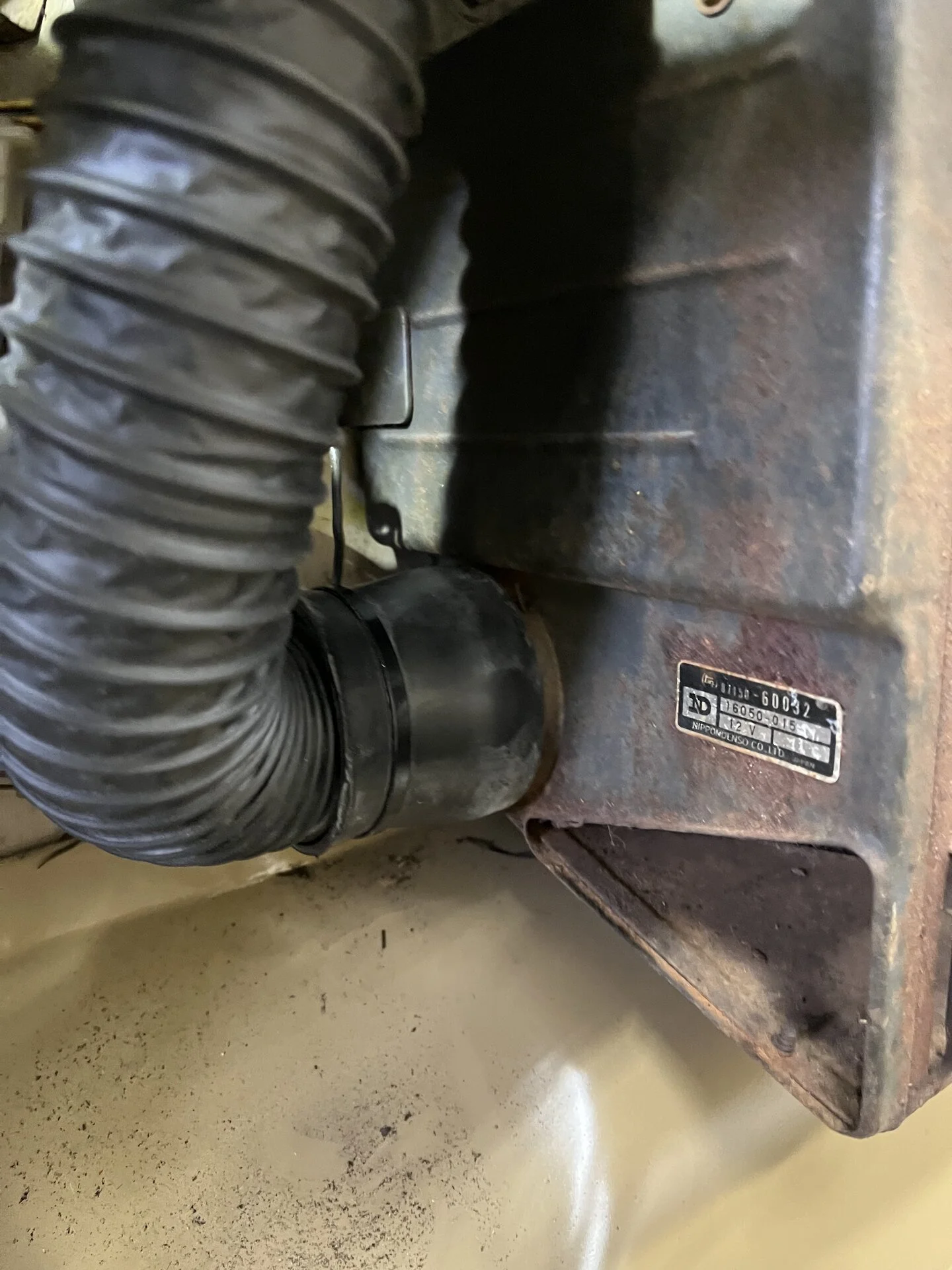

This works well, looks good and saves some money.
Looks good. That hose looks like a 2 year at best before it dry rots and cracks. I'm thinking like radiator hose and some 3d printed elbow connectors.
