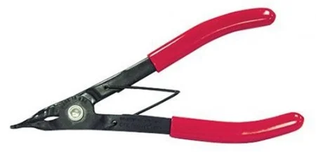

Snap Ring Pliers - $21.00
For use on the free-hub/drive flange snap ring found on Early - 2007 Land Cruisers including the 2x/4x/5x/6x/7x/8x/10x models. Allows easy removal and installation of the snap ring without damage.
Part# FASNAP

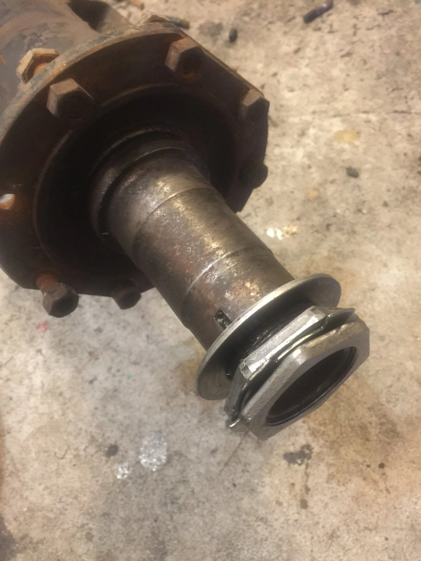

Funny thing about the full float rear tripod socket. I have two full float axles now and for an experiment and also because I dident have the tripod nut for the one I was just building. I used the 54mm front nuts and lock washer on the rear axle. Seems to work well no dramas and nice to use the same tools. Though the more tools the better!
I own more tools than god!
You got a picture of this knuckle stud tool? I have never heard of it?
Did you try to get the locknut and washer from the rear full floater to fit on the front axle? I was told they didn’t interchange.

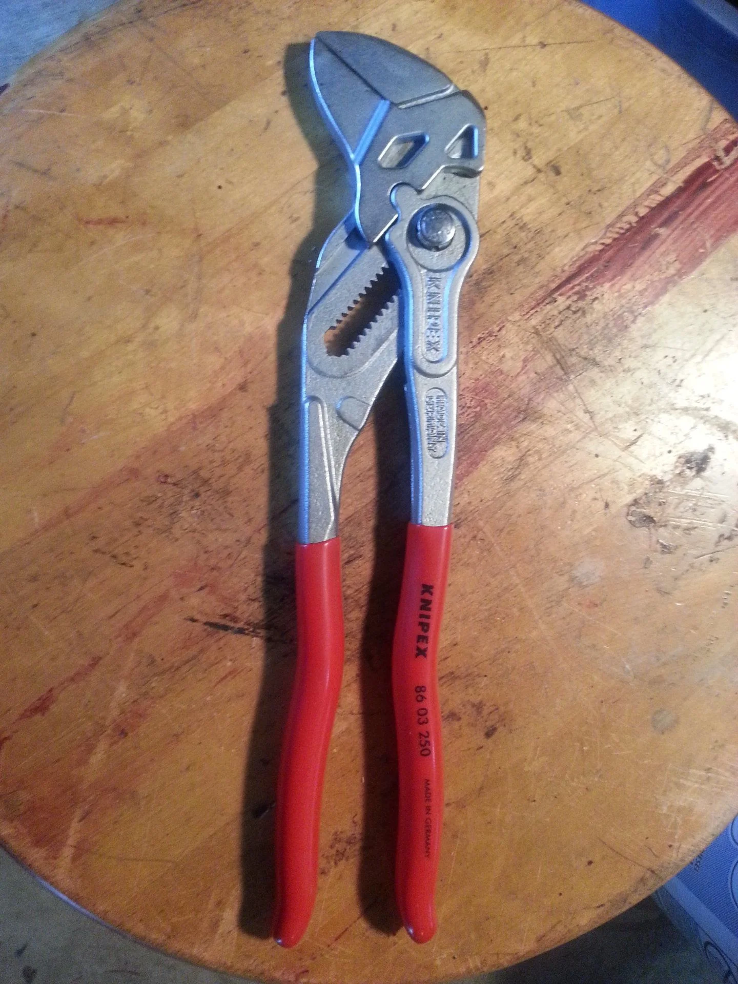

And for pretty much everything you can't use a socket or box end on, even a lot you could, specifically any sort of plumbing fittings. they have a 10:1 mechanical advantage on the grip, so they won't really slip on anything
I actually have two pairs of these now. A smaller one that pretty much lives in my pocket.
Not cheap, but a good one for the xmas list...:grinpimp:
Yeah, still haven't broken down to spend on the Knipex. They are really nice. Have you used them to grab the
front hub nuts instead of using a 54mm?

The info I have is there isn't enough room on the front axle to use the same locking
rings that the rear FF use. I plan to put that to the test soon. I like the locking rings on
the rear way better than those damn nuts and fold over lock washers.
I haven't no. Bought them after doing my front end. Guy at work had a pair, used them a couple times and I caved. Strangely the smaller ones I have (5" I think) was the same price as the 10" pair. I was monkeying around in the yard on tractor bits all day, nice to not have to go back to the shop and get a wrench...they grip so hard you can pull crappy old cotter pins out with them (can even pull nails)

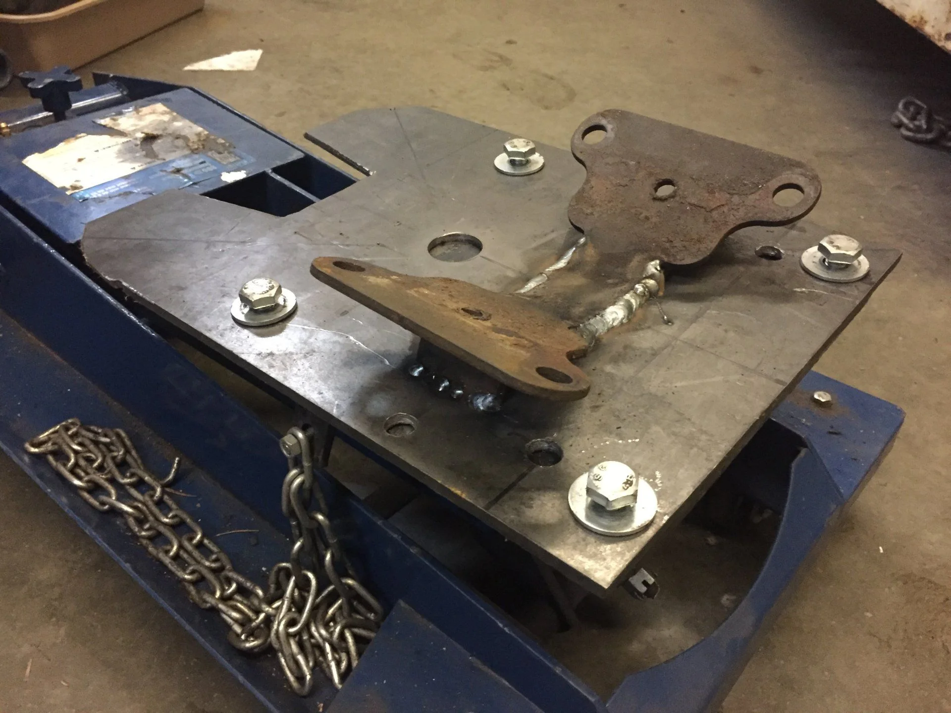

thanks to Gsb for lending me his transmission jack. I made this custom plate from an old H55 transmission bracket.
It makes it so no chains required and it bolts the transmission right to the jack

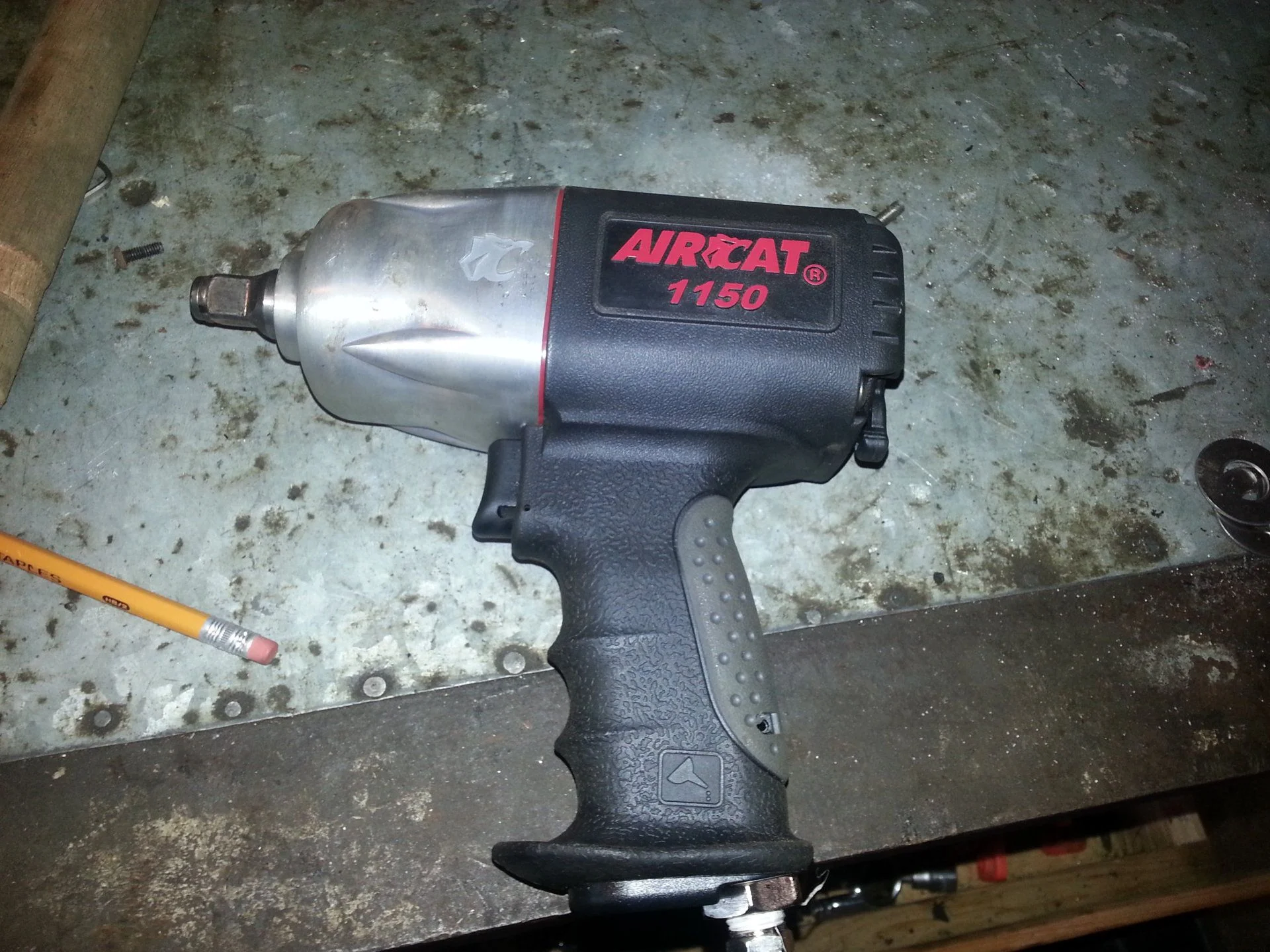

After 15 years of not really using my impact gun because it was useless, I bought one of these. $200 on Amazon which is pretty freaking cheap. They claim 900ft lbs of torque at 90psi...Midland tools closest was half the torque at double the price.
Numbers are probably fudged a bit but it blows my old ch one out of the water. No comparison.
Love my IR gun, but at almost half the price that gun is a great deal...

Air line isn't a problem, this thing spun off lug nuts a tire shop hammered on that I could barely move with a cheater bar, and did it at the end of 150' of air line with 1/4" fittings in about a second.
Kindof night and day over the old piece of s***. Which I'll keep, but only for putting in lagbolts out in the rain.

I think I have to buy me one of those! Thanks for the review. My 1/2 impact is a piece of crap too. From one of those cheap kits from Costco I think.
The true test, think your new impact can get a crank pulley bolt out?
Ha that would be the test. Think my old one was the same. Costco or maybe even walmart kit...juuuunk.
I bought this one after doing the crank bolt on the wife's honda crv...and possibly dislocating my shoulder in the process...:lol: (Honda crank bolts are legendary )
I'm hoping it'll do flywheel bolts, because rear main seal is on my list for the summer. So far so good tho. I was pretty amazed at how easily it did lug nuts that were freakishly tight, in the past I wouldn't even try with my impact until I'd cracked them loose with a breaker bar.
And yeah. It's less than half the price of anything with comparable torque #'s. Craploads of good reviews too.
