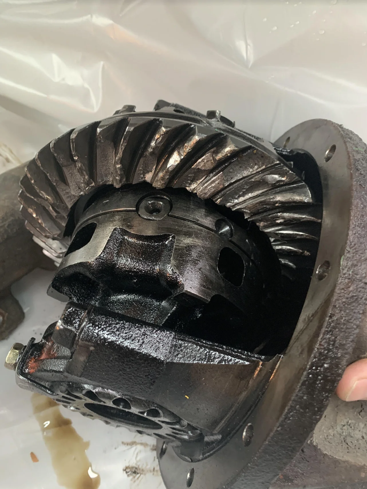

Figure I'd start it off right on here with a damage report update.
Below is an image of my blown rear diff in all it's glory!
This is what a blown rear diff looks like after driving a mile or two out of a trail on it, it sounded about as pretty as it looks!

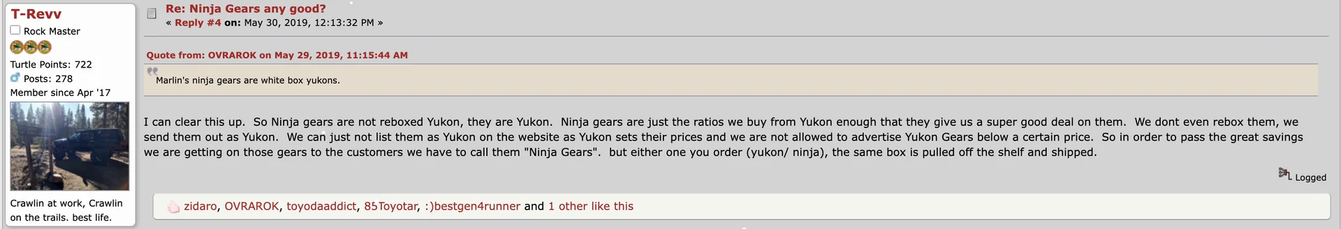

After speaking with @Rics4rnr about Ninja gears I did some research and decided to give Marlin Crawler a call to gain some clarity. As it turns out, Ninja gears are actually just Yukon gears sold under the MC in house brand name Ninja and they are used standard for all their diff rebuilds. Seems that in order to offer competitive pricing, they get a bulk discount from Yukon directly which allows them sell the gears for a lower MSRP than Yukon does, but because they are the exact same product just sold at a cheaper price, so they have to re brand them "Ninja Gears".
I have included a comment from MC below which I found on their forum.

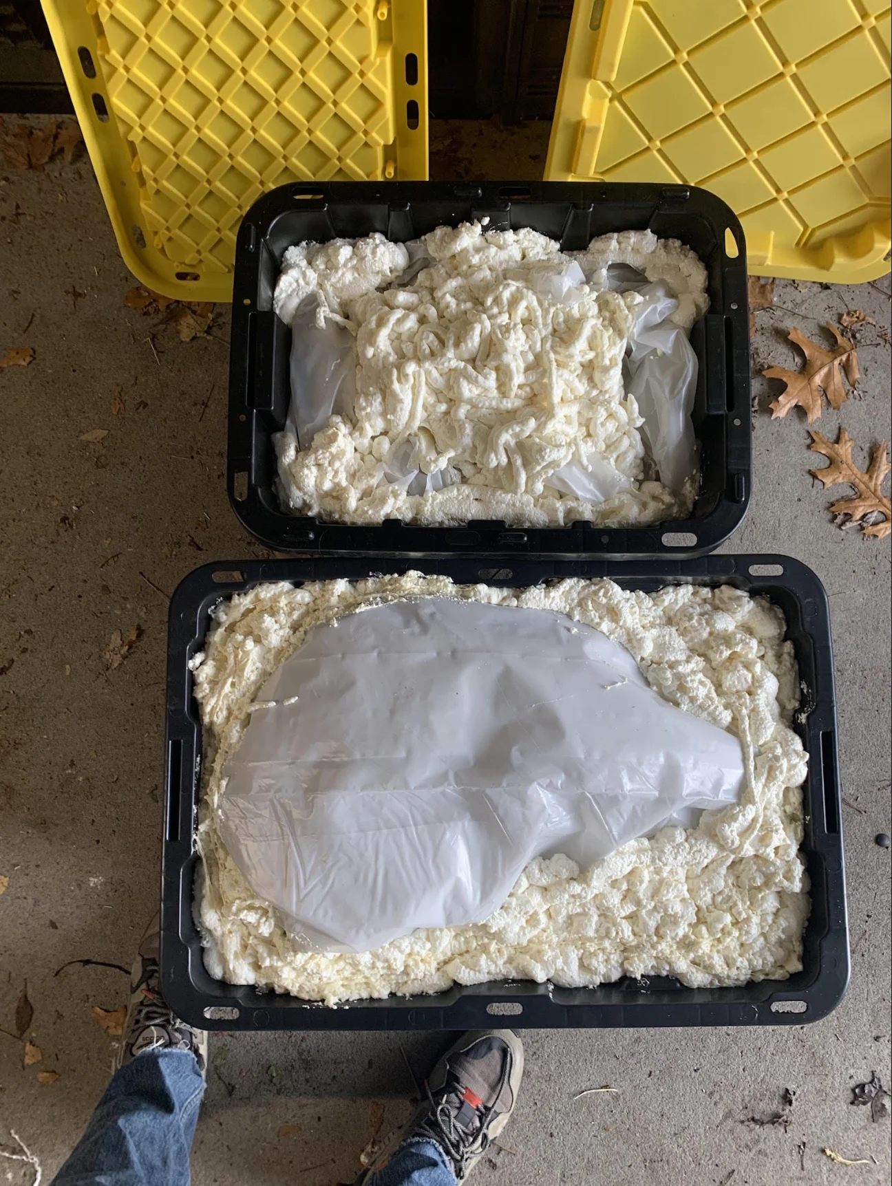

For those of you who are curious, it cost $357 to ship both diffs from Stony Brook, NY to Marlin Crawler in Fresno, CA via UPS - 158 lbs combined shipping weight. They took about 5-8 days to get there and arrived on different dates. I received a 5% discount from UPS for being a AAA member, so AAA for the win, again!
They were shipped using a HDX storage totes - 12 gal (rear, 67 lbs) and a 14 gal (front, 91 lbs, tight squeeze but it fit!). I padded the bottom w/ a furniture blanket for cushion, then wrapped them in a towel and plastic painters tarp. I then filled in all the gaps with expandable spray foam, which seemed to do the trick nicely (thanks youtube). I should have bought 6 cans but 4 was just enough. I then zipped tied the covers on, applied a shipping label on top and sent them out just like that.
Image below of what they looked like before the lids were secured.
Gnarly! But I feel you pain.
It was about 6 years ago, I had just after transferring all the good off road bits except for my rear lower trailing arms that I was waiting for a rebuild kit for the joints. Friends want to go wheeling and I said, what the heck let's go.
I believe it was trail 11 on the west side, I was getting hung up in a spot. I gave it my good ol 'send it', but I sent her to hard and the lower link landed on a rock and folded in half. While this wouldn't be an issue, I had the rear locker locked and spinning the tires at a good speed. when the link bent it pinned my right rear tire into the body of the truck and instantly locked up the rear. The weakest link for me ended up being a sheared off the pinion flange.
It gets better, every time. I pulled forward the pinion gear would drop into the diff and lock the rear end. I had to drive out from the bottom of the west side of the park to the staging area onto a trailer in reverse. Ooof, thankfully it was a nice day and I was able to roll down the back window to see a little better.
