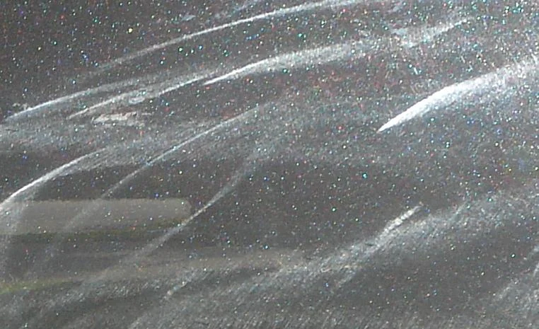

Is there an easier way to size down a picture for posting? Here is a small area of the FJ paint after first buffing.

The swirl marks do not automatically mean that an orbital buffer was used, nor does it mean that a rotary was used at too high of an RPM. Many things could have caused this, including debris during washing, etc.
Almost any scratch can be entirely buffed out if it can not be felt when running a fingernail over it. Color does not matter. As mentioned, darker colors are the most challenging to maintain. I recently took an extremely damaged paint job on a Land Rover (dark blue) to a point where no scratches could be seen in the bright sun.
To remove surface scratches, swirl marks, and spider webbing it takes a multiple step process, time and patience. Typically a compound, then swirl mark remover, then polish, then wax. The compound type (ie. medium cut) is dependent on the severity of the imperfections. For dark cars, a dark color swirl remover is used. A rotary buffer is the tool to be used and can easily be handled without any paint damage by simply setting at the correct RPM as speced by the manfacturer.
