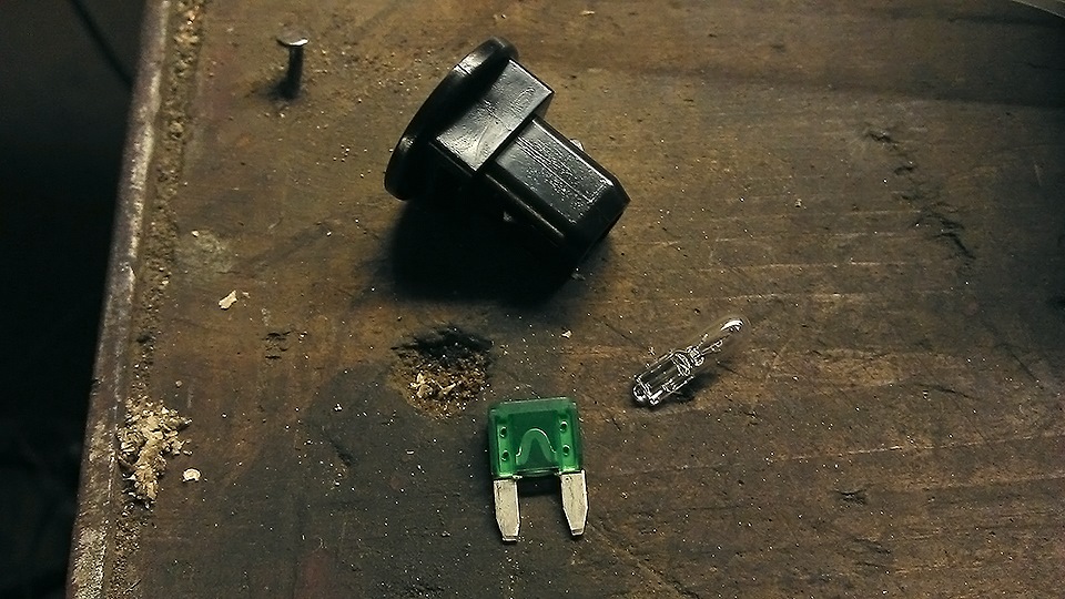

Hi all,
Reviving an old thread. I just pulled off my dead pedal and broke off the long square-section posts. The small clips that attach to the studs are actually threaded. They snap very securely into the long posts. I don't know if the can be snapped into the pedal first, then push the pedal into place. My guess is that they wouldn't seat on the studs completely. The snaps into the pedal are so secure that I also don't see how the pedal could be pulled off without breaking. My plan is to epoxy the posts on, out silicone grease on the spring clips to dead pedal area, screw one the clips to the post, then the install the pedal. I'm still convinced it will break on removal. I'll update when I do it.

Hi all,
Best,
ChapmanView attachment 4060758
